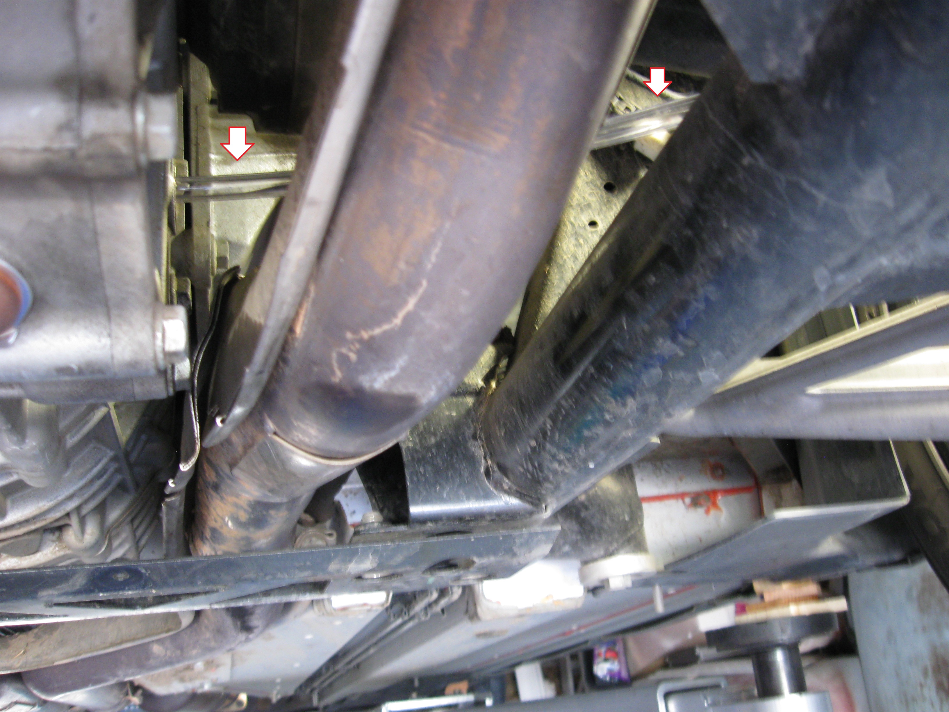

The single red circle on the bottom of the transaxle is the 14mm hex bit drain plug. The double red circle on the side of the transaxle is the 22mm socket fill plug.

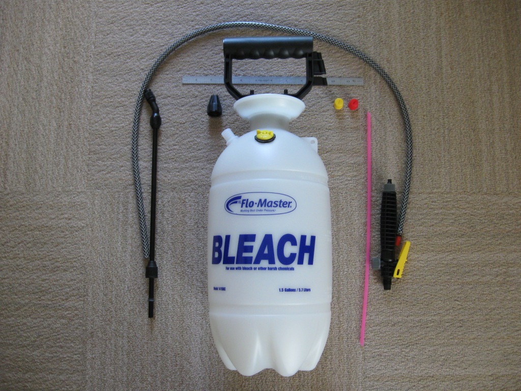

Low cost pressure feeder for transaxle lube
In the midst of changing the lube on my 07 Vantage transaxle this weekend, I was faced with the problem of how to get the new oil into the transaxle. I resurrected my old suction gun and began cleaning it up to use to pump the new fluid; I was dreading using it as I most likely would have oil up to my elbows by the time I was done. Some time ago, I stumbled across a YouTube video of how to make a homemade brake pressure bleeder, and thought why not try and use a variation of that idea which would be suitable for use with the heavier weight transaxle lube.
A quick search on-line and a visit to the nearby “big box” home improvement store confirmed the availability of a garden sprayer that I thought would work. See the second photo. It was imperative that the sprayer had a pressure relief valve, as I wasn’t planning on using a shut-off valve. I thought the Viton seals included in the “bleach” sprayer would be more suitable for my intended use. The small pink feed tube, approximately 1/8” ID obviously won’t work well with the heavier weight oil. Recycle that and everything else except the black compression fitting.
Once I knew what the tank fittings were like, I made a second trip to my local “boutique” hardware store which resulted in the purchase of 6 feet of 3/8” OD by 1/4” ID clear plastic tubing ($0.24/ft.) and an “O” ring with an ID of 3/8” and a thickness diameter of 3/32” ($0.40): these sizes fit the tank opening and the supplied compression fitting well. See the third and fourth photos.
On my lift, the Vantage wheels are about 28” off of the garage floor, and the bottom of the frame members has about 38” of clearance. See the fifth photo for the pressure feeder in place.
My 6’ hose choice for my particular installation was a little long. I routed it over the cold exhaust and the routing can be seen in the first photo (This photo ended up as the first -it should be the fifth-I don't know how that happened???-and I can't seem to change it).
I didn’t want to contaminate the air pump, so I only put a quart and a half of oil in the container. A couple of dozen strokes on the air pump resulted in the oil flowing nicely-it took about 5 minutes (on a 70° F day) to transfer the fluid. I repeated the sequence twice more-on the final filling, it was easy to stop the flow by using the pressure relief valve, when the oil just began flowing out of the filler hole.
Thanks to Richard for the original posting and his detailed information. A 9” extension on a 22 mm socket worked well for me on the fill plug. You’ll also need two copper sealing washers: AM Part No. 4G43-27-10245 ($3.48 each from my local dealer).
The entire pump assembly with the modifications ran me under $20 plus tax. It certainly made easy work of a potentially messy job.

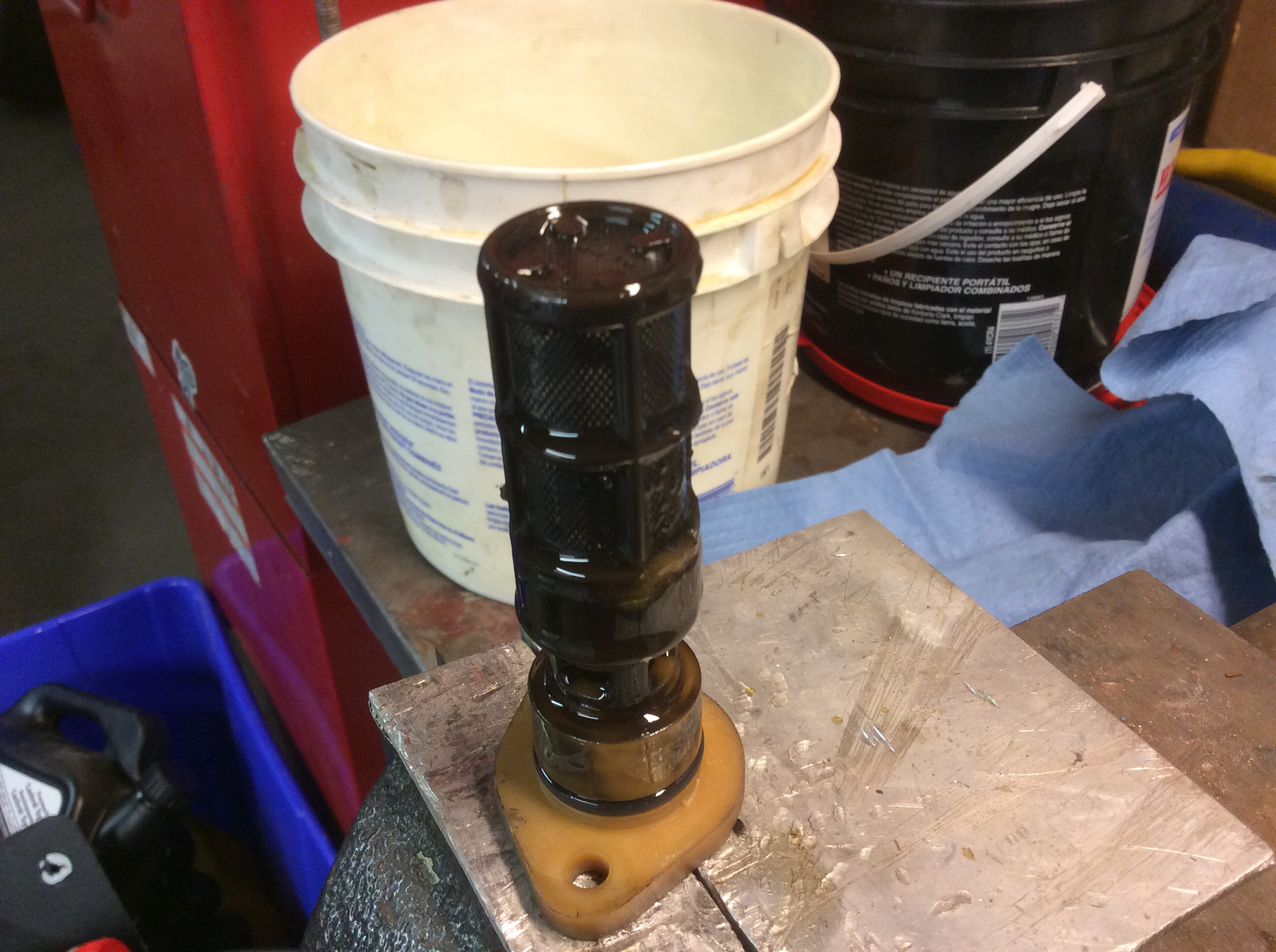

Old Nov 22, 2015 | 03:56 PM
Vantagelvr's Avatar
Joined: Nov 2014
Posts: 503
From: Ottawa Canada
Rep Power: 33
Vantagelvr is infamous around these partsVantagelvr is infamous around these parts
Transaxle screen
As you can see I also did an oil change as its time for the Vantage to take its winters nap , so now it's cleaning and detailing before covering it up till spring .

I'm 99% certain this is the first transaxle oil change on my car based on the tell tale mark on the drain plug . It was in the exact position . So whatever was in the transaxle when it was new it what it was .
I was suprised how thin the oil was , I expected it to be thicker , the 85/140 I put in my Healeys rear axle is like molasses .(I realize the difference is its a differential not a transaxle)
I did a lot of reading and research before buying my car so I knew about the clutch issues and the stiff cold gear changes .
I'm firm but careful with my gear changes between 1st to 2nd and 2nd to 3rd when the car is cold . I also don't do clutch dumping starts and when reversing out of my garage I merely use reverse to get the car moving then coast down my slightly downhill driveway onto the road .
Once the car is warm I don't find any issues with shifting , it is a little clunky which I think is due to all the linkages involved between the stick and the gearbox but I've never missed a shift or crunched a gear and I'm sure if I was abusing the gearbox the magnetic plug would have told me so .
I took the car out for a drive after the oil changes and didn't notice any difference . I still had to be firm but careful with the gears when the car was cold .once everything warmed up I didn't notice any difference .
Personally I think it's just the nature of the beast and some drivers are not patient enough when the cars are cold .
Just like us when it's cold we don't like to get moving in the morning , we need a little coaxing with coffee/tea and some warm clothes before we get our second wind .
