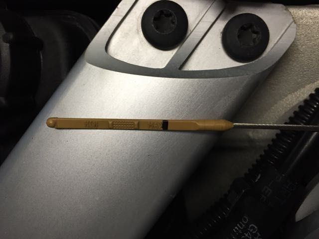

Just as an update, just serviced the car and added the extra oil amount as per the AM Service Bulletin (BTW AM, 11.4 L is not 12.96 US Quarts, its 12.05). I have marked my old did stick and the level is halfway between the max mark and the upper indent on the stick.
Mark showing correct oil level (11.04l) on older dipstick

I thought the dip stick update was a recall and was provided for free?
Old Jan 12, 2016 | 05:06 PM
ajmevans's Avatar
Joined: Nov 2015
Posts: 13
From: PA & FL, USA & England
ajmevans is infamous around these parts
Yes, correct it was a recall, but amazing how many pre-08 DB9's did not have it done, (my 05 has been religiously serviced by a top of the line AM dealer every year without fail, yet never had the dip stick changed) you could be running with not enough oil, this is just a home fix for those out there wondering....and also a correction to the AM Service Bulletin that you DO NOT put 13 quarts in you DB9
