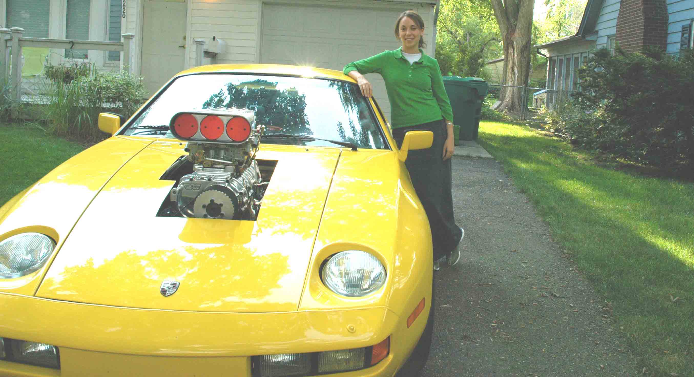

An alternate engine for your DB9
If they can't fix your engine, a much cheaper option would be an aluminum Chevy or Ford Motor with a 6-71 Blower fitted - we did a cheap (less than $10K) 600HP, 600lb trq at the crank dyno'd on our Porsche. Sledge hammer power (torque comes on instantly), insane look. Doing so would likely banish you from this forum. I'll get death threats for just suggesting this.

oh no doubt. I already decided if the engine goes an lsx will go in. An ls7 with 500 n/a hp would be nice.
