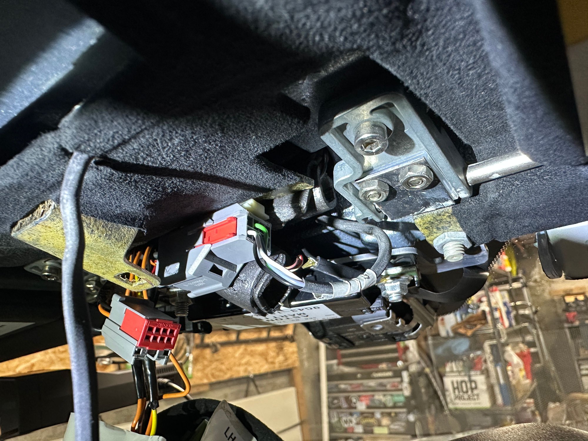

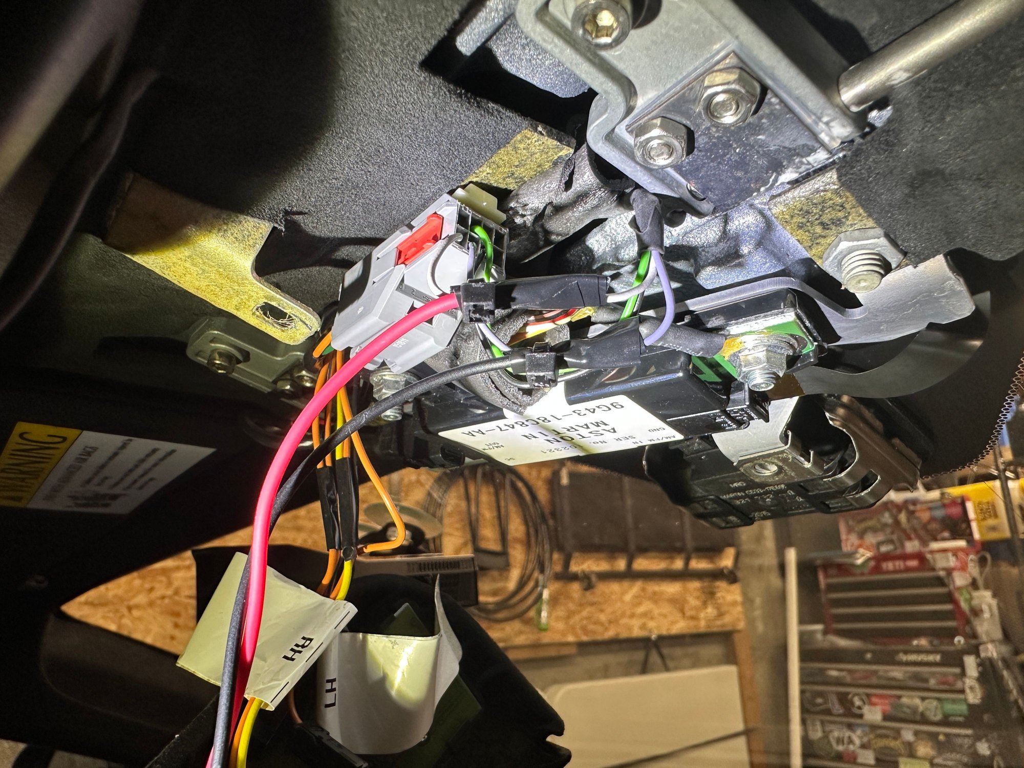

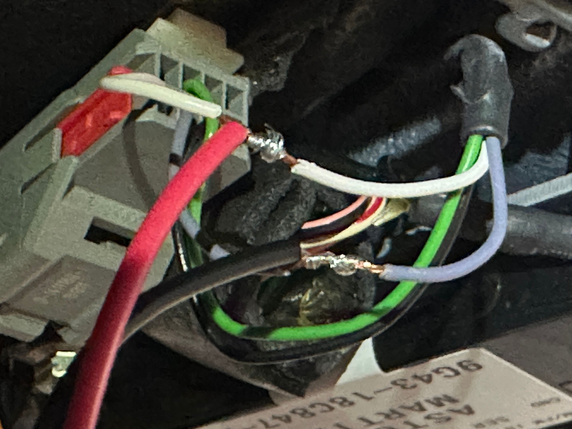

@embdenb Thanks for your write up. I hardwired my Uniden R8 to the mirror with that as a reference. I found that the none of the 3 different styles of mirror tap cable prongs were able to fit in behind the wiring harness. Either they were too big or were too loose after I shaved down the prongs trying to get them sandwiched next to the existing harness wires. So, I ended up stripping the mirror wires and soldering inside the car. In my 2016, it seemed impossible to remove the wire harness and solder at the work bench, which would have been much much easier. After soldering, I taped and zip-tied for protection. One thing I was initially going to try was wiring the radar detector to the passenger map light so I could turn it on and off with the console button, but the map light only registered 7.5 volts and was not enough to power the detector. If I remember correctly, the mirror was putting out around 11.25 volts and works like a charm. The only insignificant/odd thing is that the mirror apparently turns off in reverse, so the detector briefly shuts off when backing up.
