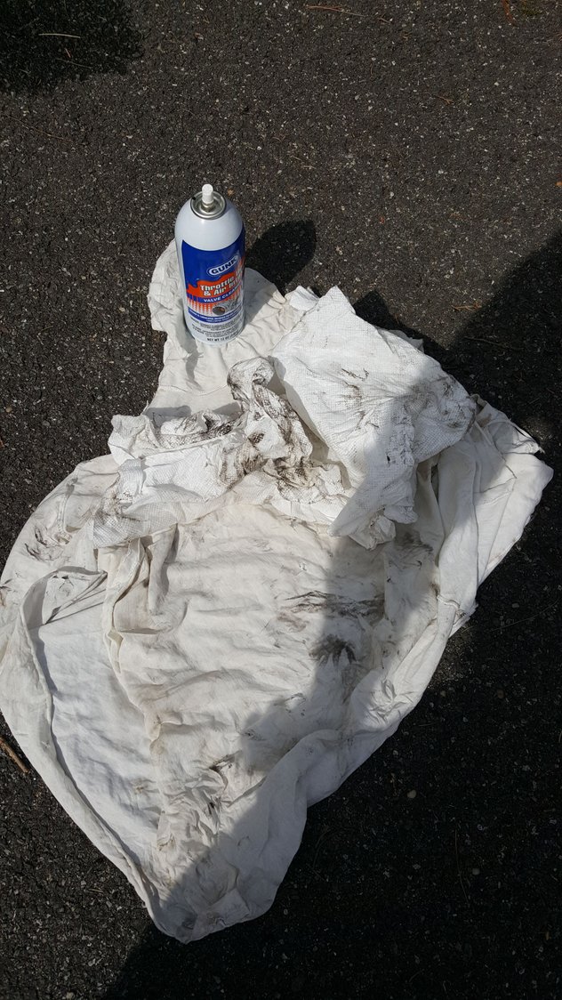

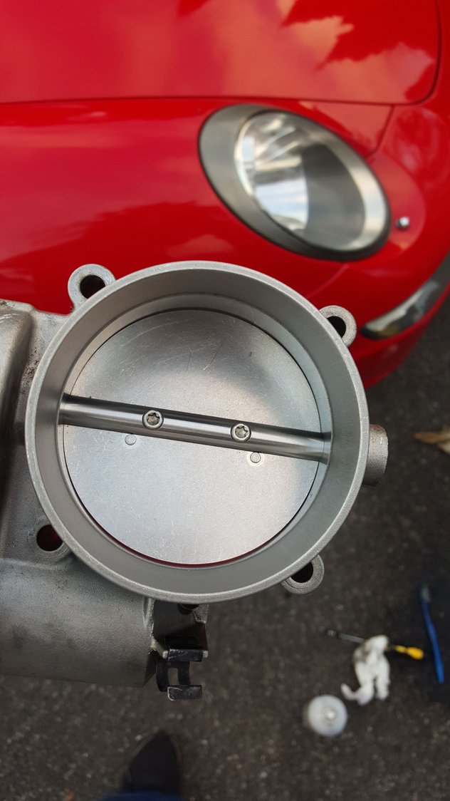

Furthermore, I decided to take the throttle body apart and do the job right. I disconnected the TB from the manifold and cleaned the entire thing top to bottom. I also took apart the electrical connections and cleaned them with electrical cleaner. There was some oil on the electrical components.
I did all of this with the battery disconnected then re-connected everything after cleaning. As soon as I started driving the car it felt more responsive. No more feelings of restricted power. I took it for a spirited drive for about 30 minutes without any issues. (previously the car was stalling within minutes)
After about 40 minutes of driving the check engine light came on with an orange triangle on the right. The car was still driving fine and never went into restricted/limp mode as it was before, nor did it stall.
