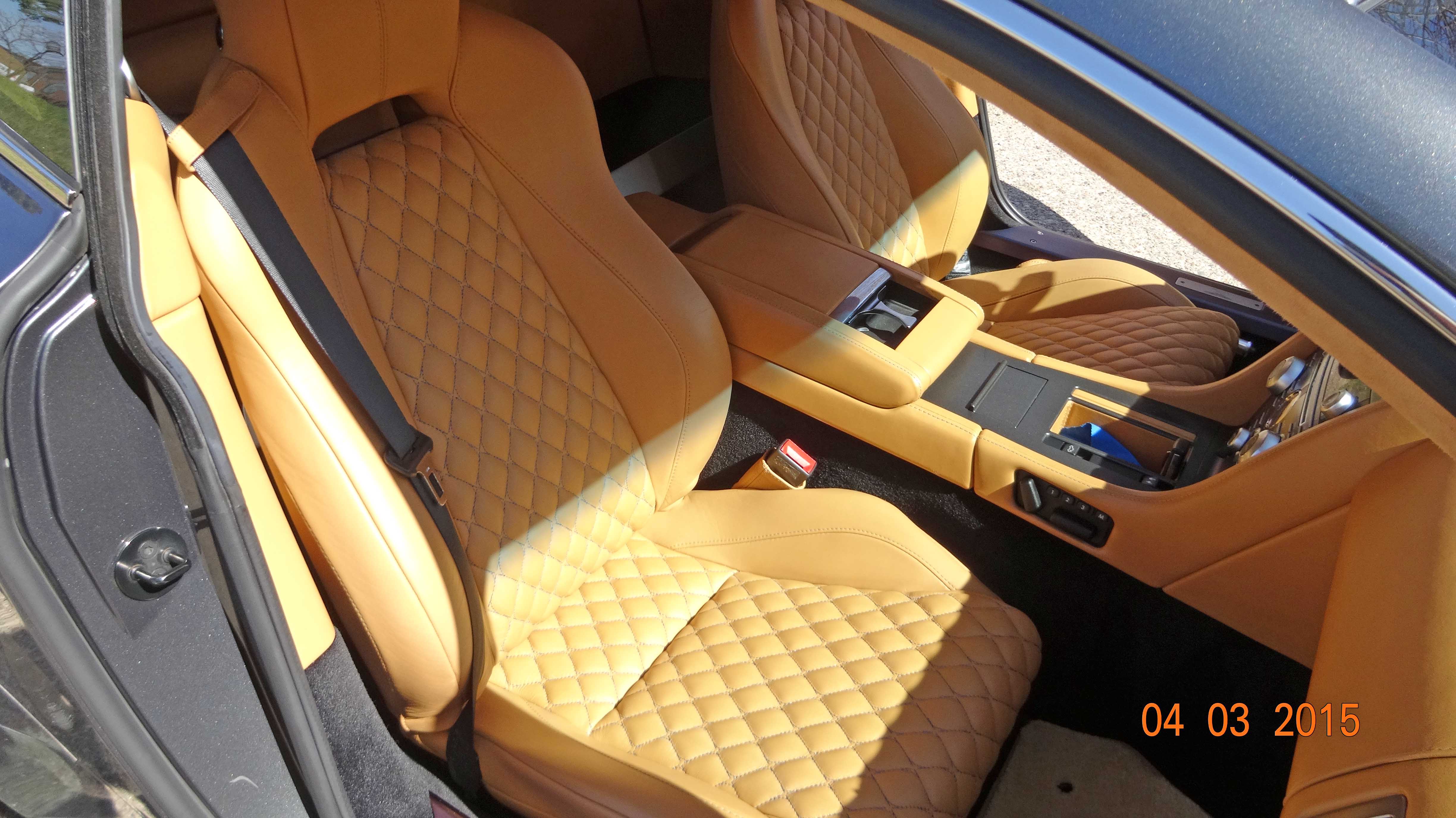

Hints - suggestions
A few things you might consider:
The picture below is of the seats I had done using Aston's modern stitching pattern but with larger diamonds and internal to the seat. I wanted actual Aston leather, but the dealer said their supplier could match the color and their leather would wear better - while it did match for a while it quickly faded to another hue and after just a month showed signs of premature wear. I traded the car for a 15 GT, but had I kept it they would have refinished the leather. So be aware and keep with Aston's supplier.

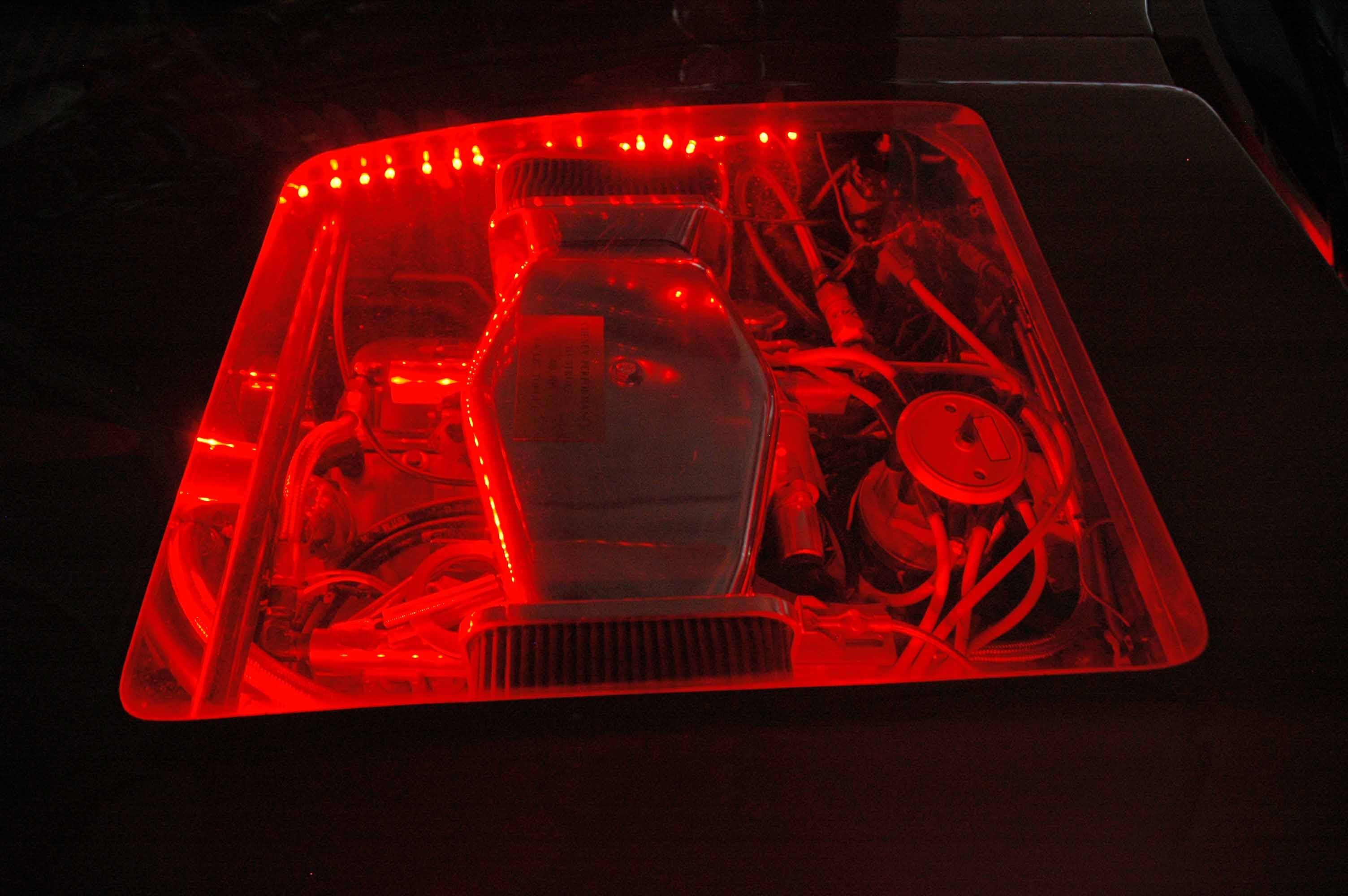

The next is of a clear paneled hood I had done with back lighting to show off the detailed Chevy 383. Similar to that which you did elsewhere.

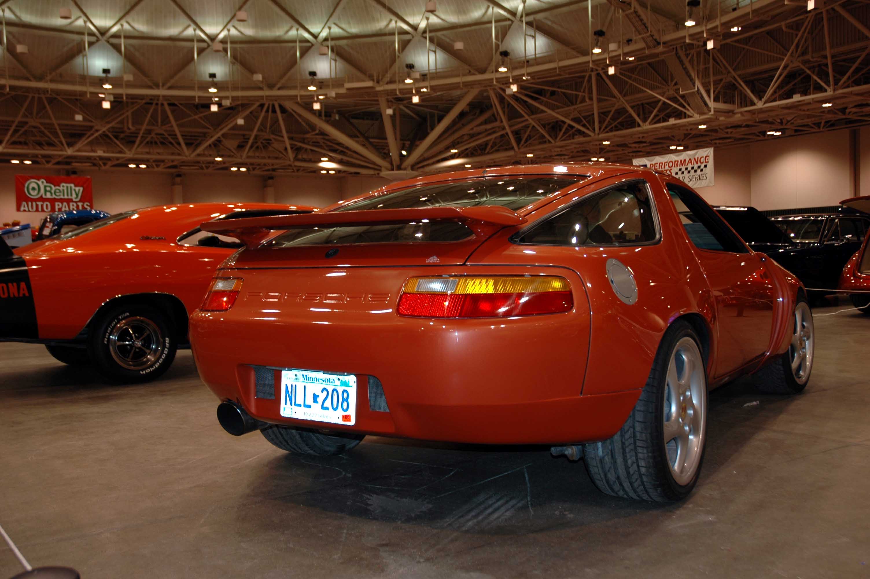

I also had gills made (the 928's are nicknamed the shark) and had a rear view camera placed in the upper portion of the back gill on both sides... with screens installed into the dash panel. Color was the BMW Mini Orange.
Lastly I did not want a liberty walk look and instead fender widening that would look mild and factory. They actually did about 20 radial cuts in the fender, pulled it out about 2 inches, then filled and reshaped to get the car wider but in a very stealth way. The fuel cap is a Mustang part. The car won People's Choice Award at a Car Craft Summer National.
