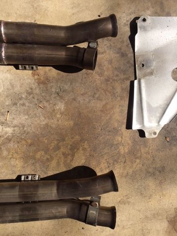

I cannot get the VAP x-pipe tubes to go into the rear muffler tubes. Advice please? The drivers side is where I'm having the main problem. It just won't seem to fit in. (that's what she said!)

Sometimes the old exhaust clamp can deform the inside diameter of the muffler pipe just enough to prevent the x pipe tube from going in. There are devices that will open up the pipe diameter. Try the local automotive part houses, they will sometimes rent these tools.

Yep.. ^^ what he said. "Advance Auto parts" or "O'Reilly auto parts" will loan you a "tail pipe expander" tool for nothing typically. It's a devise used to expand the inside diameter of exhaust pipes. You just insert and crank on the nut to expand the tubing a bit. It'll make a deformed piece of tubing nice and round again and give you a little bit more slack and clearance to more easily slide the sleeved pieces together.

Thank you guys I really appreciate it. I was working on that for about two hours yesterday getting absolutely nowhere. And I have to tell you, one of my least favorite places to be is under a car on jack stands.

Why is one side shorter on the new xpipe vs the old original center section? Look at the end that goes into the where the secondary cats connect.

Stuart solved this one for me. The end piece on the original part comes out and is installed on the xpipe. So simple!
