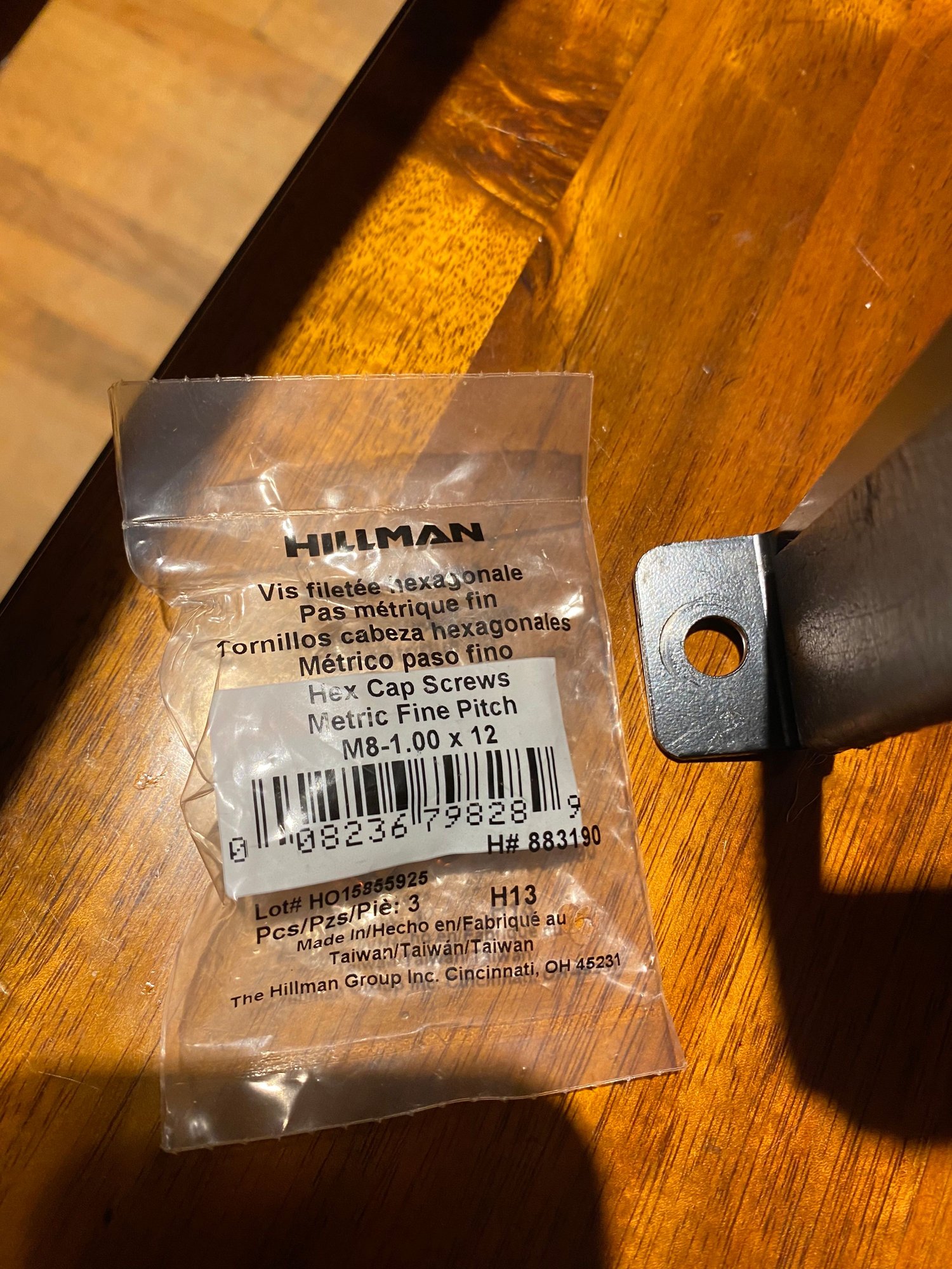

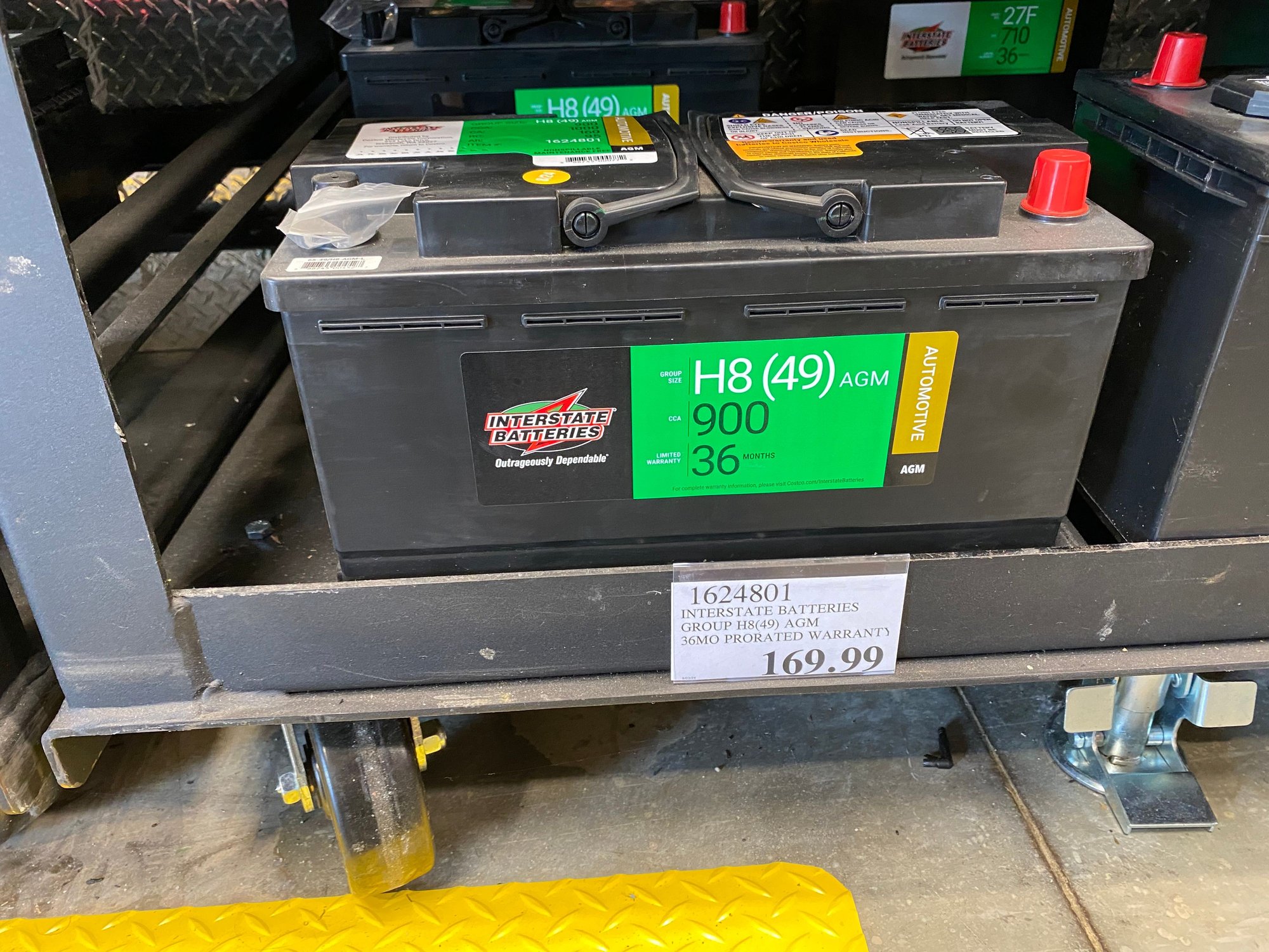

Another battery bracket data point, 2014 V8 roadster......With my current battery at the 5-year mark, and getting the occasional random code, I picked up a replacement jumbo-size Interstate AGM at Costco. I had faced the center bracket issue when I replaced the OEM battery 5 years ago and left the "too small" bracket off, figuring that the sliding brackets alone were quite adequate for non-track driving. Indeed I found the battery solidly in place after climbing through the interior (having the top down helped tremendously). I bought the old 7.5" tall bracket from my local dealer and discovered that all was well except the bolt hole on the back of the older bracket was too small for the bolt size needed for my 4.7 (the bolt opening behind the battery that looks to be drilled into a crossmember). Straight forward to run a slightly larger drill bit through the bracket hole to correctly size and the bracket then fits great, but don't be surprised.

Can't believe I've had my Vantage for over 7 years now. The car has been slow to crank for a couple months and decided to check it with a battery tester. Sure enough, it tested at a whopping 175 CCA. Voltage was still fine, but just not enough juice anymore. The battery has always been on a charger so they wear out no matter what you do. 7.5 years isn't too bad I guess. The Interstate batteries at Costco are still the best deal around. The price just went up to $180, but you can't beat that anywhere else.
