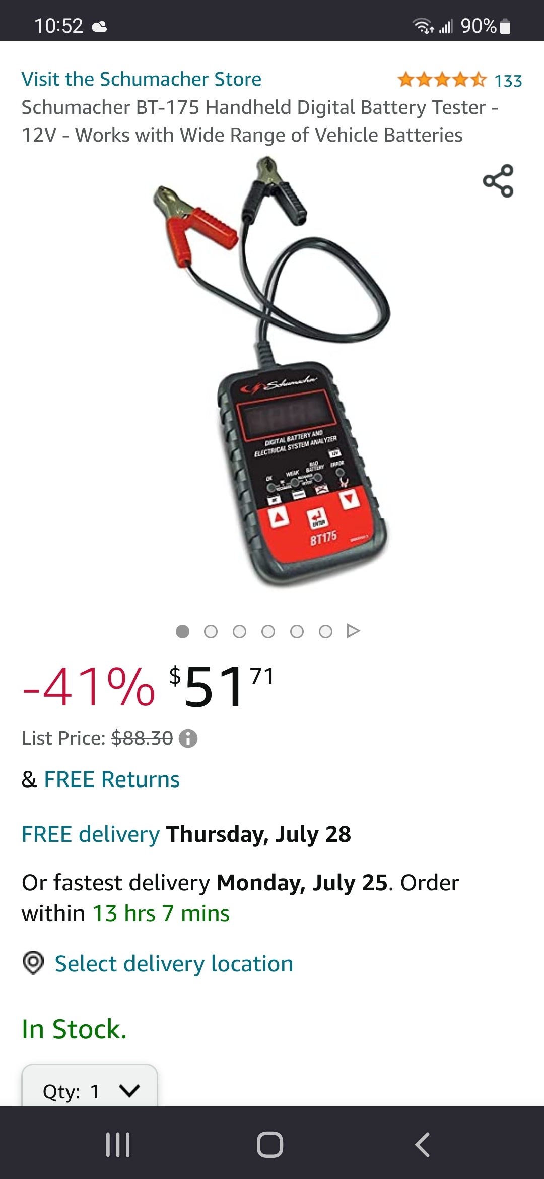

Invest in a battery tester, there are many on the market under $100. I find myself using it more often than I thought. Here's 1 example of a name brand unit that's very reasonable on sale.
