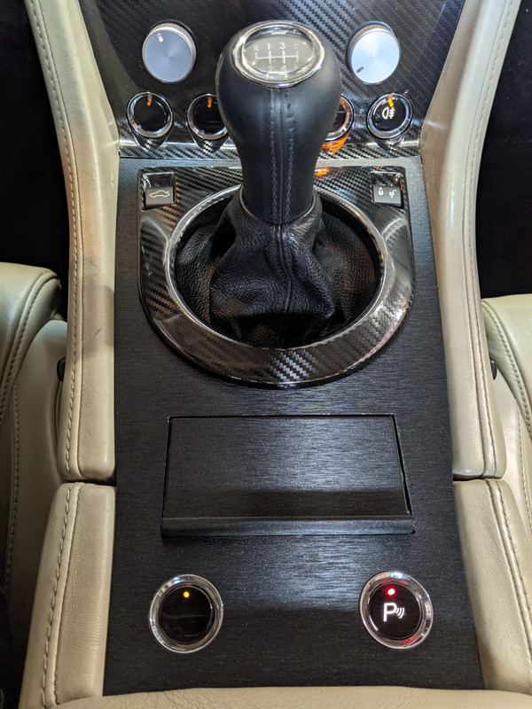

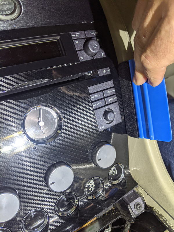

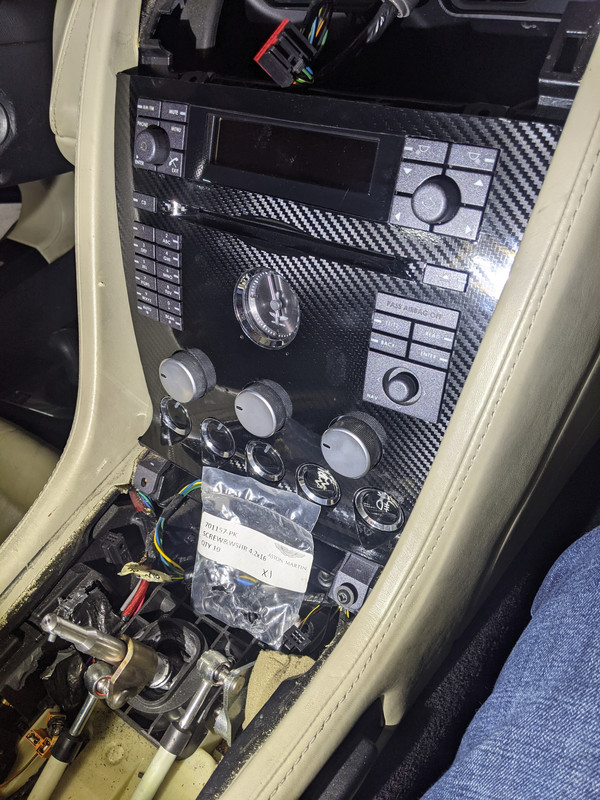

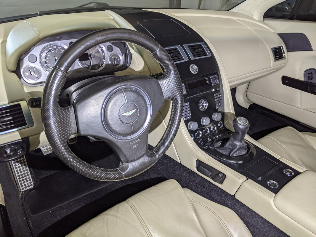

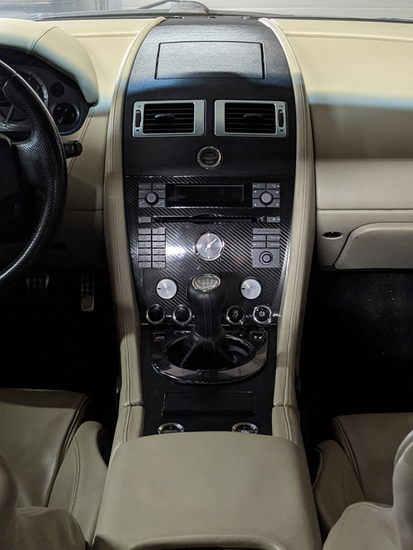

Post Waterfall and console reinstalled
Have to start with the control panel plugging everything in.
Order that worked for me was:
1) bottom 6 buttons in left to right order
2) Then work your way up (HVAC, Clock, Stereo)
4 screws hold it in and I touched up the vinyl where it meets the leather:
Next plugged in starter button and snapped in the waterfall.
Then the shifter console, clean leather, plug in switches, 12V plug and glass buttons, push and rotate shifter **** and install 2 screws at rear:
I'm actually surprised how good it looks:

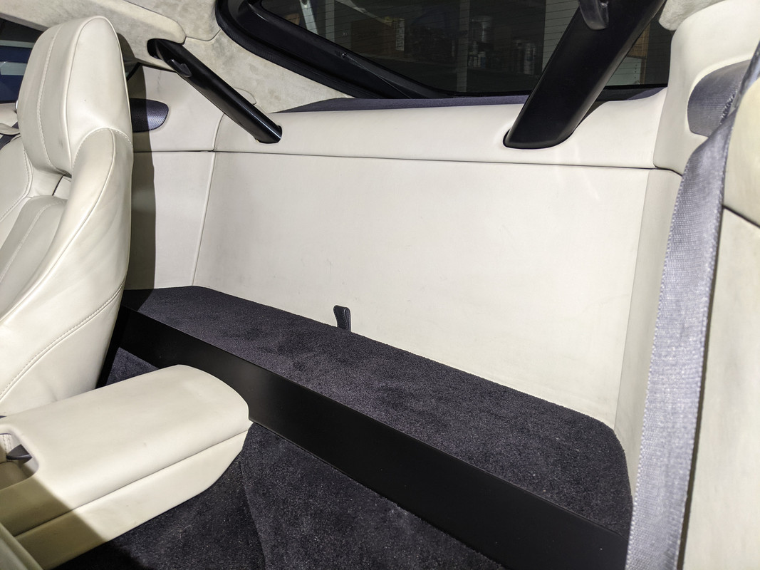

Finished off by installing cupholder armrest (1 screw) and parcel shelf with new black look:
No dash warnings so next up going to do a no fire starting process to build oil pressure after the oil change - getting closer!

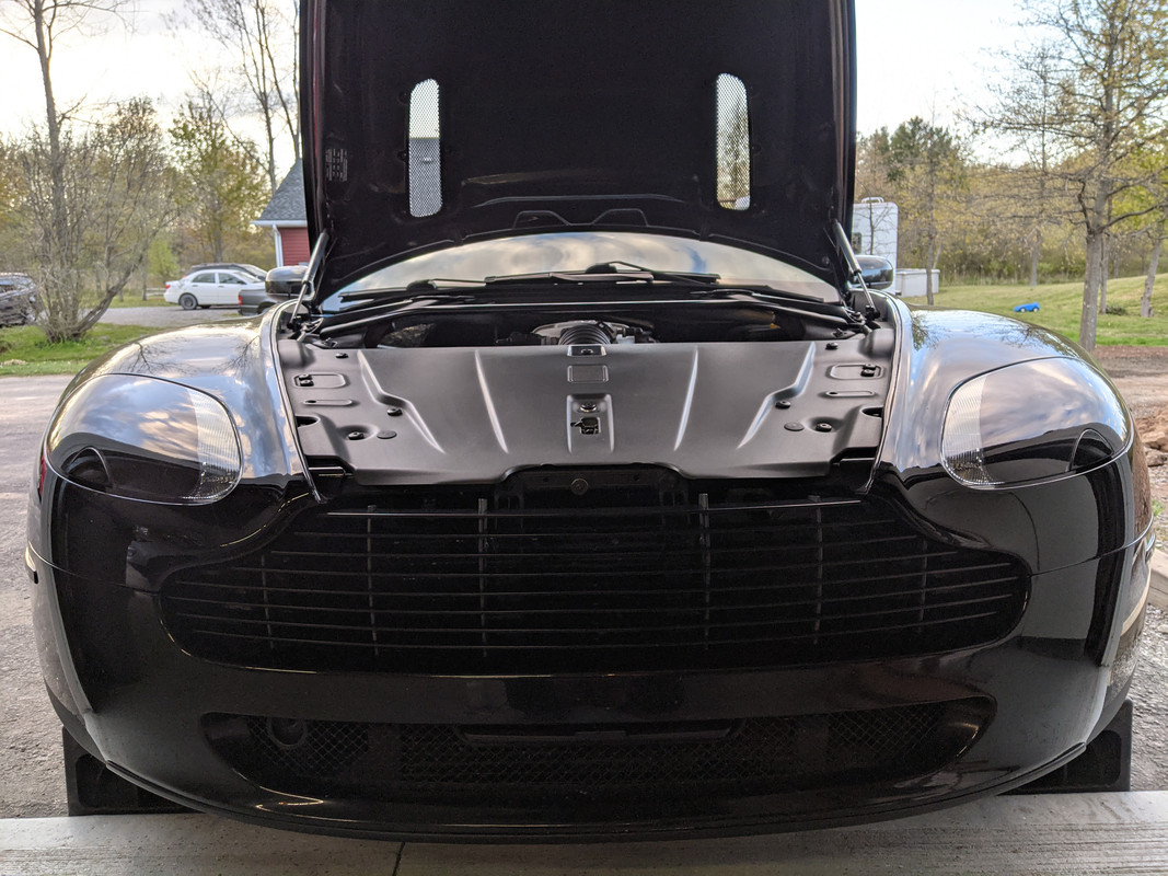

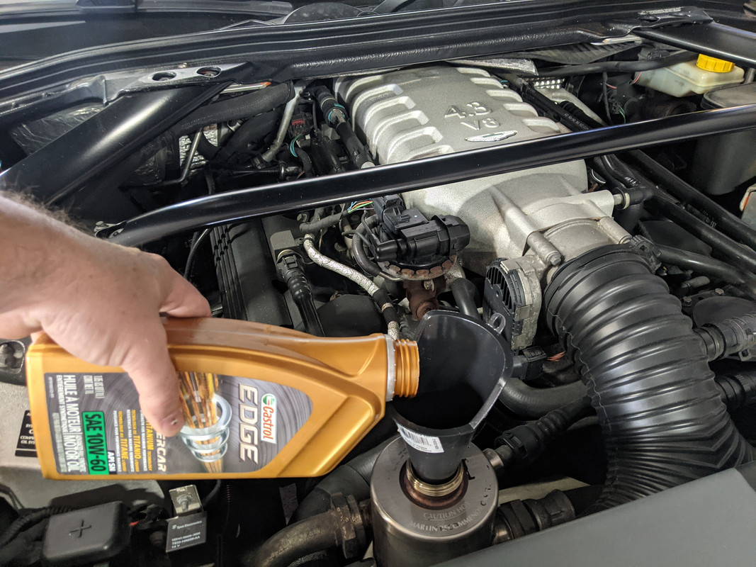

Followed steps to check my oil and topped up after oil and filter change:
Also happy to report my washer fluid system is working again including the headlight washer:

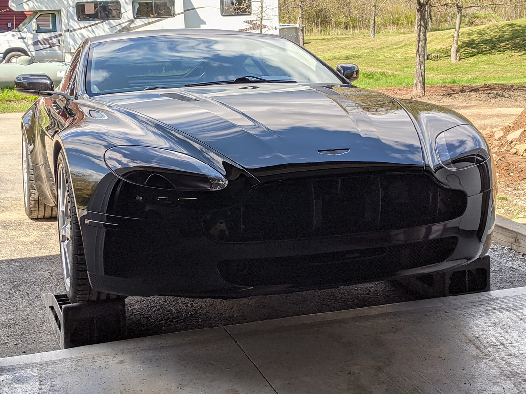

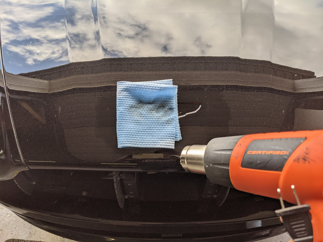

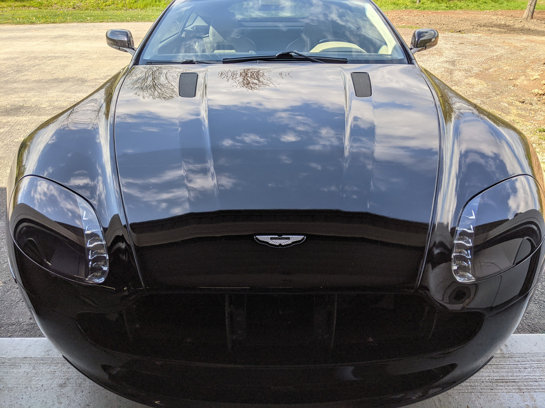

Gave it a much needed shower so I could work on installing the new badge emblems and front apron:

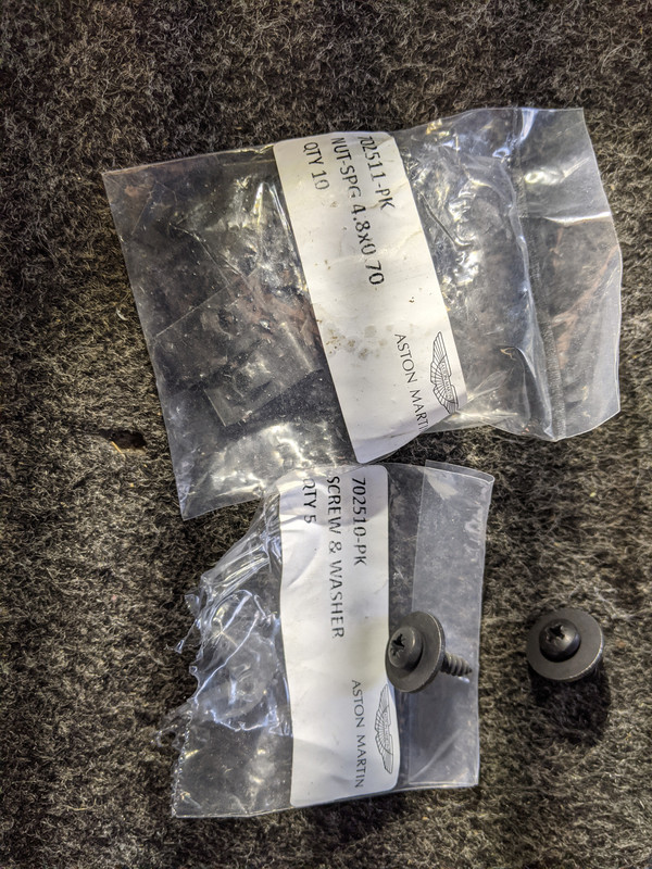

I recommend car ramps for this, made it easier to see versus using a stubby screwdriver:
I also recommend getting the new hardware when you change the front apron - I was missing a few screw clips.
Top Tip: use Goo Gone and a small amount of heat with a plastic scrapper to remove the old badge adhesive:
The new emblems are black instead of green (part of my black theme) and in much better cosmetic condition than the 14 year old originals (which I am keeping to install on my GTE race car hood):

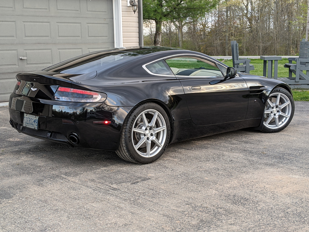

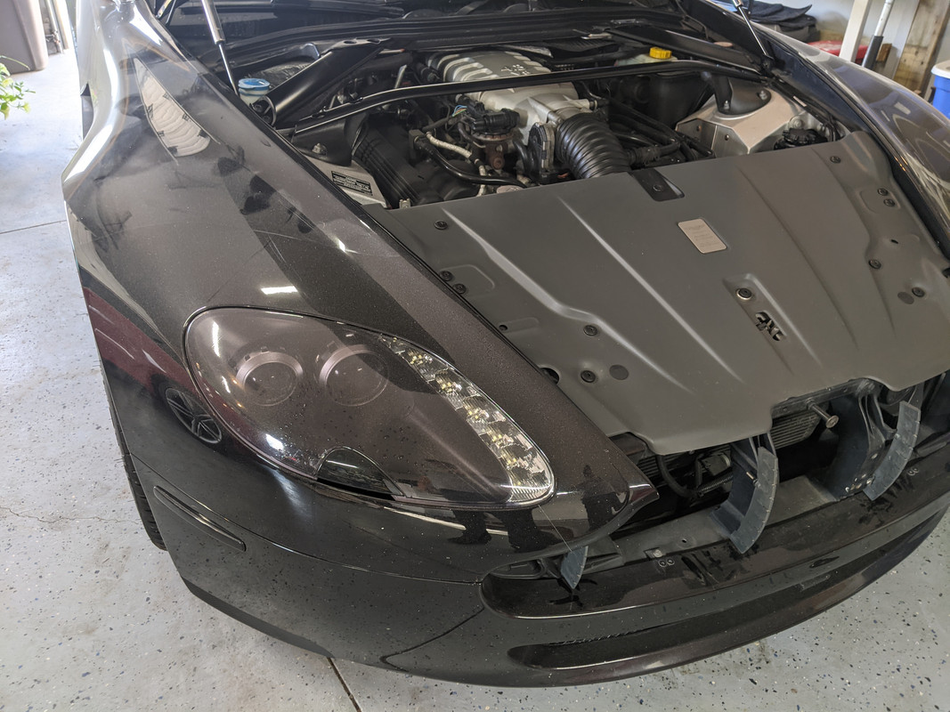

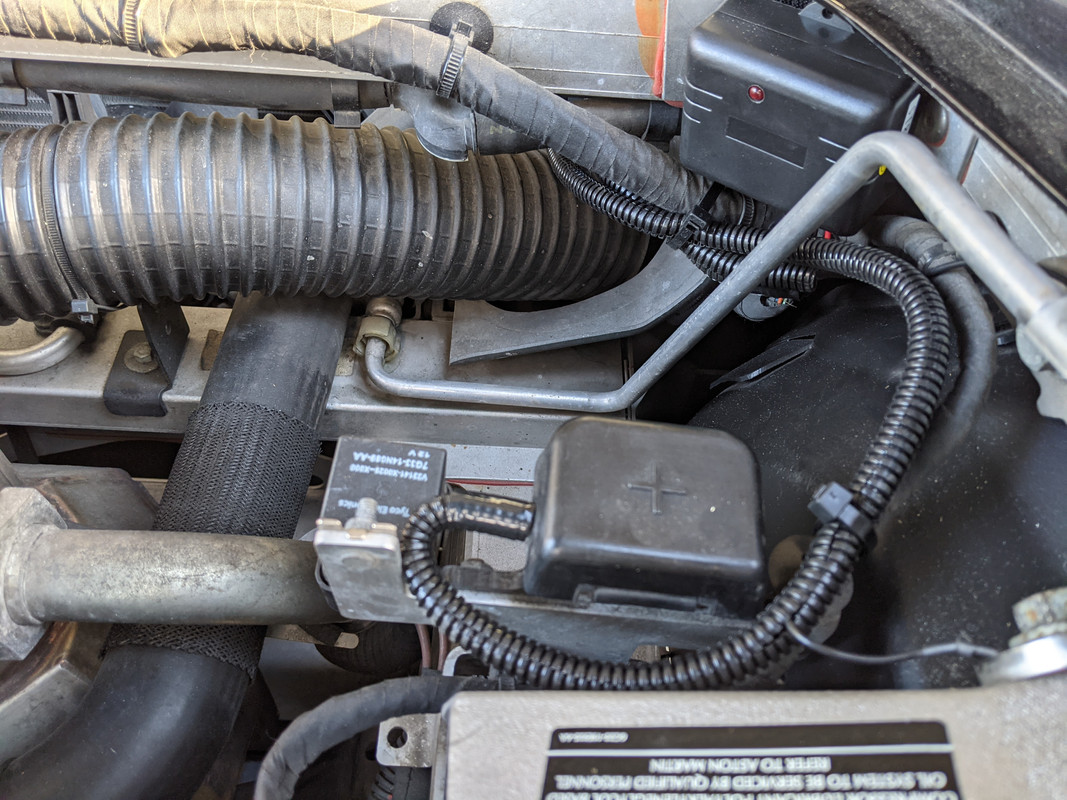

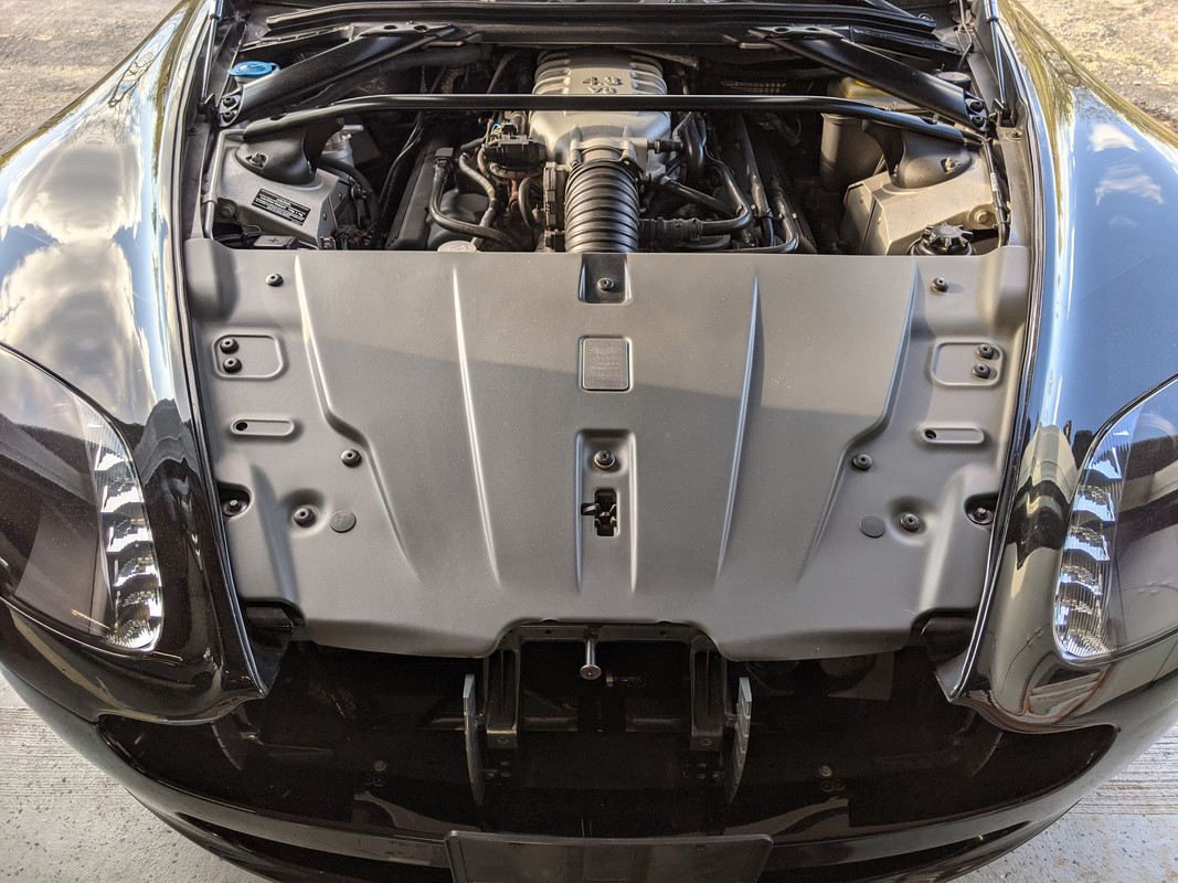

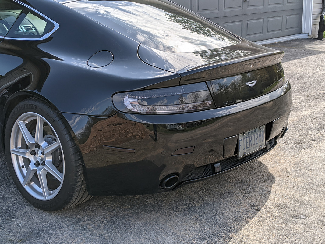

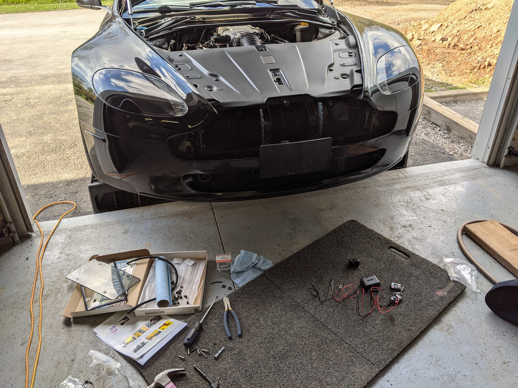

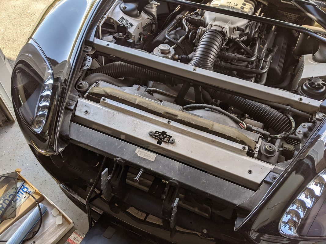

Cool Show n Go motorized license plate re/re
Almost 4 years to the day, the module crapped out so I just bought another kit and installed it - much faster this time
1) Remove grill and slam panel
2) Two self tapping 5/16 head screws hold the frame to the bottom of the front bumper
3) Velcro module to frame
4) Run power and ground wires in loom
5) Route motor wire past radiator to plate frame motor
6) Shoot a YouTube video of the operation
7) Reinstall slam panel and grille
Put extra key fob in glove box as a "Bond" button
Time for a beer, here are the pics:
BTW - FYI, I lost the centre upright for my front grille a couple years ago, but I thought it looked better without it so I didn't order another.
(No issues of loose grill bars since)
Time to go test out my now functional Traction Control OFF button.... 1 burnout, 1 burnout only please

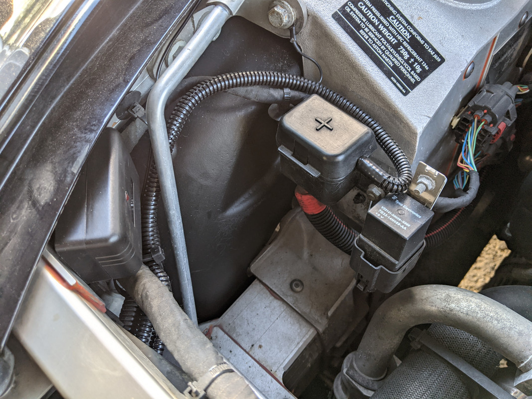

Post Checking in after the pandemic
Hi guys,
I haven't posted to the thread in quite some time, as there hasn't been much to report.

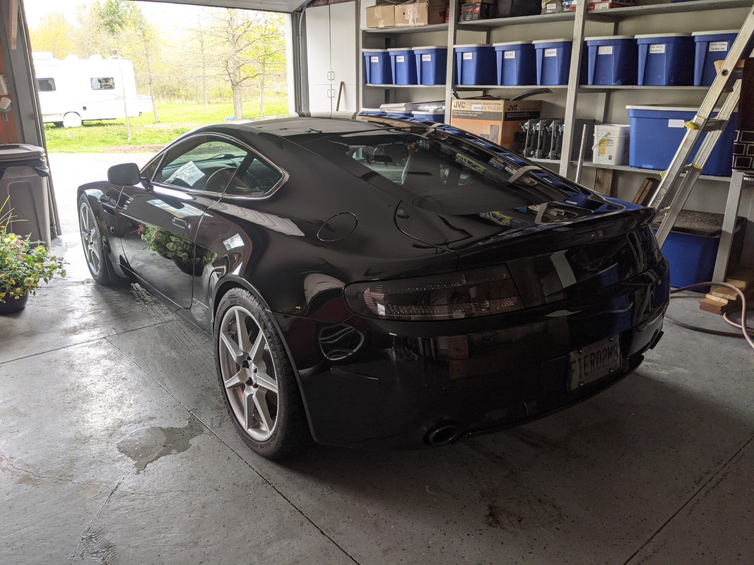

Vinyl wrap was installed on the rear of the decklid and the roof in satin black.

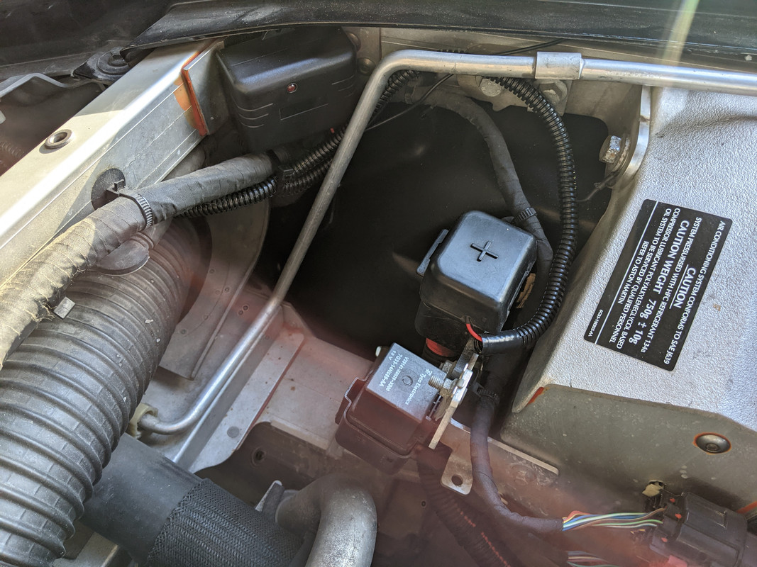

Yesterday I had to replace my battery as it would no longer hold a charge after 7 years.
I took some pics during the swap in case it helps anyone deciding whether to tackle it themselves or not.
After removing the screws for the top metal brace, you can pull the carpet forward to access the battery hold down hardware
On my car the hold down strap was a 10mm bolt and the screws for the clamp brackets were T30 Torx
Once you loosen the screws the 2 brackets slide out of the channel at the left end
This was the battery that was installed during the safety check and paid for by the previous owner in April 2017
Don't forget to hook up the vent tube - I transferred the 90 degree fitting from the old to new battery
I went with an AGM version this time with a higher CCA of 850 and a 5 year replacement warranty. Best of all in stock at the local parts store and relatively reasonably priced! The positive and negative cables require a 13mm wrench or socket

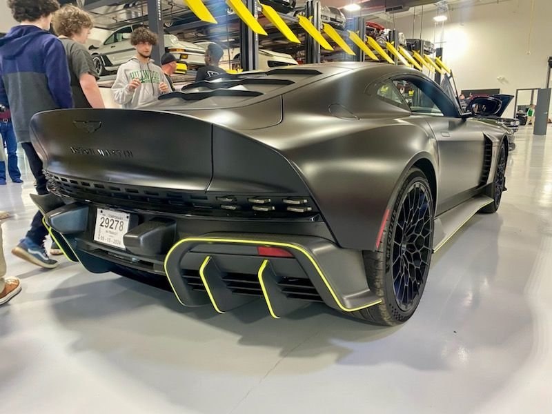

Time to update the thread from the summer's activities.
Trip to Nashville where Aston's are a more common sight
Loved the One-77
