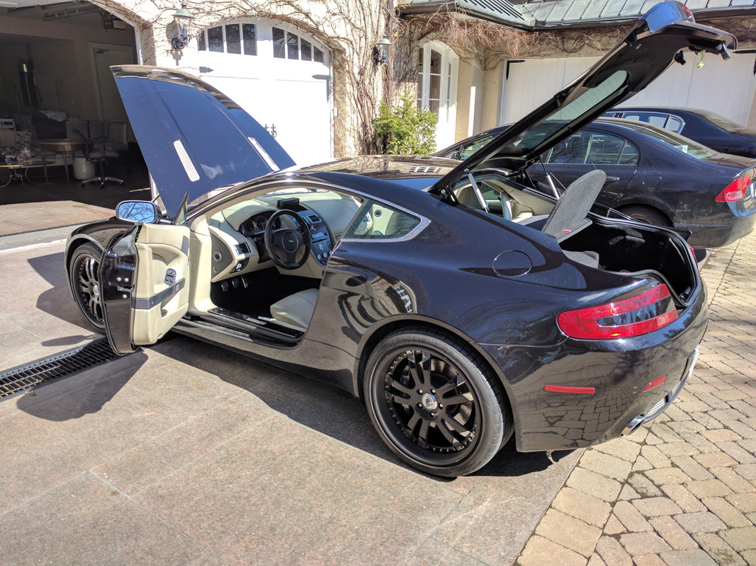

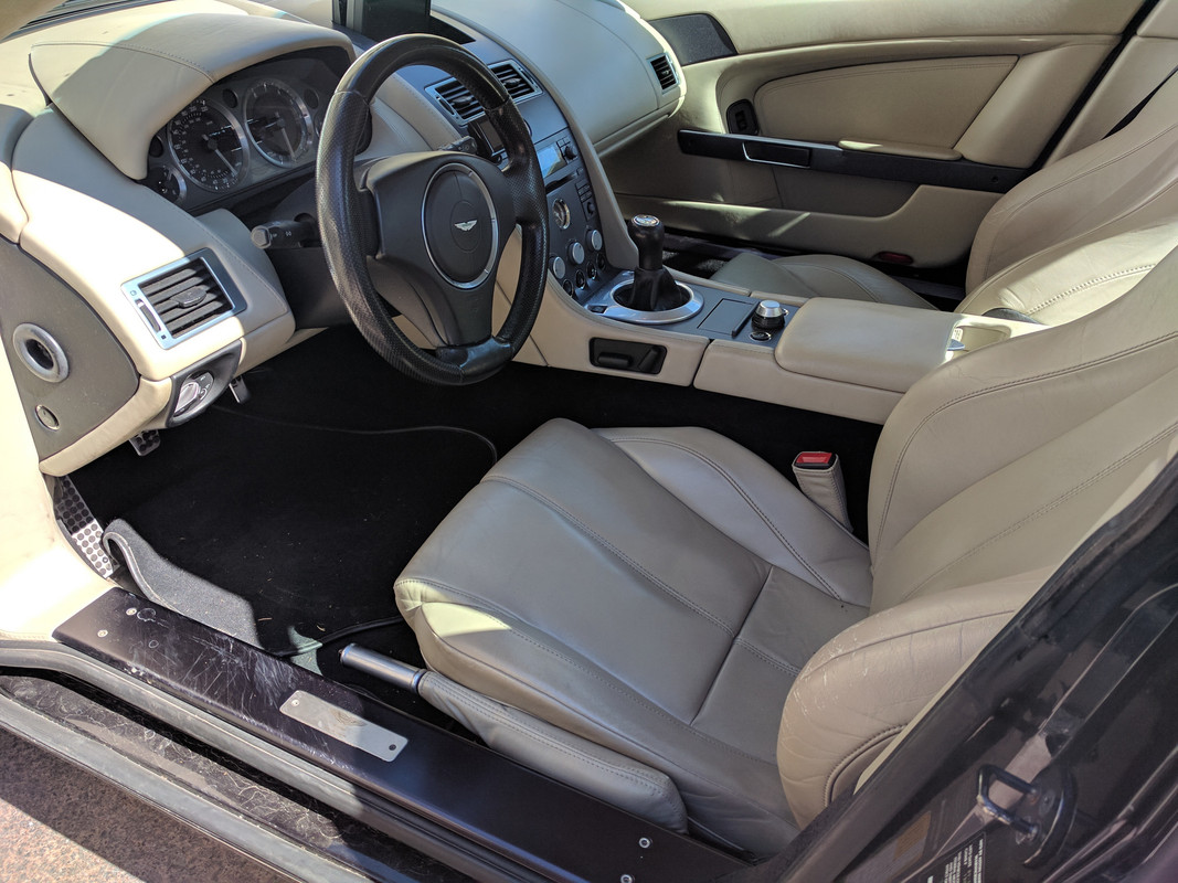

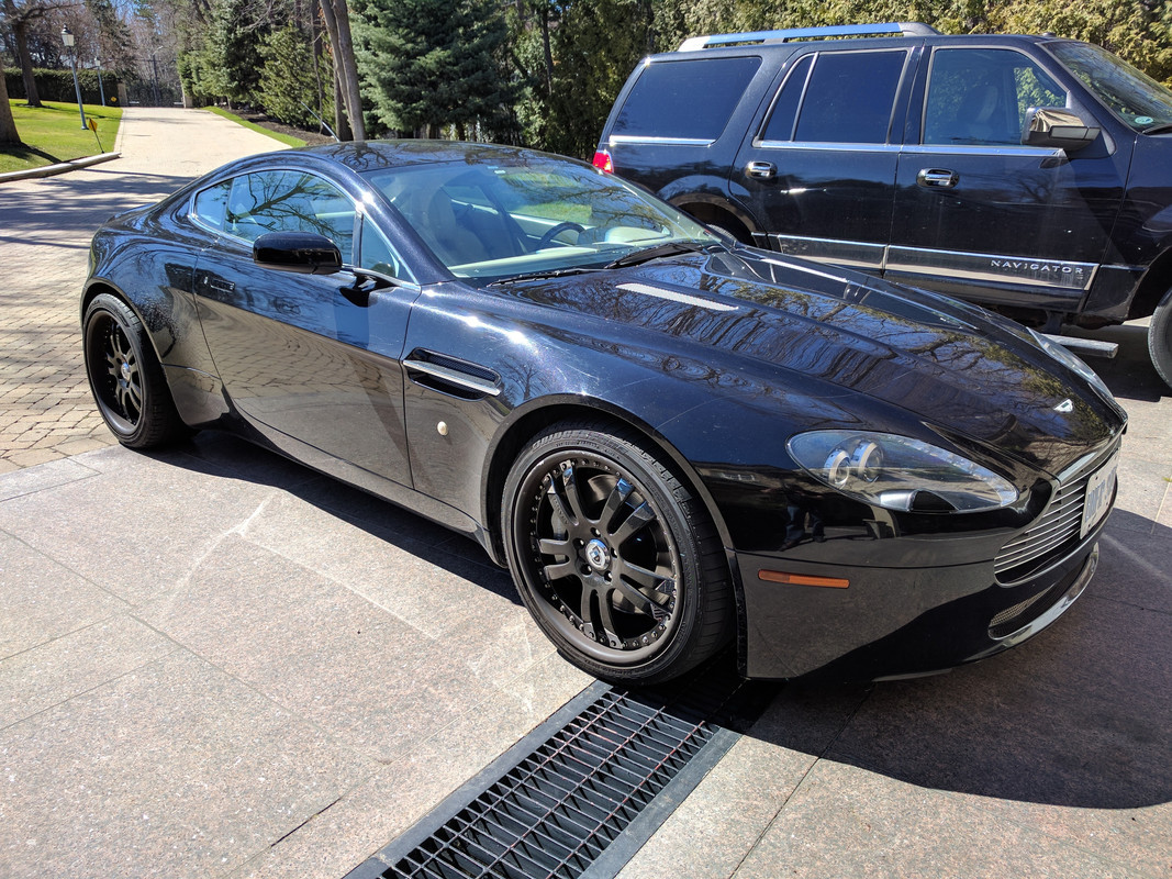

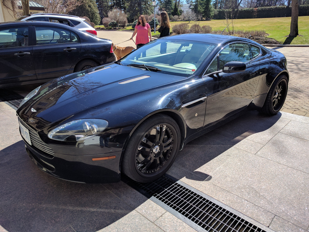

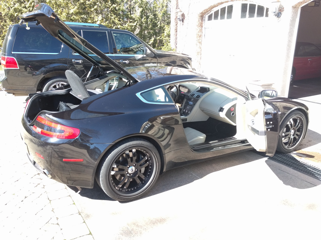

Post First pics before purchase
When I went to view the Vantage, it was in a garage on "The Bridal Path". Ontarian's will have heard of this upscale neighborhood and our US friends may have heard of it because rapper DRAKE is building his mansion on that street in Toronto.

Nice find, I had a used 2007 Vantage as well for two years. Very good cars, I think 2007 is a good choice for your first Vantage. If you would like a set of original 19" 2007 Vantage wheels let me know. They are still in my garage, and are in very good shape, no Curb rash. If you go to your local Aston Martin dealer and show them your car or send them your registration and Vin number. They can print up your build sheet that will have the interior color and all of the options.
That's a very unusual interior color after a good cleaning and conditioning it should look stunning. Injoy your car, it is a beauty

Originally Posted by 007V8Vantage
If anyone knows where to find my interior colour, please advise.
Thanks for looking!
The interior color is "Sandstorm " its the same as mine , glad to see you didnt choose one with a black interior . With some cleaning and detailing looks like it will be a nice. Get some carbon fibre film (cheap off fleabay) and wrap those sill plates to hide all that scraping from the old owners lazy entries into the car . Im not sold on the wheels but each to their own as they say .
Enjoy the ride .

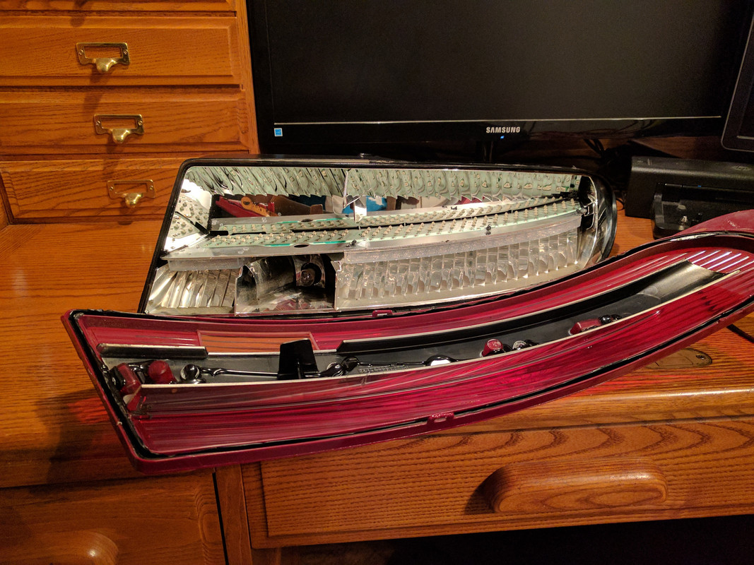

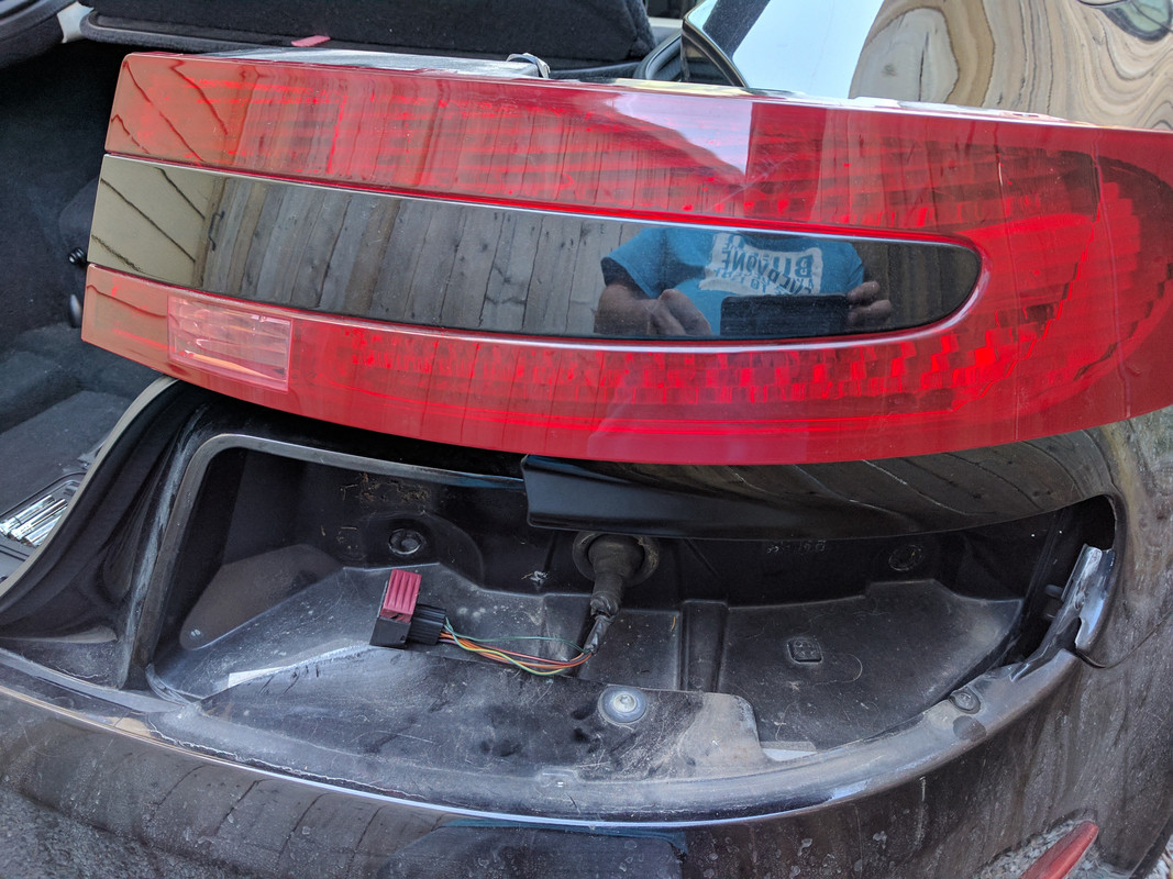

Vantage is home so time to start dismantling parts that are going to be replaced when my new parts arrive. Unfortunately I am "garage less" at the moment, (long story) so you'll see what can be done outside in a very tight space!
First I used my car ramps to elevate the front end and remove the damaged and broken front valance:

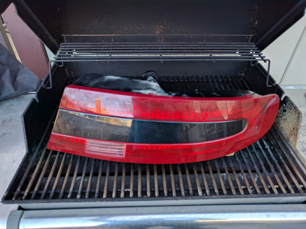

Next figure out why right rear parking light not working - wait a minute (reviewing pics I'd already taken) it has a water line about an inch from the bottom!
Note to self - RE/RE tail light is not a 4 hour job like the $440 I was quoted (removal took 4 minutes BTW):

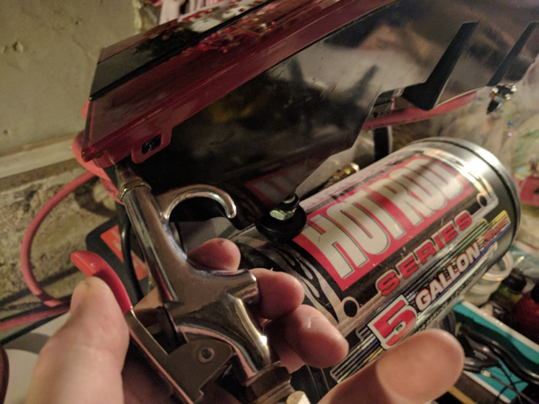

Removed screws, let water drain (seriously 6 oz. into a glass) and then used my air compressor to thoroughly dry:
Time to open it up despite being a "permanent" seal. A few minutes on the grill (or BBQ as us Canucks call it) works like a charm. Temp of 100C or 225F works best then you can release tabs with flat screwdriver and pull lens off by hand:
Oh no, lots of water damage inside, (white powder) so going with "Plan B" which is order a clear taillight kit (something I wanted to do eventually anyways).
I'll keep the left rear red one as parts since it's almost new.
Better remove the black painted inserts I'll need to transfer over.
No tools needed just carefully pulled clips out and worked my hand along to release the two way tape.
