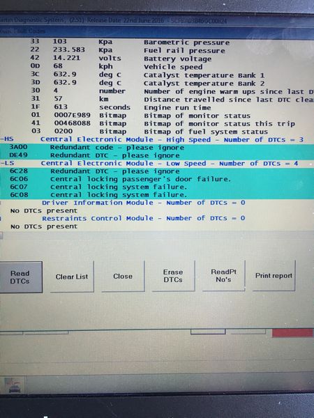

these are the fault codes, that come up

P061B usually associated with a sensor fault and is tied into P2106. Does your car have an aftermarket tune?

You have a CAN fault. Likely water ingress or damaged wire. Stick your head down by the fuse box in the engine bay. The bracket is weak and often refitting the fuse box lid results in the bracket bending and digging into the harness. Next, have a look at the three plugs clipped into the base of the a posts, you will have to pull the carpets outward and shine a light in there to see....water ingress is common and it will crash the low speed CAN and cause your issue. The fact that you have faults logged in the CEM points to this....
The faults in the CEM are related to the passenger door, either the latch is sticking/worn or the inner handle cable is holding the latch unlocked when it should be locking..I don't see any signs of a LSCAN issue nor water ingress in those dtc screen shots.
The harness under the EFB was not chaffed from a "weak bracket", it was from vibrations moving the harness and eating at the wires through the loom that was badly positioned. This is a 2006 which already had the harness loom moved and weather trimming added to edge of EFB bracket..it's still possibly chaffed but LSCAN is not going to cause an engine operation issue, it's not even on the LSCAN. I would also expect to see other circuit issues either not in range or grounding out and popping fuses.

Do you have access to an AMDS or was this just pic while at the dealer? Have you checked to see if the misfire factors are stored? You stated the clutch is "new", how many miles are on it, do you know if the misfire factors were wiped out to learn the new 36-1 of this flywheel?
I don't think the misfire factors are learned on this car, which won't solve the issue but will help us see if the car is misfiring. If you indeed have low fuel pressure, you'll see this instantly when the concern is present. Without them learned, you will not detect any chance of a misfire..decreases the chances of finding the issue, especially if it's a CPS issue.
I would also make sure your running the latest engine software for the early files had various glitches in heat ranges that did not operate correctly when the EGR opened up. If you getting into 50% throttle, sounds like you might be in the EGR open range, and guessing near operating temp. Again, not stating this is your issue, but would definitely need the software to latest version and then correction factors learned, followed by a KOEO and KOER test to view all sensors.
Btw: the freezeframe in the pics is useless to diagnose with, that's the freezeframe for P0420 and not P061B forcing the issue.
No I do not have access to the AMDS, I just borrowed from the garage, the clutch is only a few months old so less than 1000kms, it was installed my aston martin so I am assuming they set up the misfire corrections,
how do I check this? should I bring vehicle back to dealer for them to fix?
as I do not want to get taken for a ride.
is it worth updating the software to the Velocityap software? or should i wait till this issue is sorted,

this could make sense as 1 sensor is reading different according to the AMDS freeze frame,
I might try swap out throttle pedals & see if that fixes it,
