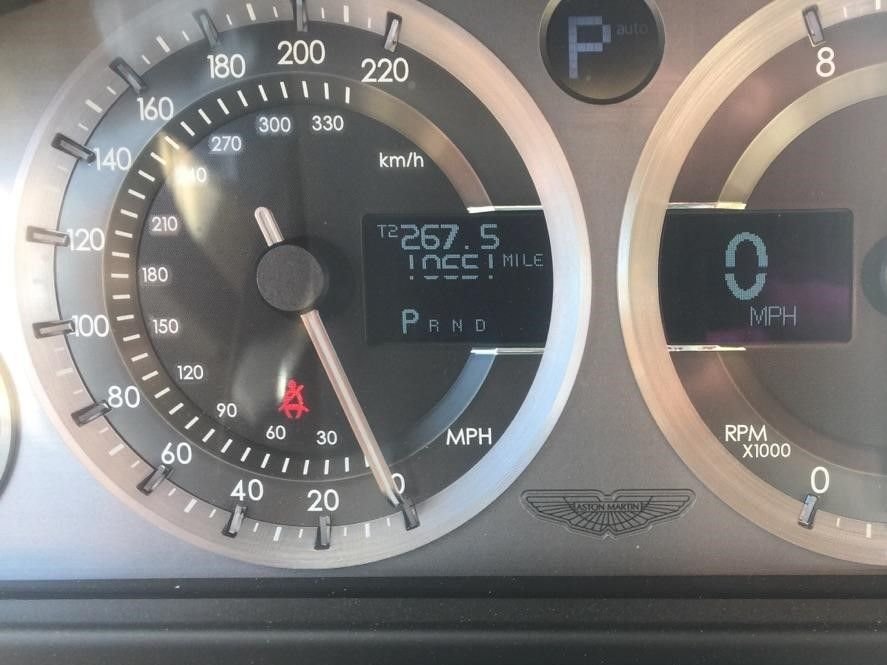

I am looking at a low mileage 2007 DB9 Volante to buy.
A concern I have is with the mileage-message LED display.
The screen has a horizontal black line running through it as if one row of pixels is not properly illuminating.
What could be the cause? What is the remedy? How expensive to fix?

Is that in pictures? Or in person? In pictures you'll see all sorts of strange blips in the screen that are not there in person.

Here is the photo.<br/>

on Audis it is symptomatic of the LED's dying in the DIS (driver info screen)
they can be removed & repaired but havent done it on an AM
google LED repairs or DIS repairs or look on the Audi forum for contacts/ referrals for repair
I'm sure there is DIY guide somewhere on removing the instrument cluster too
good luck

Make sure to ask if it's present on the display and is not just the picture, I saw 20 like that when searching for a car and anytime I saw one on a car I was interested in they always said it was just the picture.

Yeah, it's possible that it's because of the refresh rate of the screen vs. how fast the camera takes the picture. Ask for other pictures... if it's always in the same spot, it's an issue... if it moves or disappears, it's an image artifact.

I took a picture of my V8V dash the day I bought it. There are no issues with it when viewing it with your eyes, but the picture shows a big bar through the speed readout. That may be what's happening in your image, as others have suggested.

The sometimes happens when you photograph a screen. The refresh rate of the screen is caught by the camera lens. You don't see it with the naked eye...

You guys are Right!
It must have been an issue with the camera. I looked at the car yesterday, no problems.
So I bought the car.

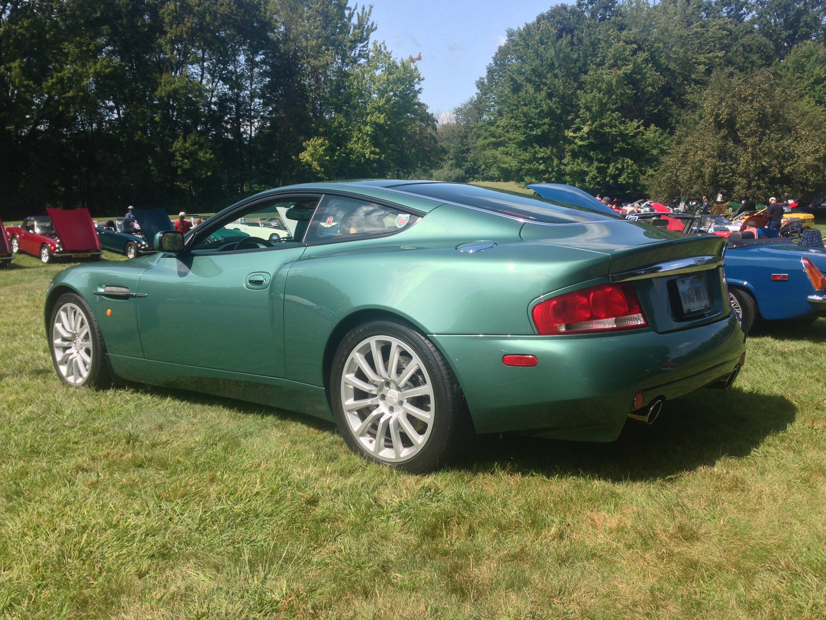

Great traditional Aston shade of green. You don't see very many in that color; don't understand why that is the case. It'd be like seeing very few Ferraris in red. Good luck with your baby!
Same color at a local British car show...
