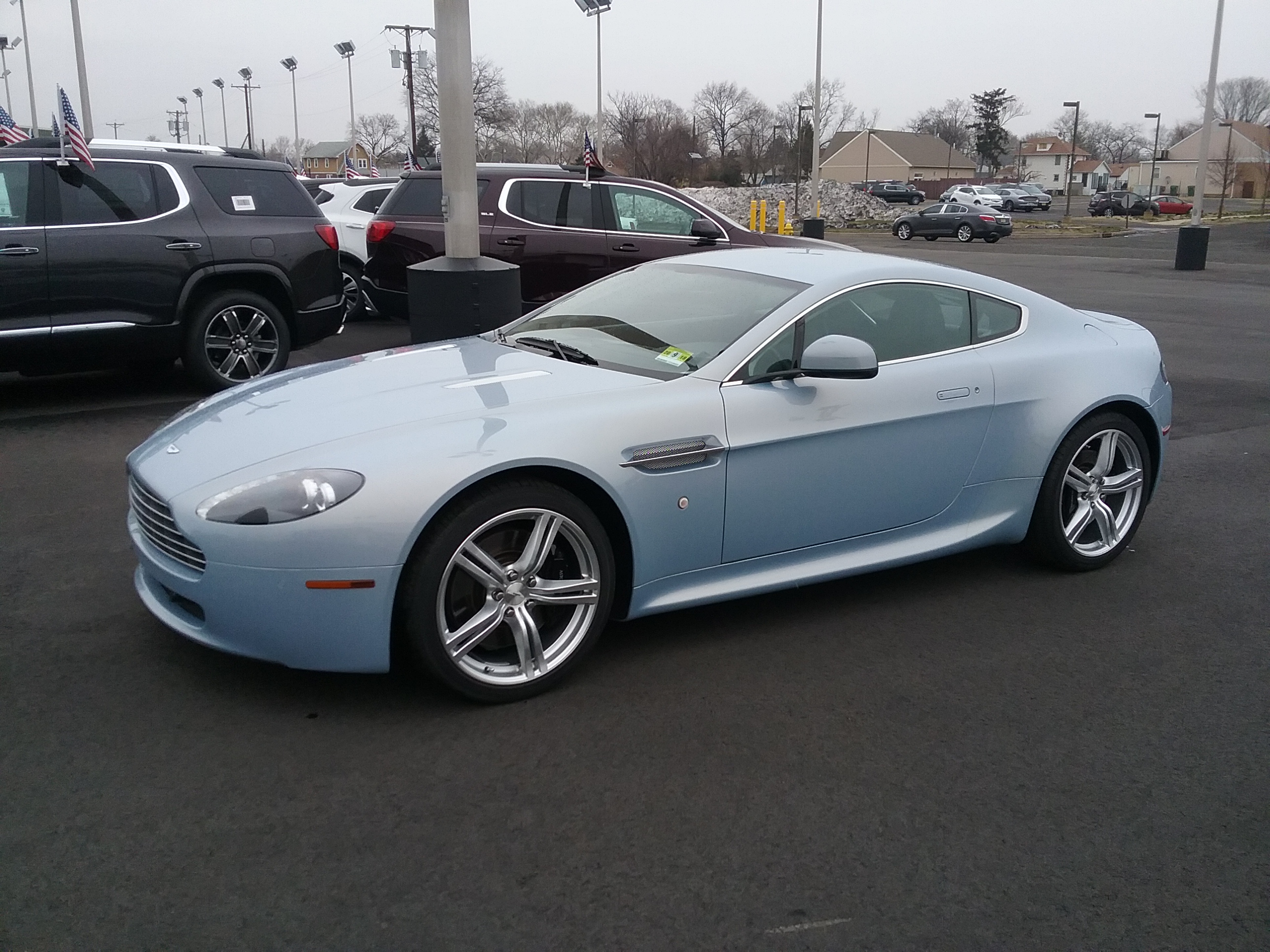

IT'S ALIVE!!
And surprisingly difficult to baby it when I just want to plant my right and see if this engine turns like the original! Not that I was told to baby it, in fact he said just keep it under 5000rpm for 500 miles, but that I can floor it. There is nothing in the manual I could find on what the recommended break in procedure is so if anybody knows for sure I'd love to hear. I've kept it under 4000 so far, figured that would be very conservative for a couple hundred miles, but 4000 comes quick even at minimal pedal.
I only had one other question, if he had any extra bolts leftover when he was done. He said no, and I believe him

HO
with old school motors its important not to sit at one rev level for any extended period - run it up and down through the rev range & progressively (after the 500 miles ) increase the revs to say 5000, 5500, 6000 for short periods as the miles increase
then after 1000miles drive it like you stole it
and fabulous news that its been fixed for you
Graeme

Well, that eliminates a Florida drive to see some friends just to get the break in out of the way LOL I haven't been able to sit at any rev range yet, nothing but stop and go traffic coming home, but I will definitely try and avoid it. 500 should go by pretty fast, I hope, I've always broken all new cars in correctly but it's always tough being restrained!
Beautiful, AND it drives again. Honestly I was very unsure about the color watching it on ebay for a month. It was a light color and all the other boxes checked, but no matter how much I researched Mako there was no way I could buy it without seeing it in person. It seems to be an extremely popular color in the UK, probably because it's usually cloudy like today where it throws off shades of gold and purple on the fringes of the flop, Americans seemed to be more ambivalent, but if I'm not being ask "what is it?", the second most common thing I hear is "I love that color". I've never seen Glacier in person but it's stunning in pictures.
