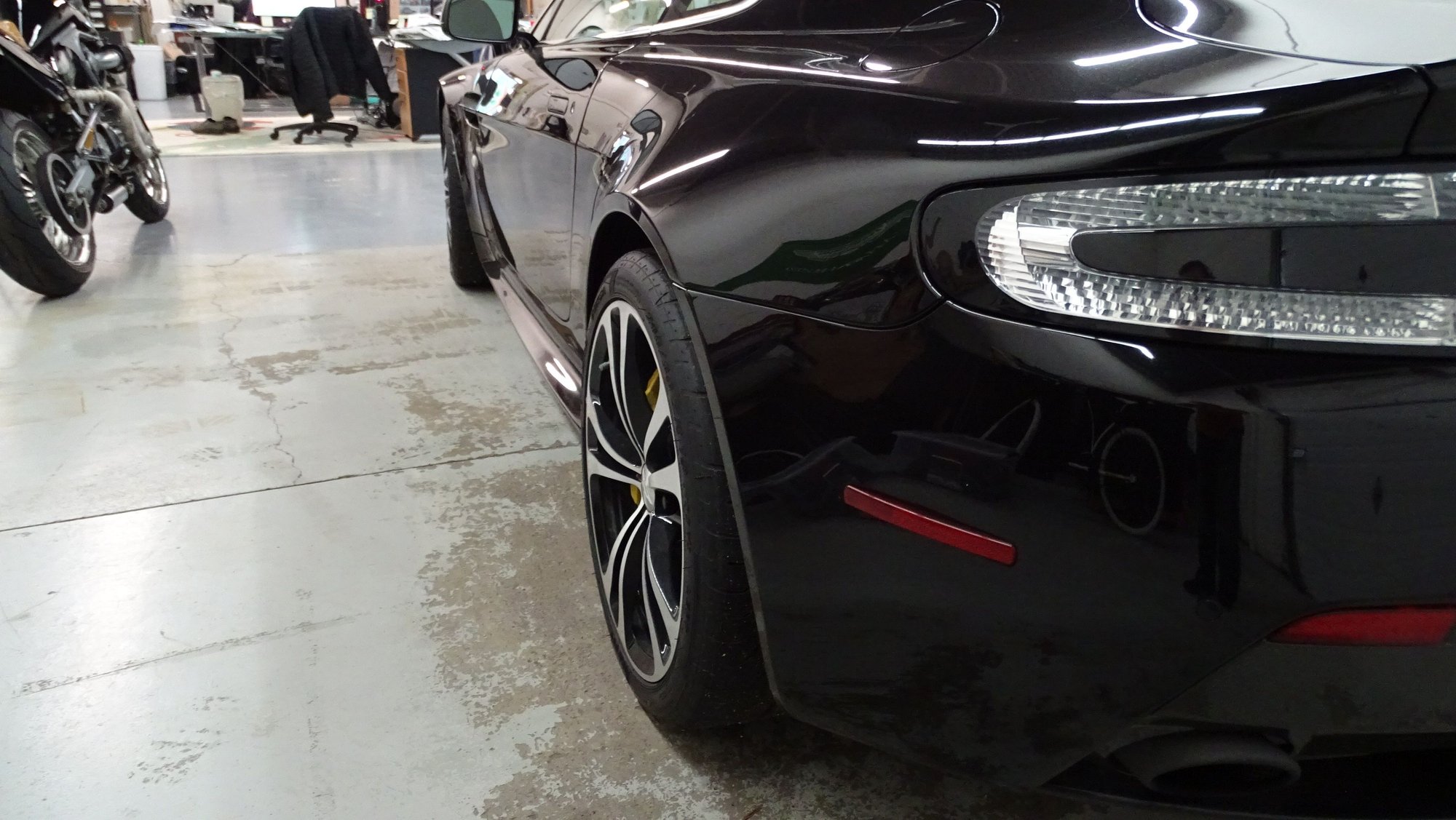

wheel spacers
I have those spacers H&M on my V12S - no rubbing with stock wheels so you should be OK...

Correction, I checked I have H&R 23mm rear and 11mm front - was told that wider in the front could rub. The spacers came with studs.

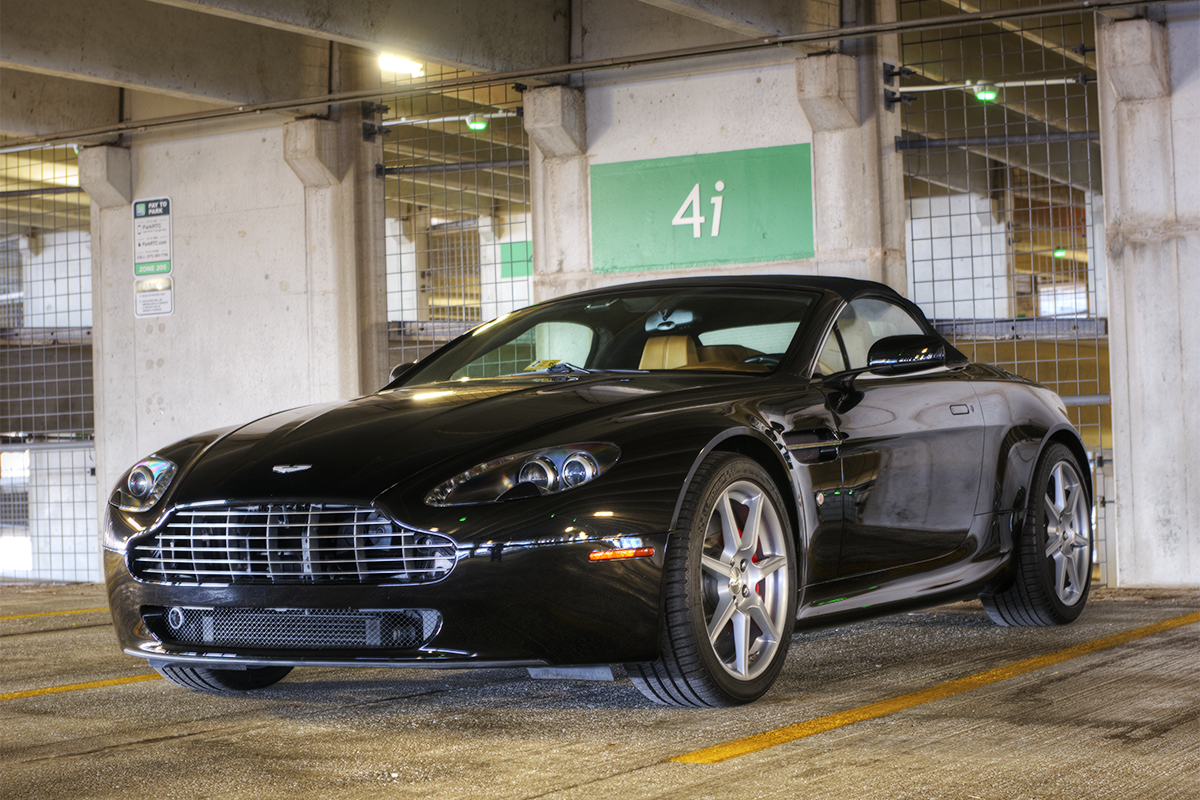

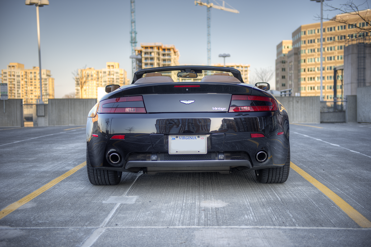

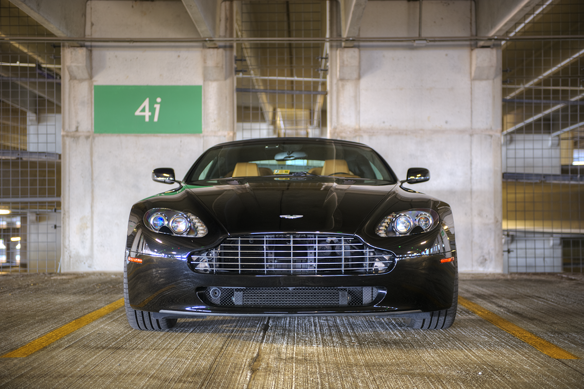

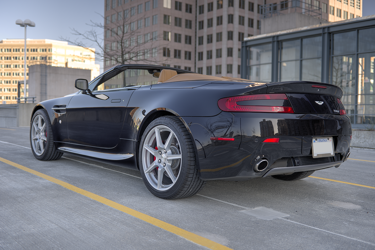

Looks like I'm a little late. I went with the RSC Tuning hub-centric spacers, 15mm front and 20mm rear.
They come with longer wheel bolts so you'd need to press out the (shorter) stock bolts and press in the longer bolts. It's a bit of a pain but I felt this was a safer option than the Adaptec spacers that bolt on to the hub then you bolt the wheel on to the spacer.
Anyway, here are some pics:
