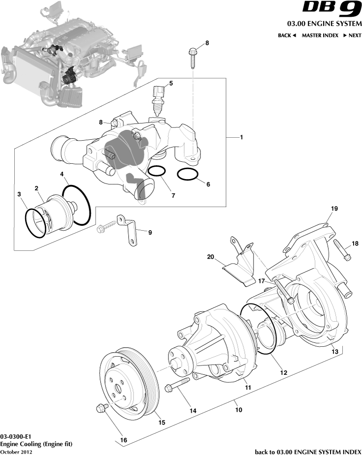

Aston Part 4G43-05-10957 (no. 11 in the picture) is a Ford part, e.g. Motorcraft PW423. Looks like the impeller design has gone through several updates over the years. $500 for Aston, $35 for Motorcraft.

That is great to know.
Any idea what the ford replacement is for part 2 above?
