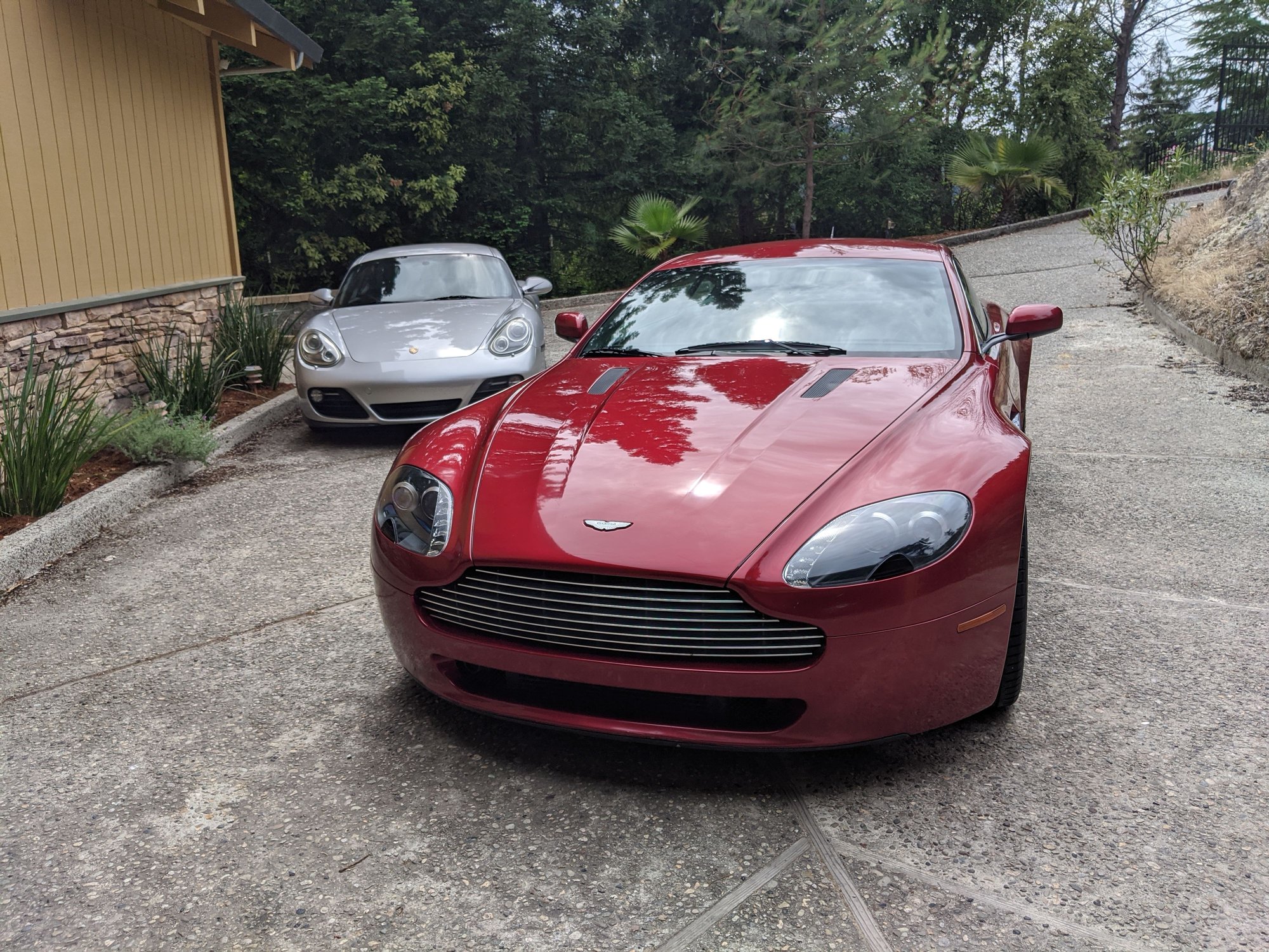

Finally, here's a photo of the 'band' before the Cayman heads off to BaT.
Thanks as always for any advice and/or commiseration. Niggles aside, the car is awesome - no regrets 👍

Regarding the doors: is it both doors, or just the driver's side? Knowing that might help narrow the issue.
I've heard that the car's battery can cause some weird electrical gremlins when it gets old. Don't know about it keeping the doors from opening, though.
By the way, it looks great in red.
Thanks. It's a problem with both doors.
I really like the red - that puts me in a very small niche within an already small niche of AMs around here. I think it's Toro Red but I'm not sure - which sticker has the paint code in the trunk cubby on the left?
It's forward, on the bulkhead above the nav unit.
I'm right there with you on unusual colors for Astons... mine is Speed Yellow.

Thanks - looks like it's "ASTI 3020 Toro Red".

Congrats on the purchase. If this was in Dallas, I checked it out while killing time on a business trip last year. Love the color, it compliments the car well!
