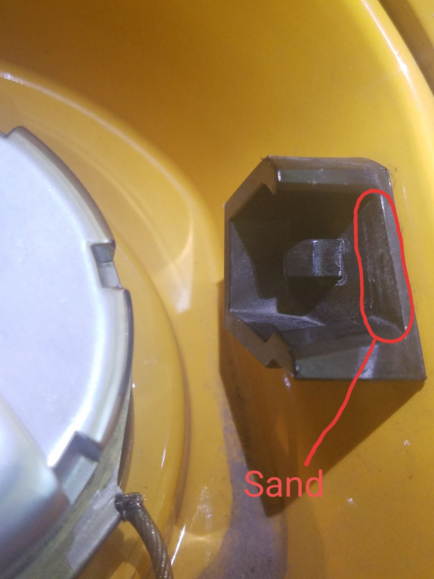

May 26, 2020 | 11:11 AM
I may be able to help with a couple of these.
2) I had the same problem with the fuel door staying closed. I found that the door catch was too tight in the receiver, so I sanded off some material from the area in the photo below. Opens every time now.
4) The side repeaters are the same as the ones on the Ford Transit van. Part number 9T1Z-13K376-A. They're about $14 on Rockauto, if I remember correctly. When mine fell off I ordered three, just to have extras around. If you can't find one, PM me your address and I'll send you one of my spares.
