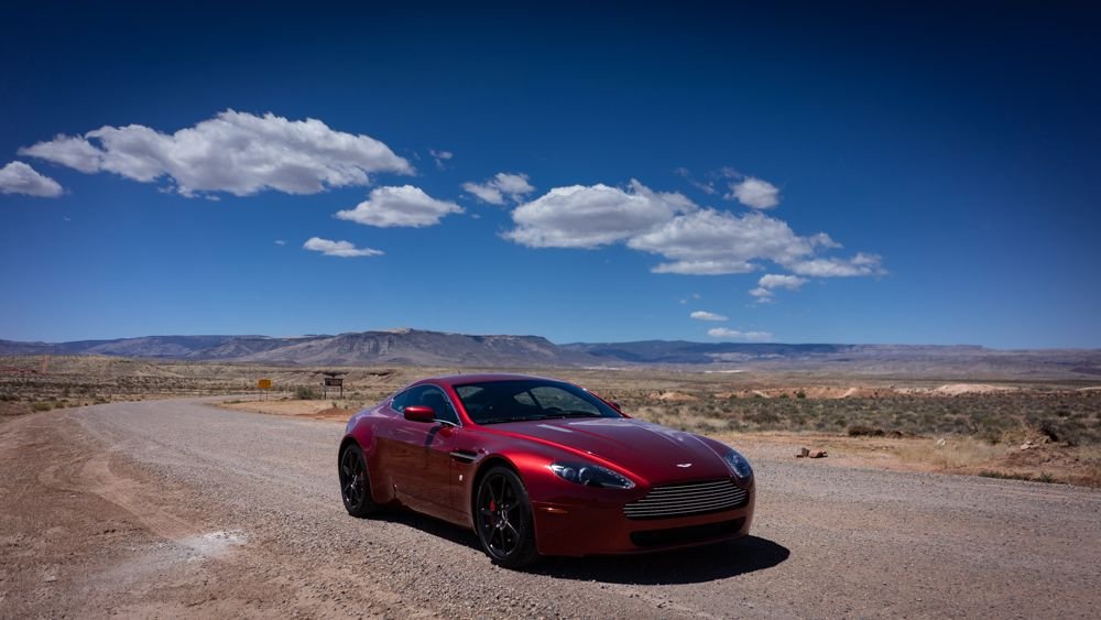

I also had another annoyance addressed - new wheels. Turns out they had a set of refurbished AM wheels - though in gloss black. I wasn't initially sure if would work, but I'm very happy with the result.

One year update...
A number of original issues have now been resolved -
  • Doors open consistently after some fuse pulling and resets (no cost)
  • Fuel filler door opens as expected. I had this one fixed by Robbie at Peninsula European while it was in for another fix. I have a feeling that using the fuel filler cap holder when filling up probably knocks it out of alignment over time.
  • I just had the old front end PPF removed. Unfortunately this proved to be quite the ordeal, and needed ~20 hours of labor by my local expert. The good news is that the paint underneath is intact so I avoided a front end respray.
  • All door struts and broken/faded repeater lamps have been replaced.
  • All four wheels replaced.
Back in December I snapped a shifter cable ;( The good news is that closer inspection showed that the clutch had likely been replaced recently. After further detective work we discovered that a PPI before I bought it flagged a worn clutch, so the assumption is that it was replaced just before I bought it. The shifter cable likely snapped as it wasn't adjusted correctly when the clutch was installed.
Beyond that, no recent emissions system warnings or any other new issues. I still need to take care of the driver door rattle (likely a screw has worked its way loose), and get a replacement washer fluid reservoir. Much like the Porsches I owned before this, I feel like I'm getting to the end of taking care of deferred maintenance from previous owners, but in this case I'm not yet tempted to sell it, even if it's probably increased in value by ~50% since I picked it up last year.
Enjoying desert life

slvrin: i'm usually unimpressed by black wheels, but boy, oh, boy do those look nice with that lovely red paint. kudos...

Agree completely…stunning in that colour..

Appreciate it guys. I was not sure about it either, but it works well and gives it a bit more 'menace'.
