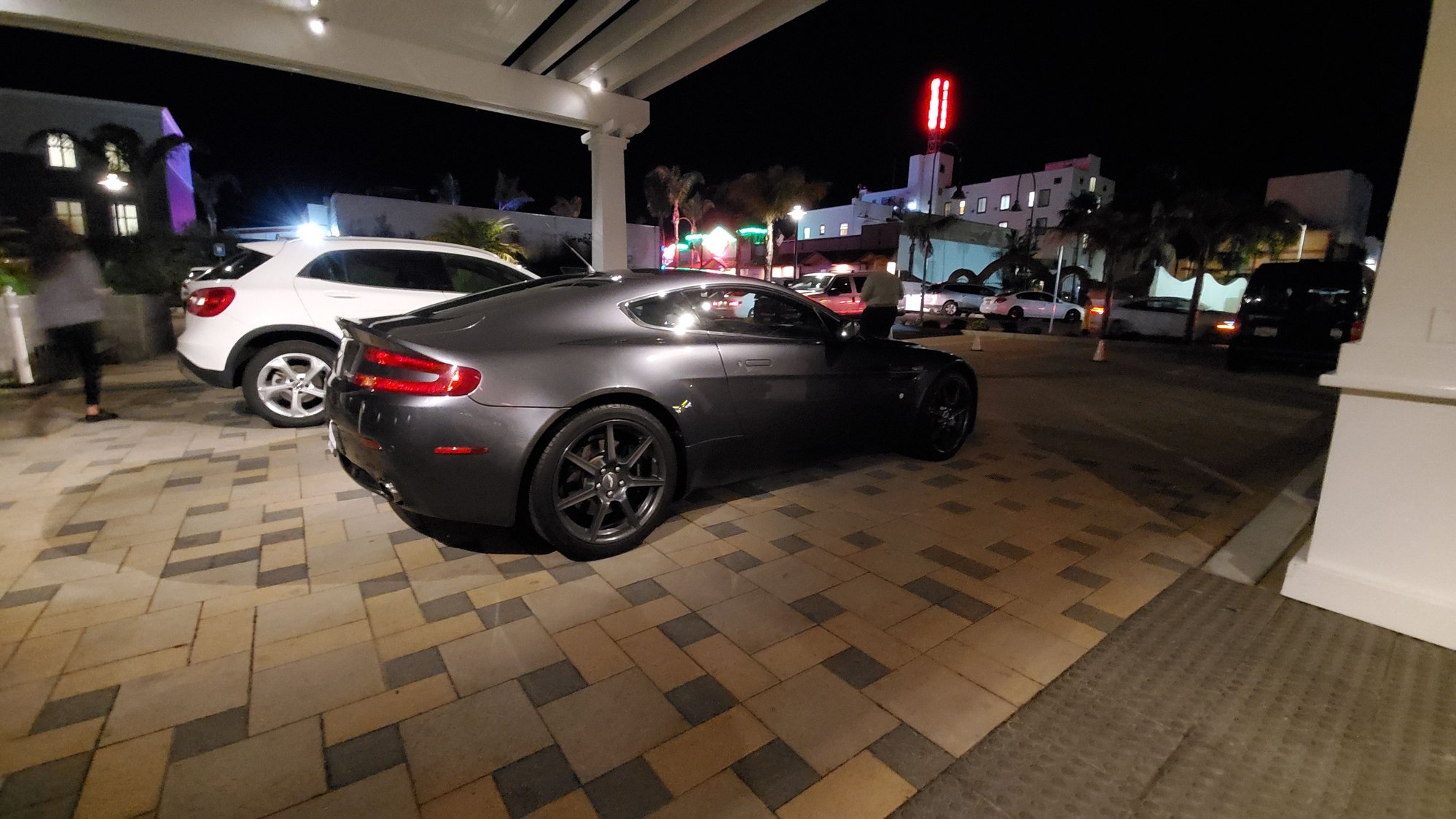

Originally Posted by kaj750
Tail lights: Makes sense. It's kinda like when people use clear because it kinda blends in. I like contrast so won't be swapping. My wheels are dark grey, which helps hide brake dust LOL.
I'm not a fan of black wheels (I think I'm just bored of them), so the grey is a nice compromise IMO.
Again, congrats! I love, love, love these cars.
is that meteorite silver? I also like the red taillights but blacked out the red reflectors in the bumper with black reflective tape. black satin wheels hide brake dust fir sure...
Mine is Meteorite, yes. It's the exact spec I wanted (I got beyond lucky to find it)... though I recently saw one in Tungsten... and I think I may like it even more LOL
