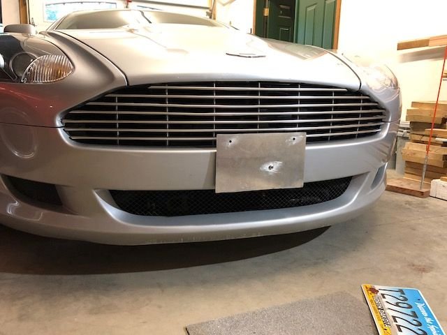

This is my first post on the site, so I apologise if I upset anybody with my non-factory resolution to the front license plate mounting issue. Here in North Dakota there is a chance that you can get pulled over for missing a front plate, so I didn't want to risk it with my recently purchased 2005 DB9.
The photos show the preliminary construction that I will probably use for a while, until I get one built with sturdier aluminium stock.
The "secret" that makes it work, is the use of a 'well-nut' threaded onto a 1/4" stainless bolt. When the rubber portion of the well nut is pushed into the tow hook port and expanded, it holds the aluminium sheet quite snugly.

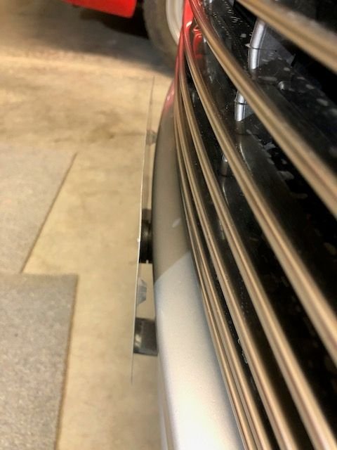

I folded the lower portion of the sheet under the valance and attached it to the bodywork with two velcro pads. This 3 point attachment holds the assembly nice and solid.
I left a 1/2" gap between the sheet and the body and attached two small "Scotch bumpers" to absorb any vibrations at high speed!
Here the plate still shows the sanding marks (sorry) but as I said, this is probably just a temporary fix until I make one with heavier gauge aluminium. Oh, and I'm not going to be adding that trailer plate to the front! That was just a template.
