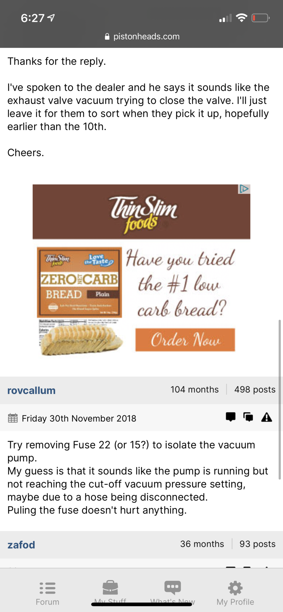

After more digging I came across the same issue on a piston heads form.
sounds like it’s a constant running vacuum pump
would there be any harm in taking out the fuse and continuing to drive it until I can get it fixed at the dealer?

Removed fuse 22 and 15 as a test, unfortunately the sound did not stop...
