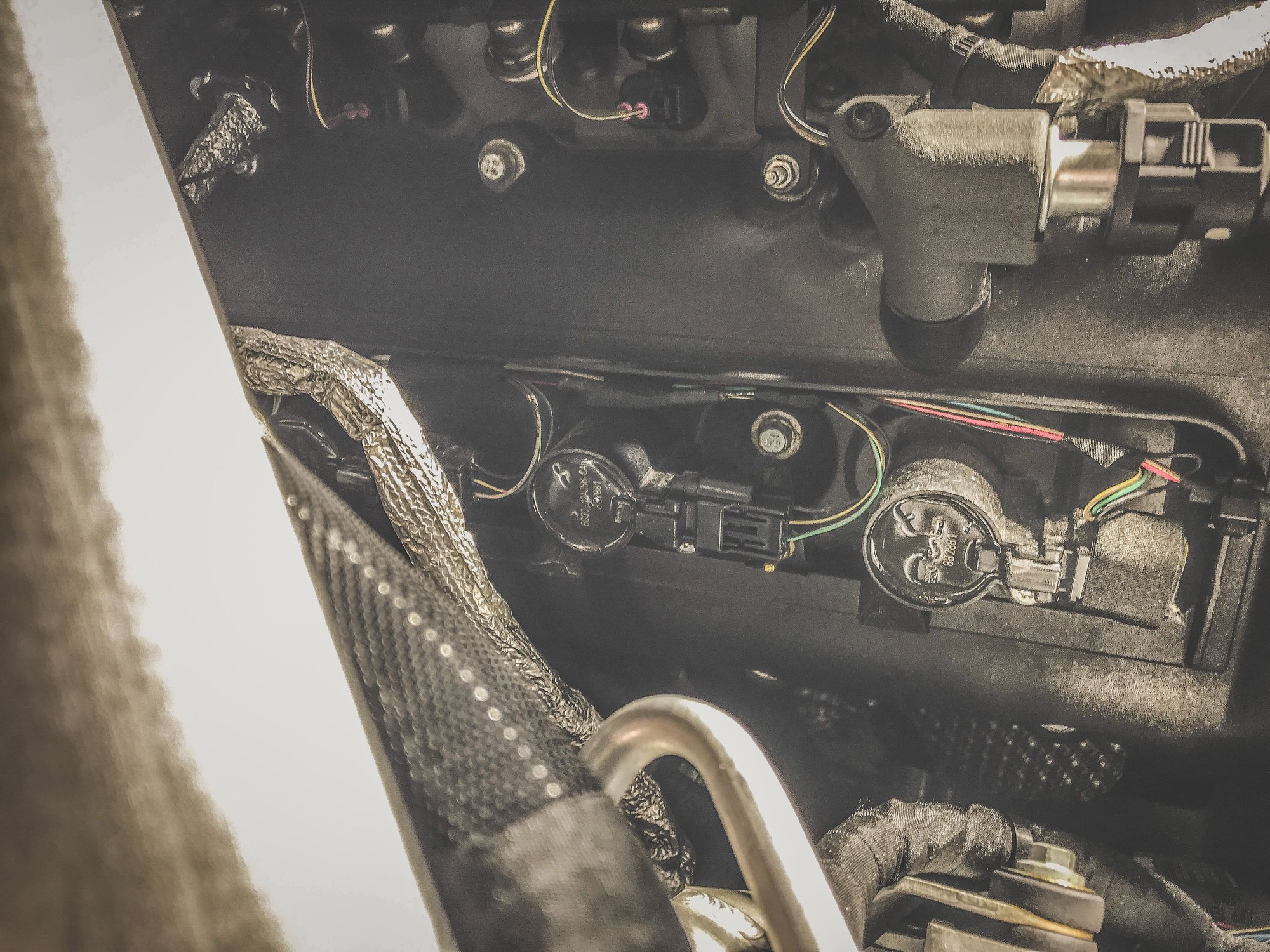

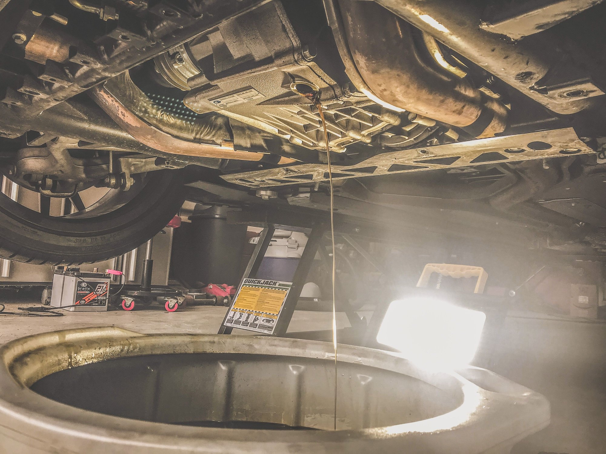

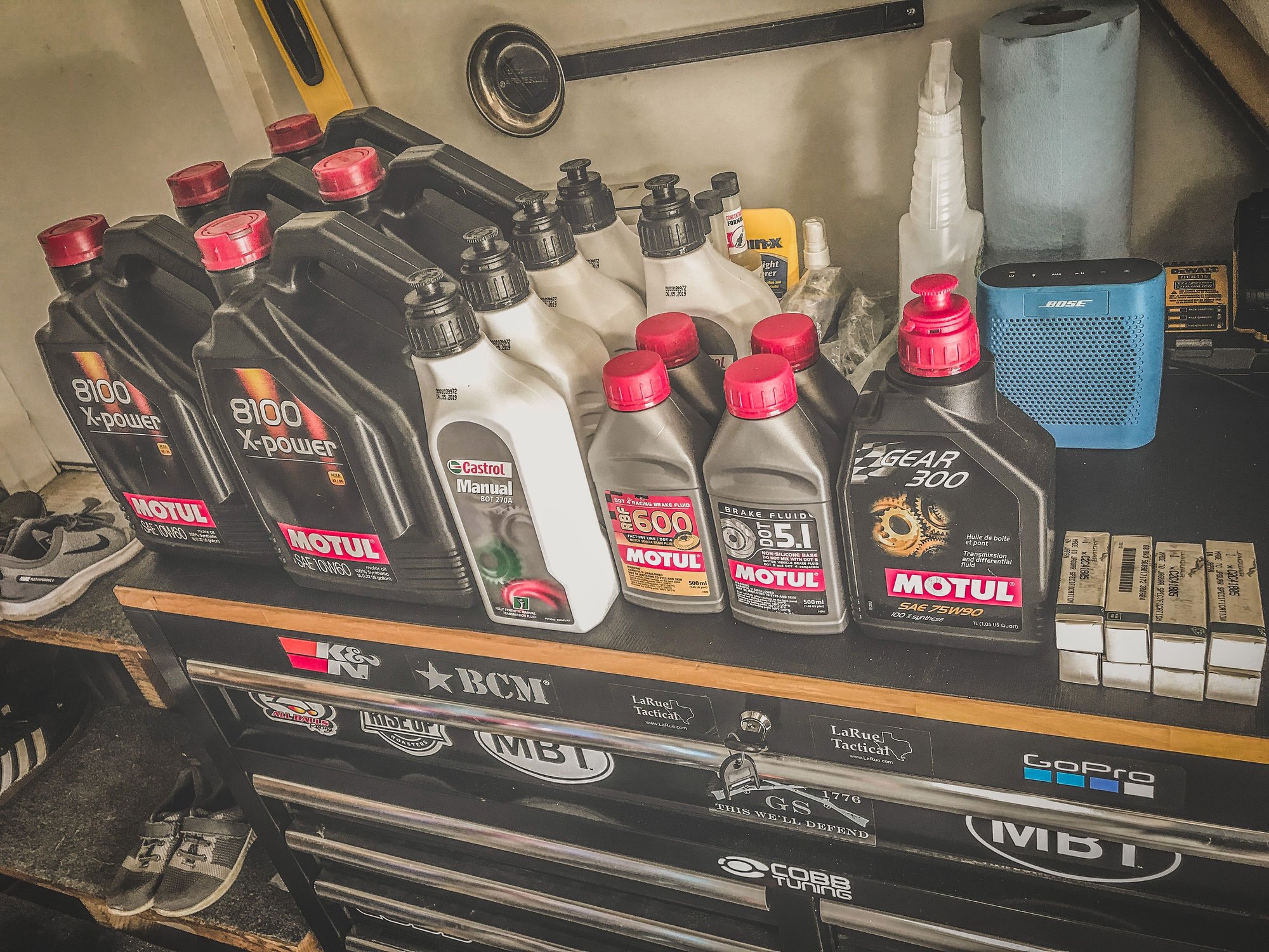

Engine Oil and Filter (Yearly)
- Motul 10W60 ~9.5L - 10L
- T30 for undertray
- T40 for undertray
- Flat Head
- Philips Head
- 13mm socket for drain bolts
- Filter Wrench
- Torque Wrench 26 ft-lbs
Trans/Diff (Every 2 years)
- 5 bottles of Bot 270A (~4.5 bottles worth)
- 22mm for Fill Bolt
- 14mm hex for Drain Bolt
- 8mm for Filter
- Flat Head
- 13mm for Under Tray
- Torque Wrench 36.5 ft-lbs for fill and drain bolt.
- Filter bolts hand tight
Brake and Clutch (Every 2 Years)
- Motul 5.1 (RBF 600 and 660 for heavy track)
- 21mm for lug nuts
- 11mm for bleeder nipple
- Flathead (when necessary for caps)
- 9mm and 14mm for clutch nipple

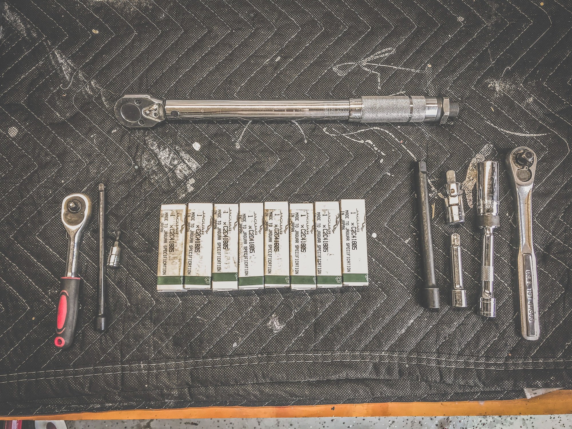

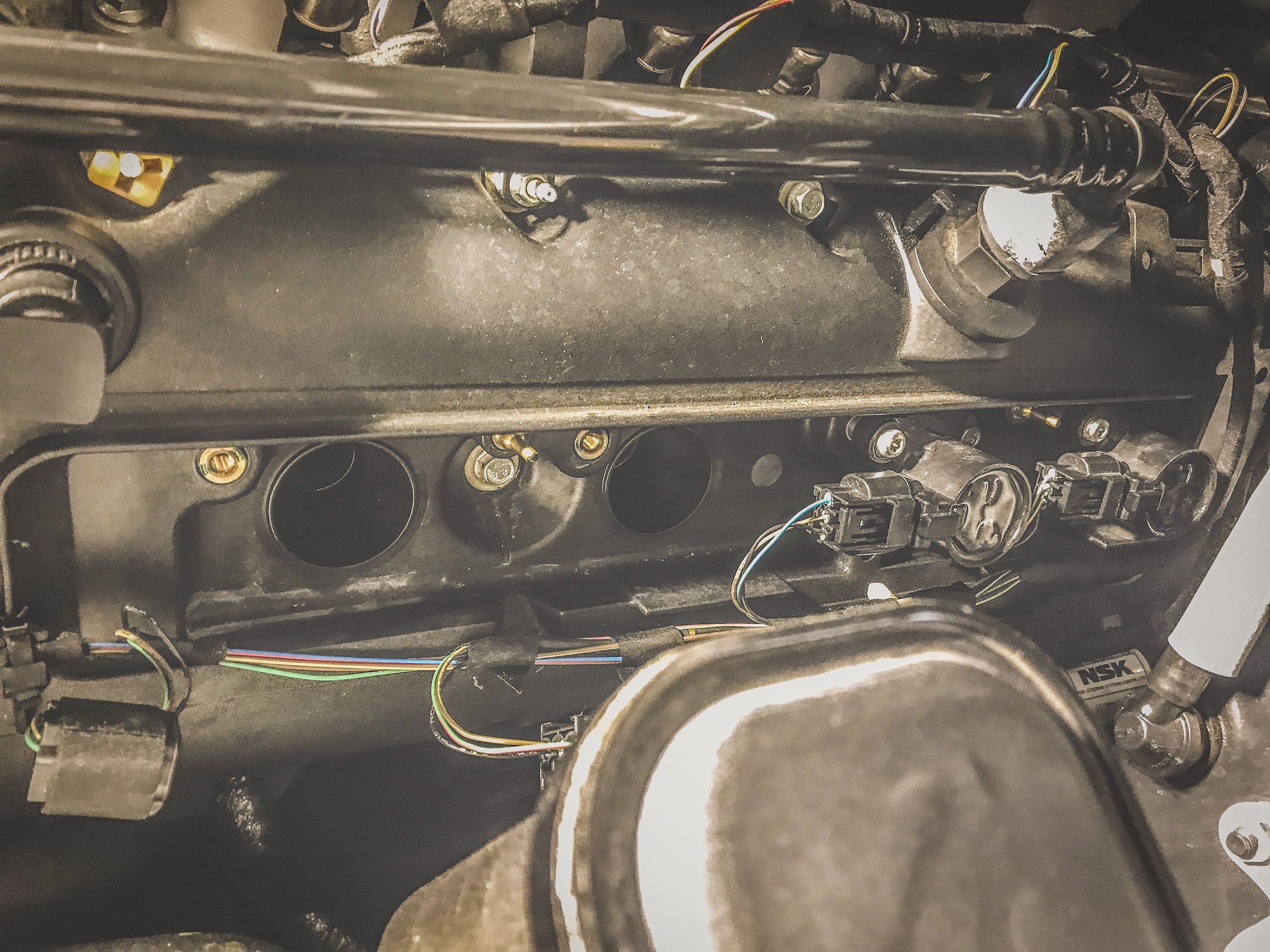

Spark Plugs (Every 7 Years/70K)
- Spark Plug specific 5/8 socket
- Various extensions
- Wobble Joint
- T20 for coil packs
- Torque Wrench 18-20 ft-lbs

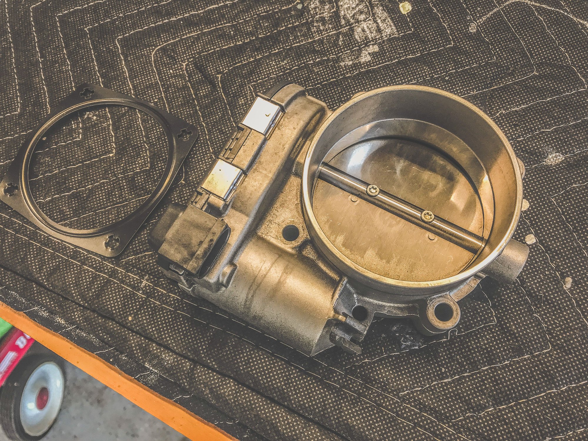

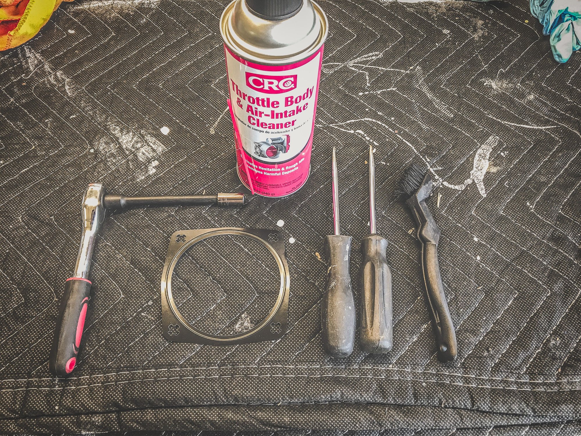

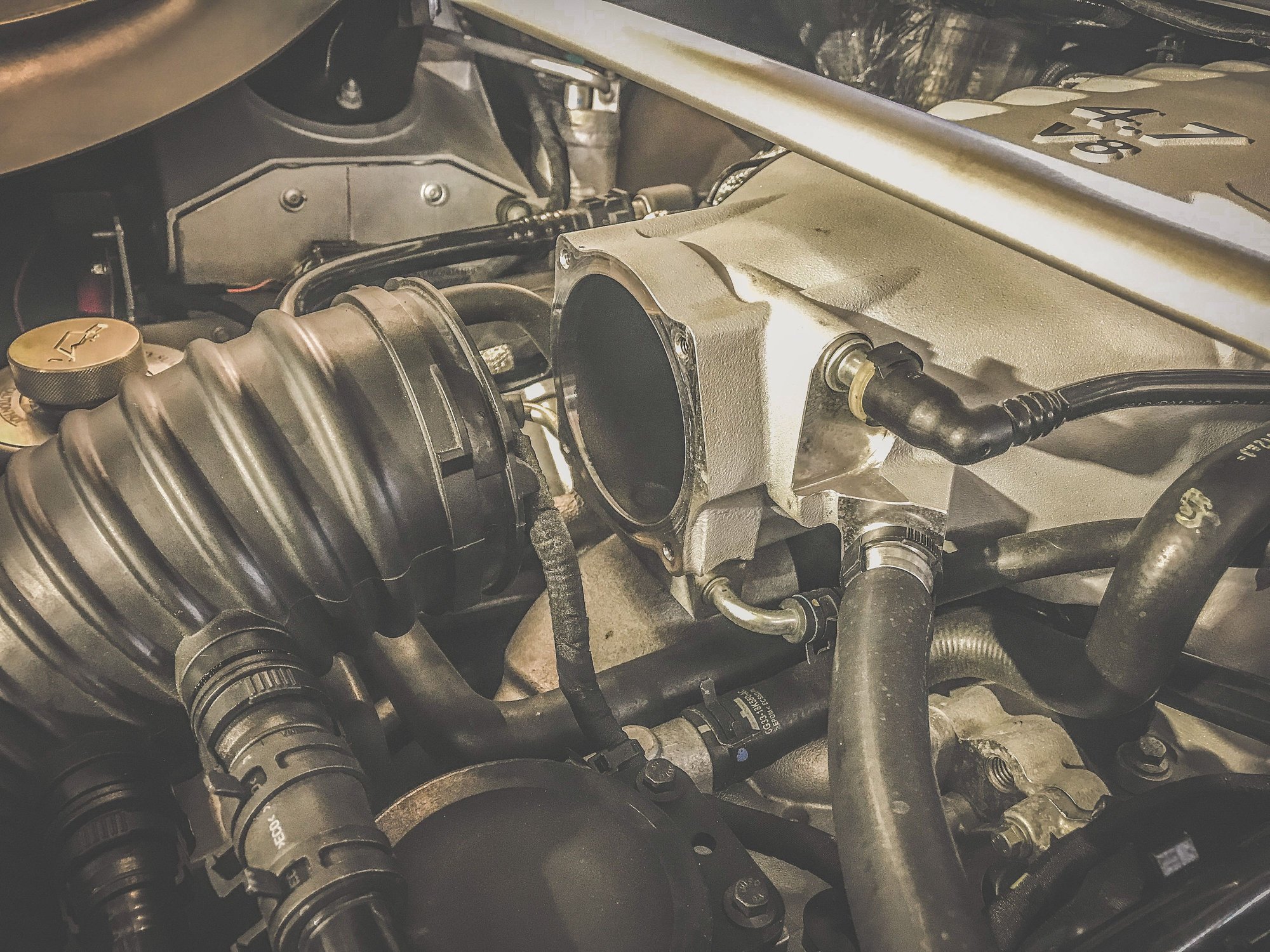

Throttle Body Gasket and Cleaning (Every 2 Years)
- 8mm for Throttle Body
- 2 Flatheads for clamp

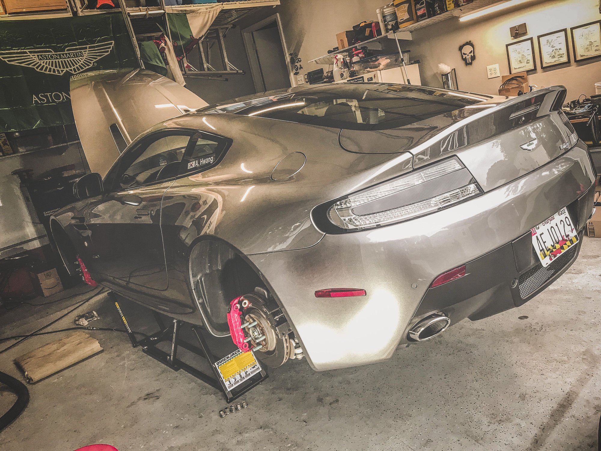

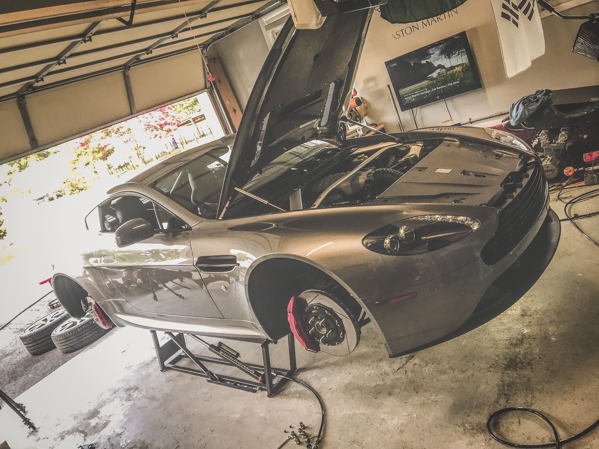

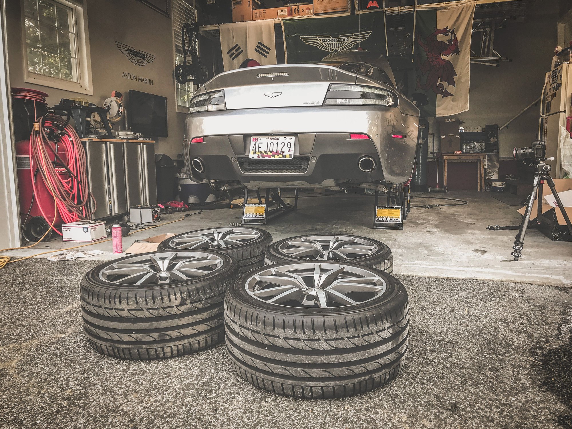

Some photos from the days.
