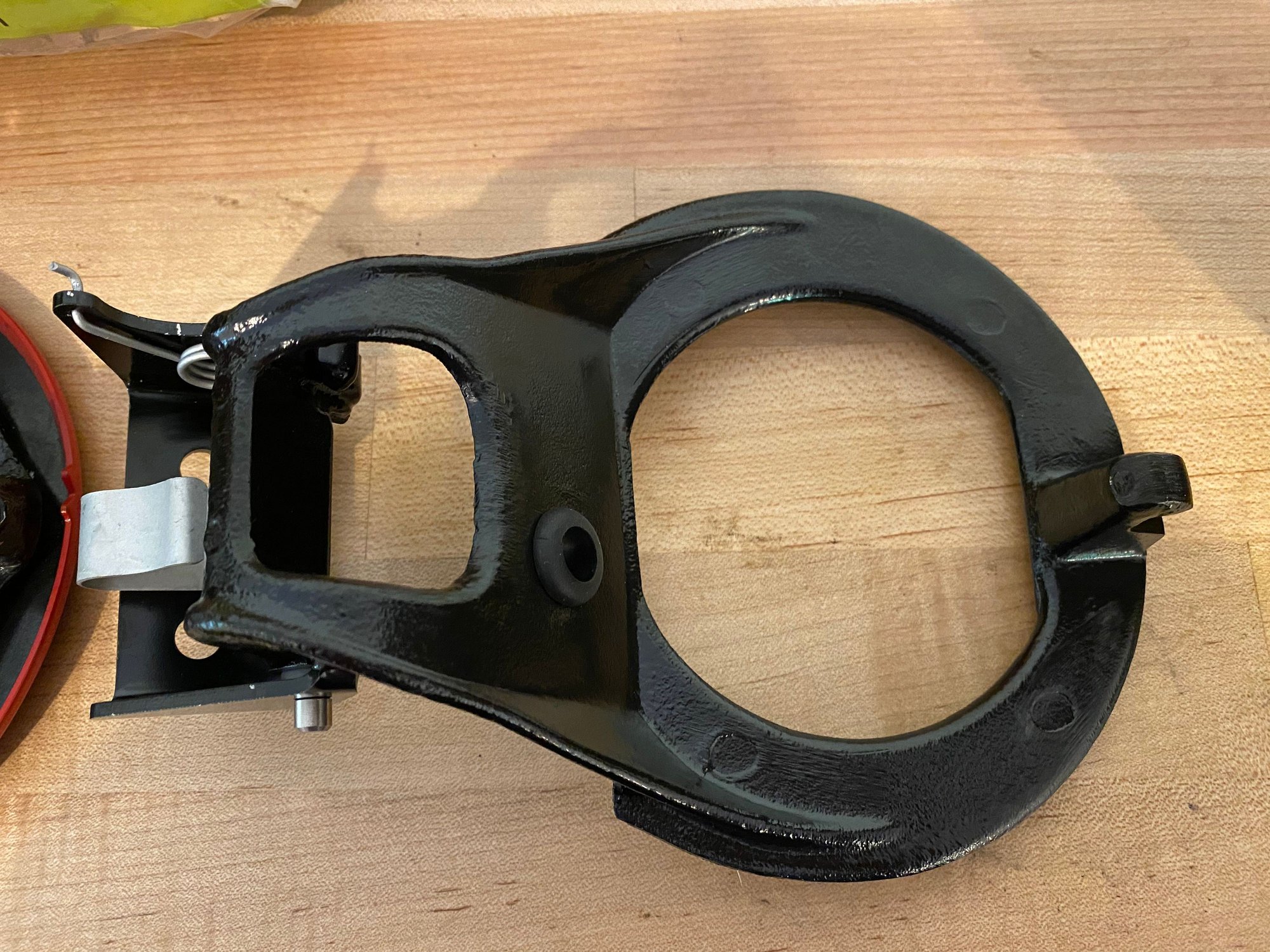

My new to me Vantage was struggling to pop the door with the button press. The solenoid was working.
Interestingly, I found the mounting bolts to be loose, but the painted panel also was hitting the edge of the body when the bolts were tightened. Therefore it wouldn't work properly loose or tight. I tried bending the bracket for better clearance and broke it. It's a cheap cast aluminum I think. So don't do that, now I'm waiting for a new bracket and will have to re-adhere the body colored panel to the bracket with the proper alignment. I'm going to make sure I put loc-tite on the bracket mounting bolts too since they were so loose. My first real oops on my new car.

So wait, you said not to try to "adjust" the fuel door?

Lol.
I see yours is cast. The new part I received is stamped.

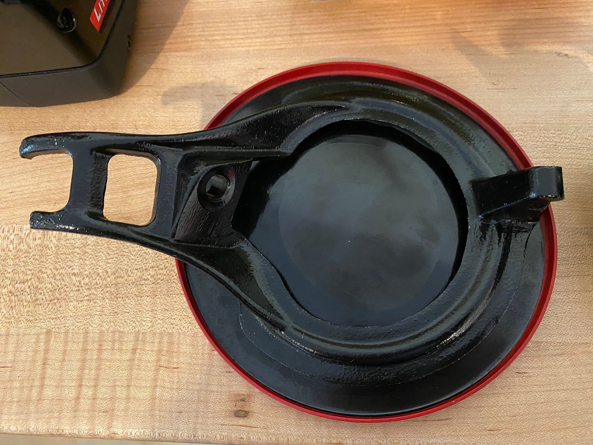

Yep, I eventually got the new stamped part as well. I initially ordered the replacement from Aston Martin Bits and they sent the below piece. It was still cast and I think for a DB9 (didn't fit). On the second try I got the new stamped part and thought "AML improved the design, must have learned some lessons".
