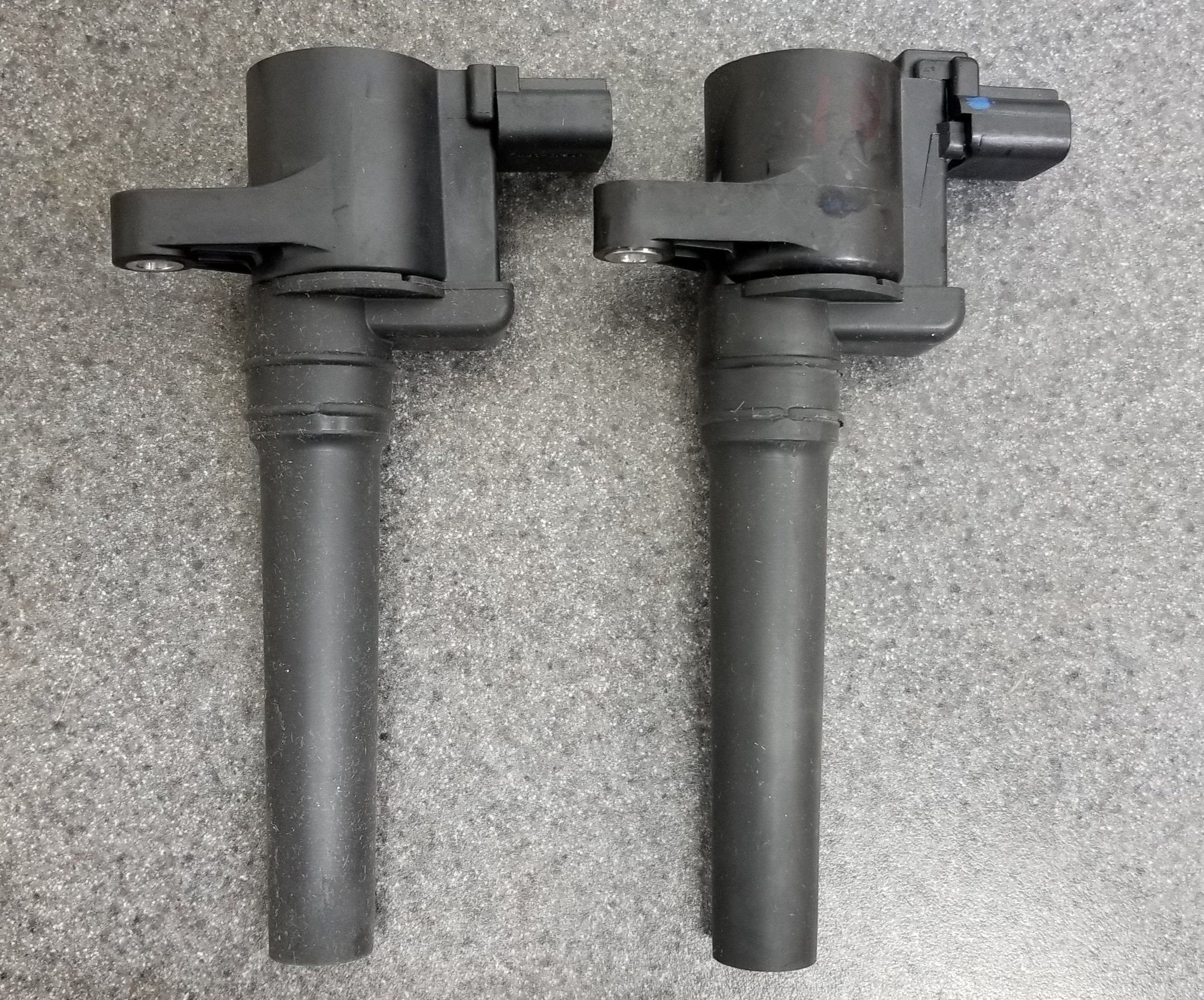

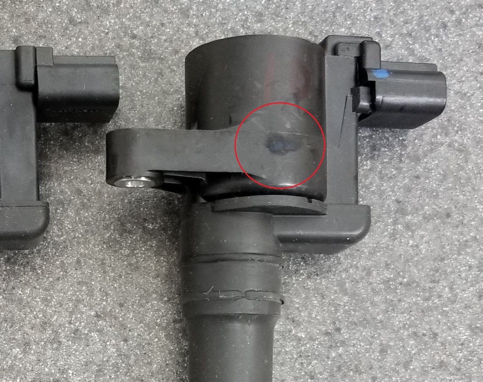

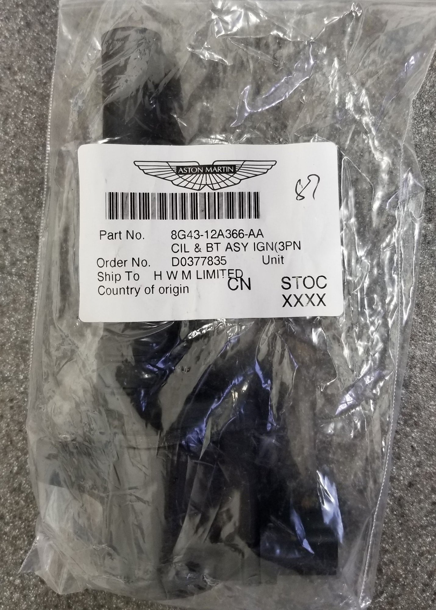

I'm not convinced OEM are any better than anything else out there...I developed the 'normal' misfire as soon as my V12V turned 30.5k miles. Not wanting to go through the process of removing intakes etc more than once, I went with OEM coils sourced from astonparts.com from the UK. Even with shipping, that was the cheapest option (in 2020). Imagine my dismay to find the coils in the Aston bags with "country of origin" as CN (China). Seems I could have gotten the $12 ones directly from China! (who knows, just kidding)
Looking at the pics below, you can see some discoloration on the side of the old coils where maybe some internal arcing was occurring.
New coil on left
check out the purple mark where the coil is from internal arcing?
I think this is the coil number (10 to be specific) which was written on it with a white permanent marker when new: heat overtime resulted in it becoming purple. My previous coils were all numbered as well similarly.

Actually not. The "10" is what I wrote on it with a fat Sharpie as I removed it from cyl #10. What I was referring to being purple was the spot below the 10, now with a red circle around it.
So, those ECZ-FR-028 coils are 2-pin or 3-pin? The German store (https://www.teilehaber.de/itm/zuends...c24674499.html) shows these as 2-pin in the pics. Will be interesting to see what, if any, durability differences there are to OEM ones, whoever the OEM actually is...
