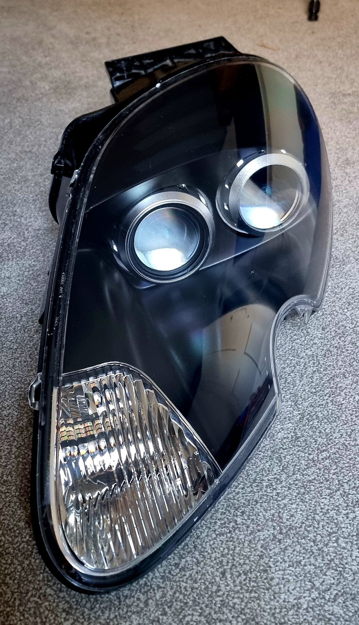

Ever since owning my 2006 DB9 i have been disappointed with the headlights, they are awful on both dipped and main beam and in my view bordering on dangerous for what is potentially a fairly quick car. I have tried different bulbs (Osram in the HID low beams, and both halogen and LED in the full beam) but with barely any improvement.

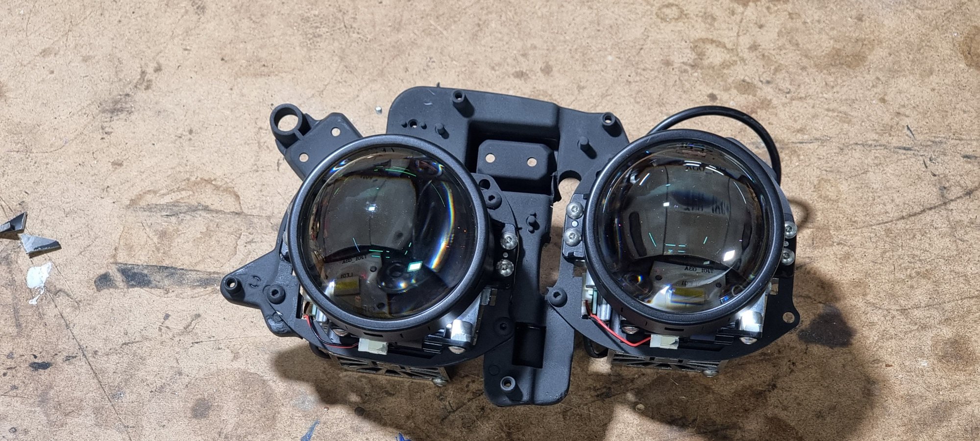

I decided to strip the headlights apart and completely rebuild them with 2 modern Bi-LED projectors in each light, so I now have 4 efficient lights on low beam and 4 on main beam too. The difference is astonishing; on dipped there is a brighter, broader more even beam with a very sharp accurate cutoff and the same on main beam with much more power and reach. The headlights still look absolutely stock (until you switch them on )
The stock adjustment still works as before and the auto levelling works too.
I also took the opportunity to replace the separate side/position and indicator lights with switchback lights as the indicators are not very visible when the sidelights are on too.

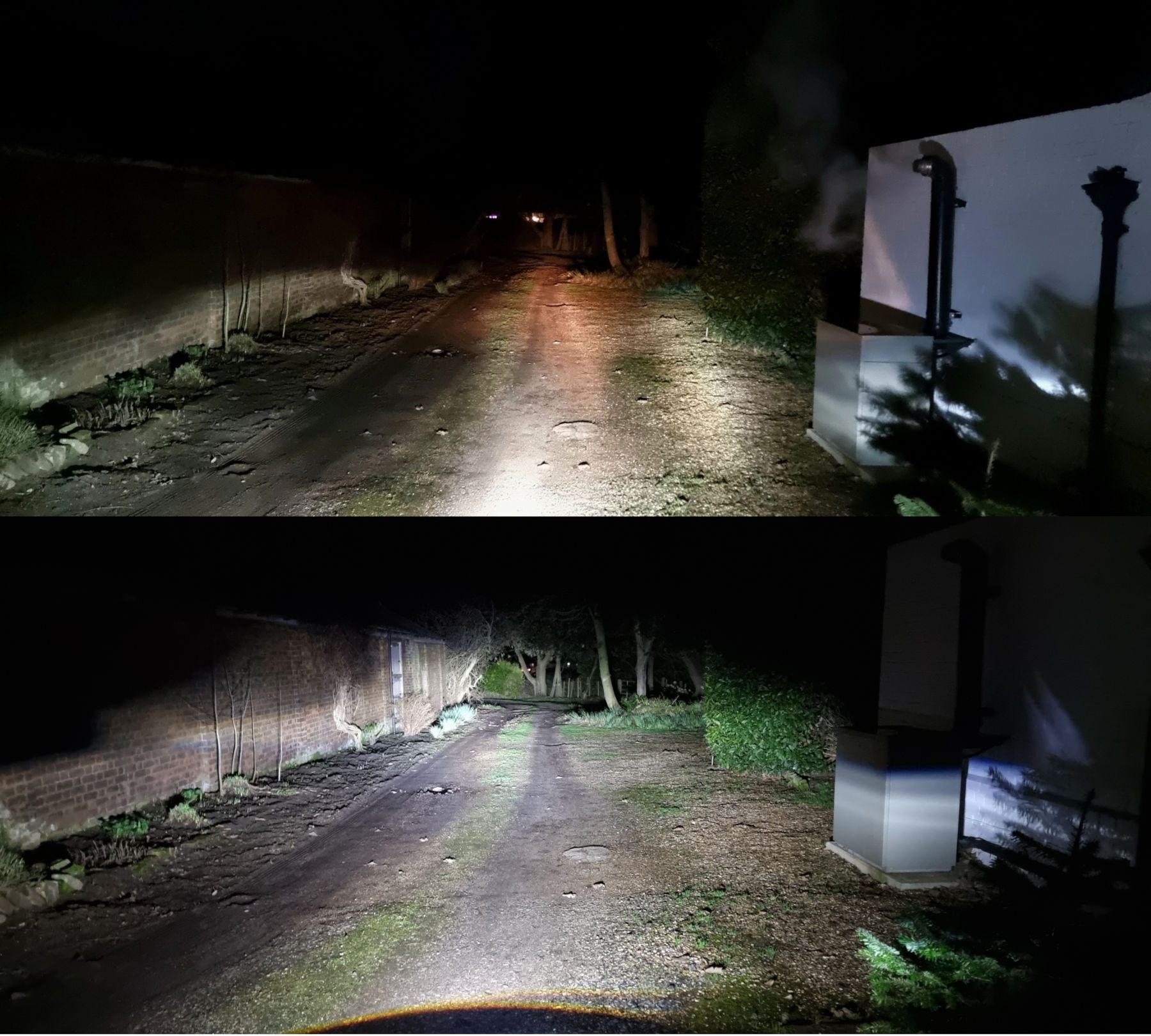

The images below are with just one headlight vs an original headlight with new bulbs
I now feel safe driving at night :-)
Dipped Beam comparison
Main beam Comparison
Orginal projectors
New Bi-LED projectors fitted to original mounting plate

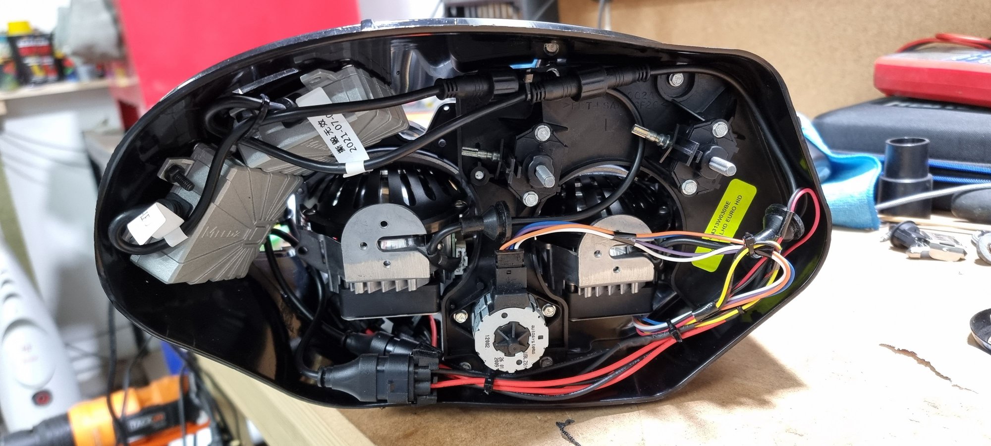

A bit more wiring needed
Still looks stock until lights switched on.

Quite a bit of measuring and cutting to fit the new mounting brackets - shown in the link

Nice work! love the write up too. It looks like work but fairly straight forward. Is the lathe for the low beam shrouding a must or is there potentially an alternative method to shaving it down for those of us without access to a lathe?

It would take a little longer but you could just use a file - only need to take a couple of mm of the plastic shroud.
