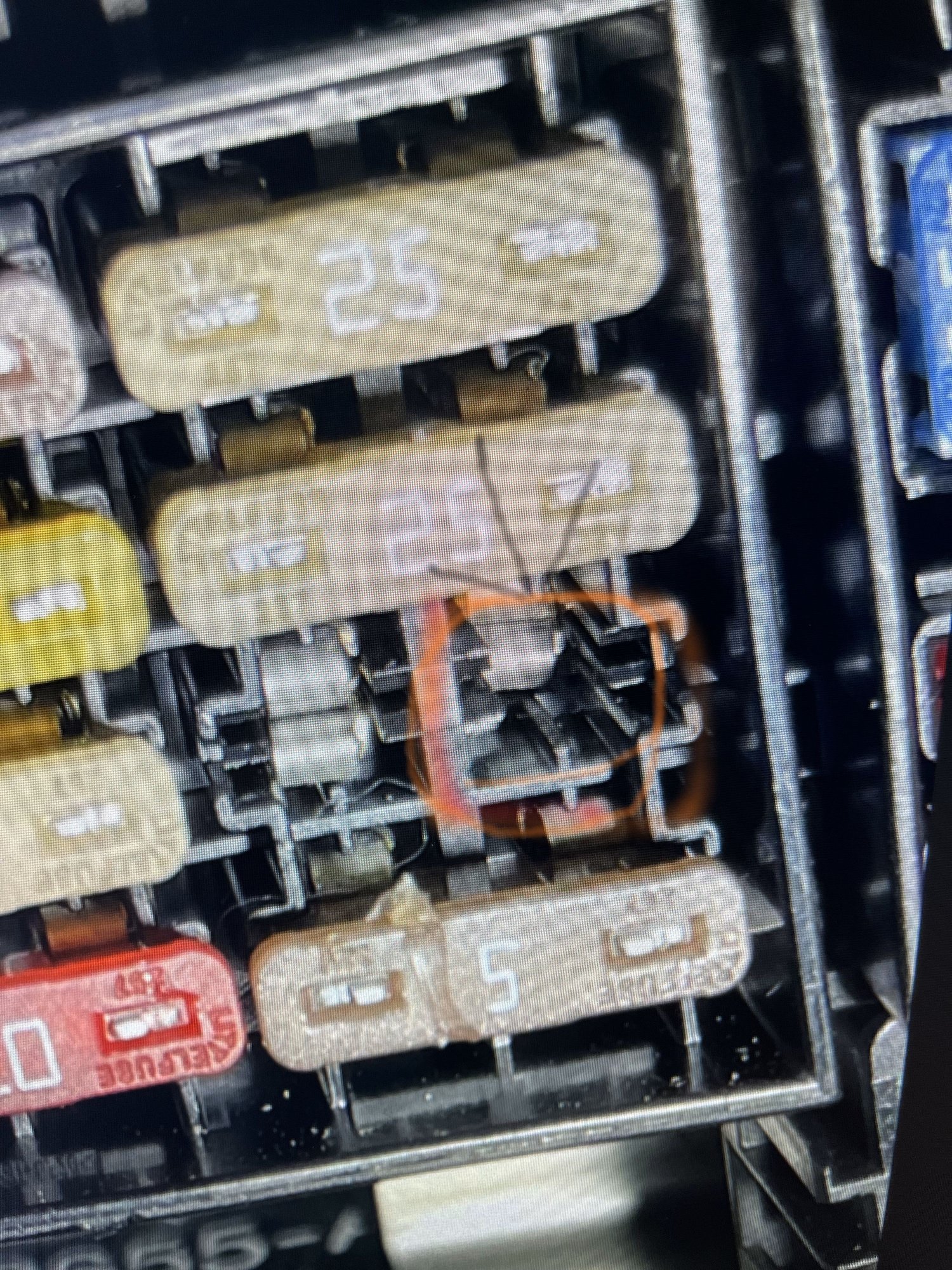

Update, fuse slot for center stack had a pin pushed back inward. It appears it was making sporatic contact with the fuse. Possibly from work done by someone under first ownership as the car had a history of display issues. Car reportedly fixed and I should have it back in a couple of days. Things are looking up.

Hi @Stwsam ,
GREAT NEWS!!
This kind of fault is the toughest one for dealer techs. They are trained to read fault codes, then replace parts associated with that/those faults. They have far less training in true diagnosis and fault chasing which often ends up to be cable/harness related. Not their fault, just how they're trained.
But, glad they got there for you. Hope you find yourself back in your fully functional car very soon!
