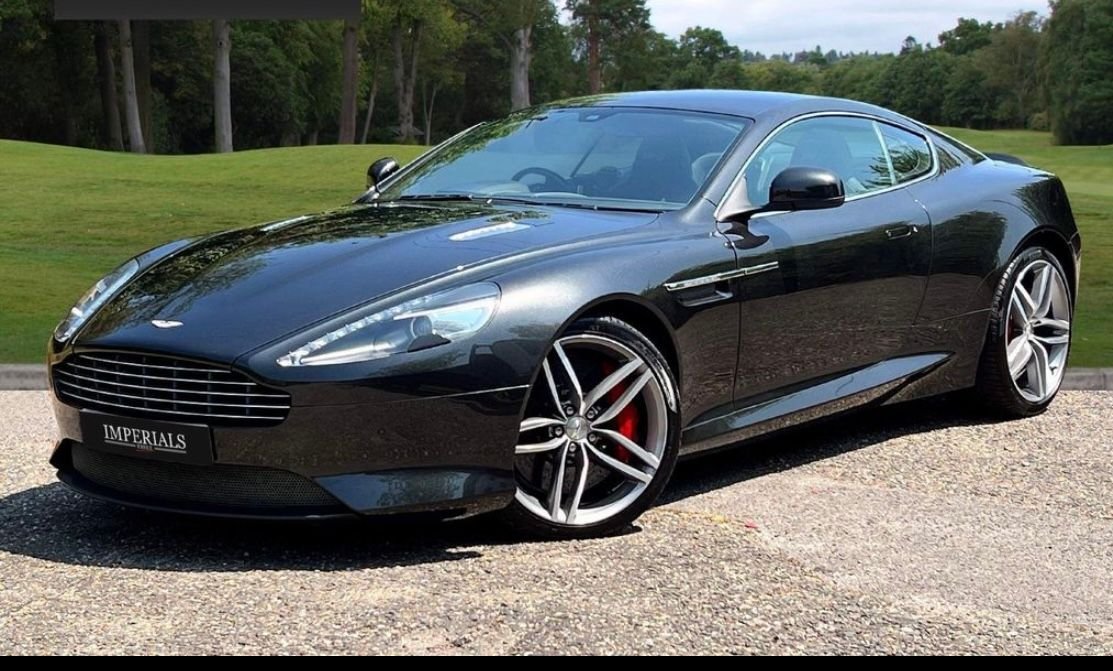

Here she is

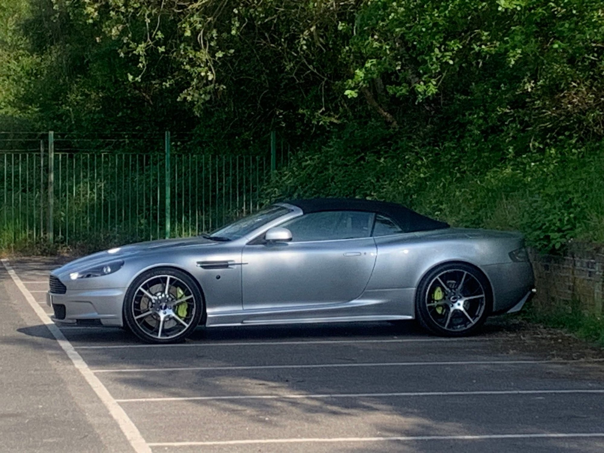

Thanks for all the replies, Much appreciated. Astonman1664, What do you have on your car? really fills the arches better.
Old Jun 21, 2023 | 10:32 AM
AstonMan1664's Avatar
Joined: Apr 2023
Posts: 42
From: Isle of wight
AstonMan1664 is infamous around these parts
Originally Posted by huesey1974
Hi,
I have AMS Edition 20x11 20x12 in the above picture
now I’m on 21x11 21x9.5
