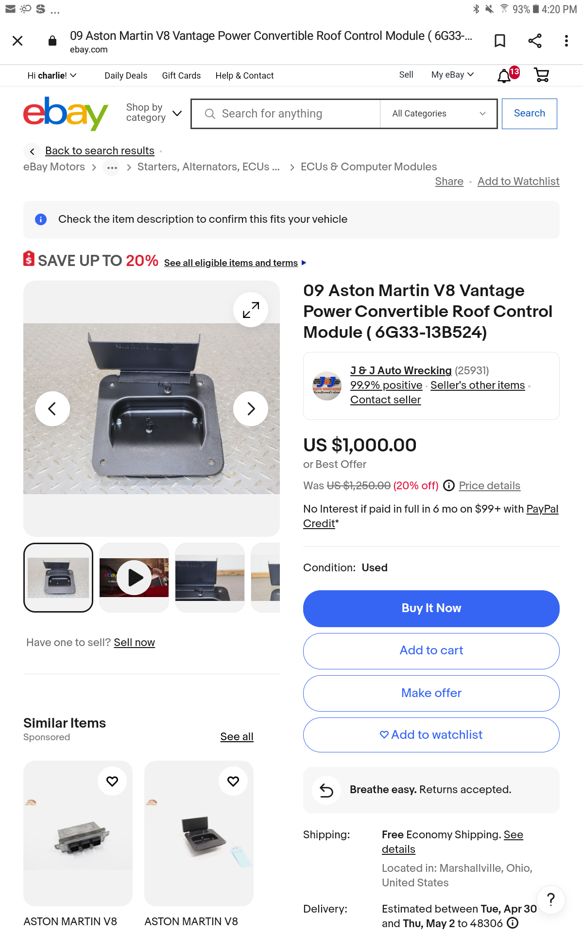

Ebay 1000.00. My 07 went thru 3 of these. The 3rd time I put it inside the trunk where the sportshift module and tire kit is. Easy access and less harsh environment.

Thanks all - ! Astonbits has one for about $1,000.00 as well. Charliefore, did you use this particular EBay seller? If not, I am leery about buying a part from them and, if for whatever reason it doesn't work......as opposed to Astonbits, which I would assume would be reputable to deal with.
