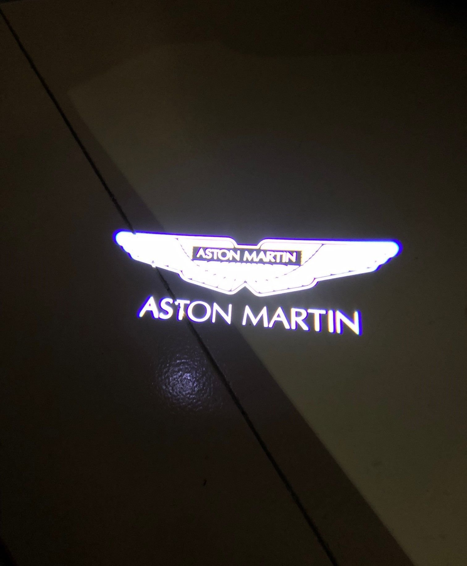

Was a snap on my DB11. It depends one which ones you buy. some of them are generic and require a hole to be drilled in the door bottom to mount the light housing. Others are a direct replacement for the factory light and are plug/play which mine were. Mine were about ten minutes total time to install.

Looks cool!
Where did you find these?
