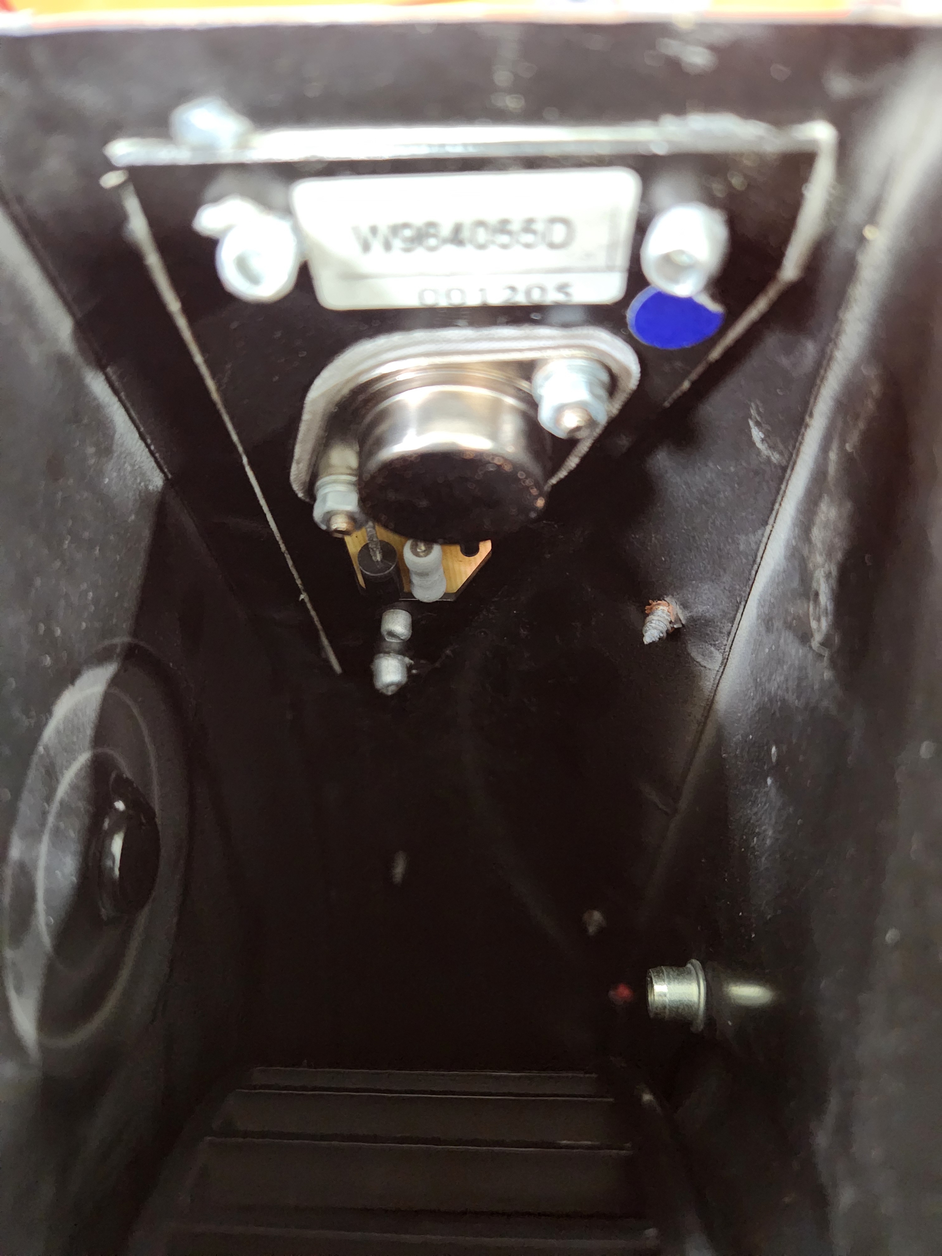

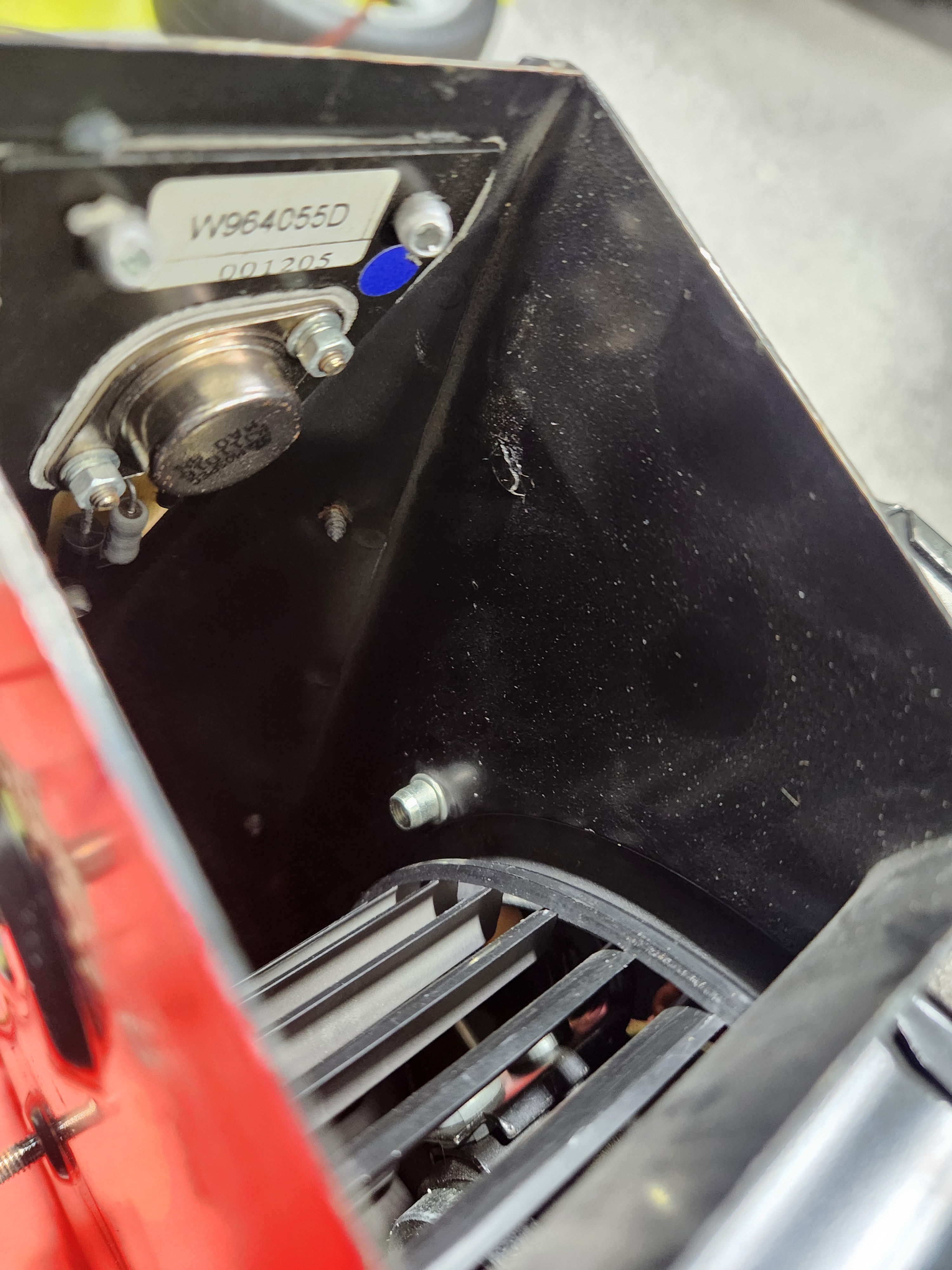

Here is a picture of the transistor inside of the blower housing. I have this LH blower assembly that is in good condition and works if interested.
