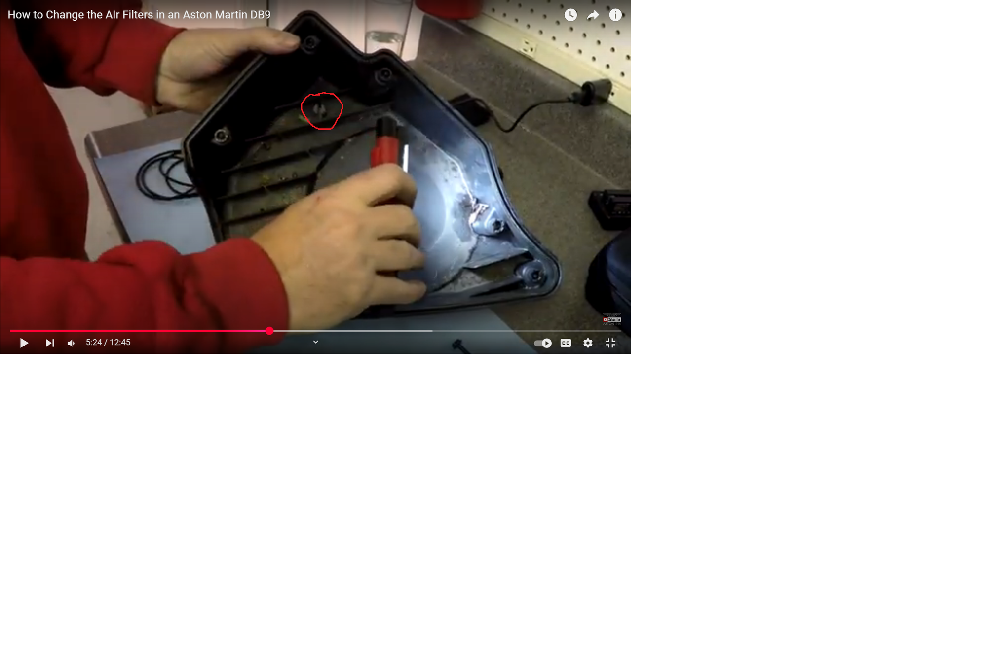

Hello all,
i just finished the service, i could finally changed the 2 air filters, i had to remove the under tray, even twice cause i forgot one screw...anyway. I well cleaned my air box and update each seals, and filters.+
i have a question underneath the air box cover there is a white plug in plastic kind of floating there, not really tight etc...i am wandering why all these efforts to make the air box so tight for air leaks if the air can get it through this white plastic plug, it seems like a screw shape but its in plastic. do you know what i am talking about, should it be right on top and not floating, then i will need to order new ones, its a plug that at the end there is 2 sections you can spread to make it hold better but it hasnt work well for me, it seems its floating there if you pull it will goes out,,,whats the deal with these white plugs? thanks all. i should have taken a picture. i did like 5 small videos.
any response thnaks a lot in advance....it took me 5 hours.
i put back the 7th screw of each airbox but i was thinking not doing so, when i see the air can enter from this plug i am talking i think i could have avoid screwing back the 7th screw so next time i can do it without removing the undertray.....what do you guys think?

sorry i m using his video images to show you which plug it is, i think it should be on top not loose as mine....

That white plug is supposed to be a one-way valve to let water out in the case it's drawn in through the grill intake, but not let it in if you drive through a deep puddle. The only part of the airbox that's truly important to be airtight is the filter to airbox neck and the airbox neck to the MAF tube. All the rest is dirty air anyway.
I've heard that some have drilled an access hole in the undertray to access the obscured screws in the airbox. There are a couple from the factory in mine that reach other screws, but none for the airbox. I'm usually changing the oil when I do the air filters anyway so it's not a big issue.

Yes my tube and filter are well set up thank you. I had to redo it the maf tube was pinched.
"There are a couple from the factory in mine that reach other screws"
Sorry I didn't understood this .
Thanks for the plug infos....mine is too loose on one side ...so it's not good to stick it back then I will see a next time. Thank you.
Very glad I could finish it. i will clean the air maf sensor next time and take care of this plug.
yes i am hesitating to drill holes and i could, i think i could avoid screwing the 7th screw, as i could see some air may come in from this plug, it will make no difference not screwing back the 7th screw....its dangerous with my floor that's why.

I was trying to say that there are a few holes in the undertray near the airbox that allow access for other screws, but none near the airbox to allow access for the airbox screws. I've heard that some people have drilled additional holes to make airbox access easier. I'm not really interested in doing that on my car, but it's certainly an option if you think you'll ever change the air filters without removing the undertray.

Originally Posted by manuel2171s
Thanks for the plug infos....mine is too loose on one side ...so it's not good to stick it back then I will see a next time. Thank you.\
The valves are supposed to be loose and floating. If you secure them to seal them up and drive in the rain you'll fill the airbox with water and water will be ingested into the engine, destroying it. If you leave the valves out and drive through water deep enough to dip the airbox into the water, you may suck water into the airbox through the hole. Doesn't matter if you don't plan on driving in the rain, you should address the valves so they serve their correct function.
Congratulations on finishing the service! The first one feels like a pretty huge accomplishment!
yes sure its lacking on mine, i think the airbox were placed a bit inclined or off, and its not that they have moved, its done like that, from what you are saying i could skip the 7th screw. no big deal then if a bit of air get in there and i don't even think it will....
its good then to have these valves for rain, i didnt want set another filter for this reason its important, cause you never know when the rain will trapped you....

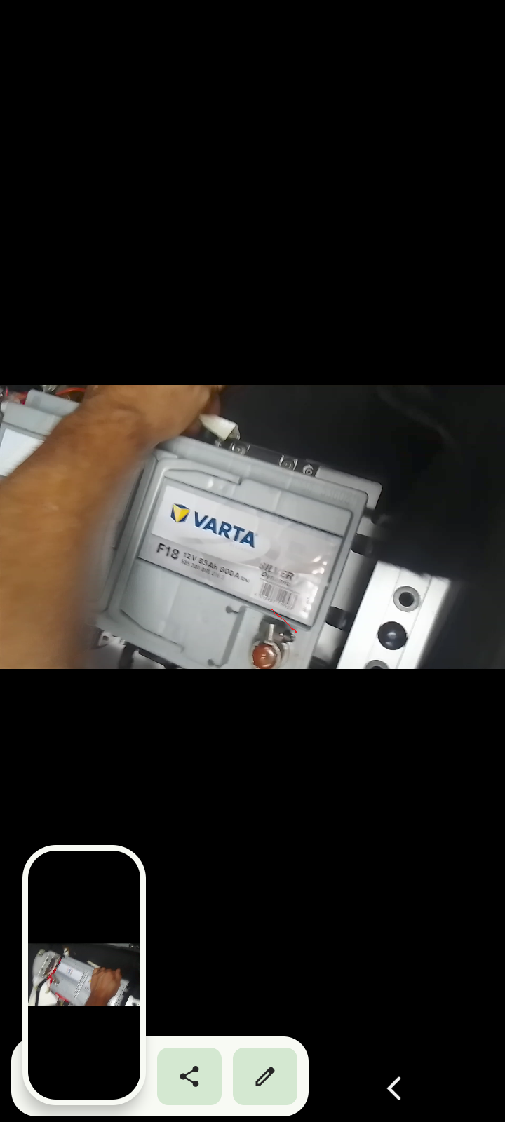

with this beam i may end up with 29 cm clearance on the front and 20 cm around the end of tray only. i finally received my f18 varta battery only 31,5 cm long but it should be ok. and i got my motor coolant to be changed soon when i got the beam ready to work.
