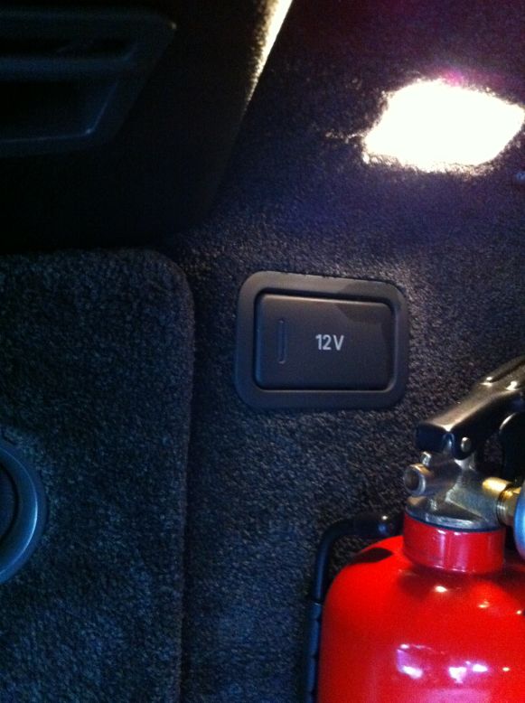

Hate to bring back such an old thread. But which one is the main battery and which is the aux battery on a '08 Flying Spur?

If it is the same as the CGT, you want to hook it up to the left side battery (the driver's side USA spec). On the CGT you see a 12V 'cigarette lighter type' jack in the trunk on the same side for the charging unit to plug in. Hope this helps.

Thanks for the response. I have a 12v cigarette light type jack but not the charging plug. I guess I can get the CTEK charger with the clamps and just go directly on the battery terminals.

Can you use the cigarette light socket in the trunk to use as charging port if you can custom make the male connector with the ctek??

ctek sells the cigarette lighter plug.

Great! Now I have to check if the lighter socket still works when the ignition is off. Thanks

just letting you know the lighter socket works even when the ignition is off and it could be used with the lighter socket to charge the car!
i just got the ctek 7002 and works great, but didnt try the lighter socket yet.

Quick question on this issue.
I have a 12v flip out connector on the left side by the battery on my car. However, when I compare official pictures it shows a direct plug in connector.
So anyone tried the 12v socket with a cteck to recharge your battery?
