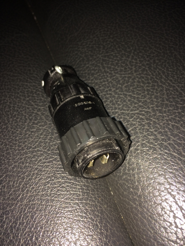

Found it! 206426-1 is the part number for the AMP connector for those who may require it.
PM me your address and I will post it out for you, glad it can be put to good use.
Thanks

J, thanks for the offer-- that looks like the part with two small male prongs. I solved my problem by cutting off the wires in back of the female connector on the panel covering the battery compartment and threading the wires from the battery charger through the hole in the connector and splicing and soldering them to the wires from the battery. Now the connection is via the quick connect that came with the charger instead of the female plug on the panel. Works fine and even seems easier. Thanks for your advice --I look forward to communicating with you on this forum.

No worries Bill.
As long you managed to find a way to hook up your Ctek all is good.

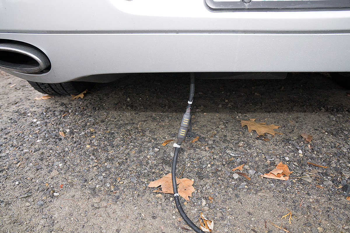

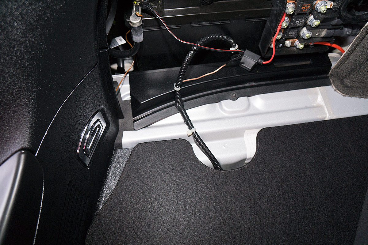

One day i'll post CTEK 7002 install photos. Basically, I extended the cable of the connector that attaches the inside left (driver's side USA) battery.
Battery --> 6 inches of cable to fuse (keep this cable short, fuse is MANDATORY!)
Fuse --> 4 or 5 feet of cable (soldered wire extension and heat shrinked) all wrapped in wire loom that goes from the trunk to the left (driver side USA) rectangular opening underneath the car (diffuser).
The end connecter wire loomed part will hang about 3 inches under the car freely yet will NEVER touch the ground. For 'storage', it can be attached INSIDE the rectangular open section of the rear diffuser via strong Velcro. Thus easy to attach /detach from the outside and if I forget to detach, the cable will easily detach itself without harm and will never touch the ground whilst operating the vehicle.
Lastly, about four times a year I clean the end connectors with Caig Labs DeoxIT D5 via pipe cleaner because the stock CTEK connectors are not gold plated and thus prone corrosion.
WARNING: Do this at YOUR OWN risk. If done wrong, or if something goes badly, the fuse may blow... or worst case scenario the car burns to the ground, sets your home on fire since the car is in your garage, which in turn sets your neighbors home on fire, eventually burns down the entire city....

Images step by step per se....

More pics......

Please be kind to me when I expose myself. Metaphorically Why can I not use the plug in the boot to charge? Why take the risk of igniting the planet for charge of the car? If did a risk vs. reward analysis would it come port skewed badly?

We're all obviously over-thinking this. Of course use the boot jack, it works great. I wanted something different, that's all. Plus if I forget to unplug, no harm no foul BTW, I also have that weird jack too inside, yet didn't want a cord always being crushed by the trunk gasket.
Whatever makes you a happy-happy joy-joy guy Dr D is great.
It's all good
This is the only reason I could see so I just let the boot come down and rest on a towel without letting it power close.
