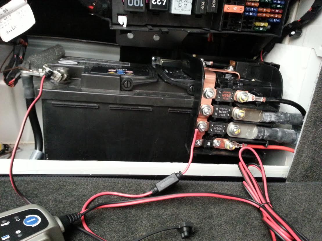

Hi guys, i was going through the DIY pdf file and i saw no instructions on how to replace the two batteries. I need to replace the battery on my driver side. I was quoted $700 at the Symbolic Motorsports here in La Jolla. I was thinking to my self that $700 seems just too much to replace one battery.
I kind of searched around and found that Autozone carried AGM batteries and i was looking at H6-AGM battery to replace it with. Is this the correct battery size? If not, can someone recommend me one?
Also is their a DIY on replacing the battery? I think this should be something very easy to do but their are too many bolts and don't know witch ones i need to take off to get the battery out.
While replacing the battery, i was thinking of bridging the new battery with jumper cables so that i won't have to reset any of the settings because they are also not mentioned in the DIY.
if someone can point out and circle the correct bolts i need to take off on the attached picture in-order to remove the battery would be awesome.
Name:	bentley battery.jpg

I changed out both batteries in my 05 GT. Pretty straight forward if you're at all mechanically inclined and have the tools. The biggest issue is removing everything to get the batteries out. It takes time. The trunk liner on the left has to be partially removed as well as all the wiring harnesses on both batteries. Finally, you have to reach down inside to remove the hold down brackets.
When everything is loose do some warm up exercises to get prepared to lift out the left battery. It weighs a ton and has to be lifted up and then tipped towards you to get through the opening. Then just reverse the procedure. The whole process for both batteries will take about an hour and a half. I do not remember losing any settings.
To make sure I got the correct batteries I took mine to my Audi, Mercedes, BMW dealer to make sure I had the right ones. The right was an Audi and the left was a Mercedes. They had higher ratings than the Bentley batteries.

Just did both batteries on my Spur, the OEM batteries are VW parts, here are the part numbers:
Main battery: 000 915 105 CE $220
Starter battery: 000 915 105 DE $139
Bentley dealer wanted over $1k for the same parts
