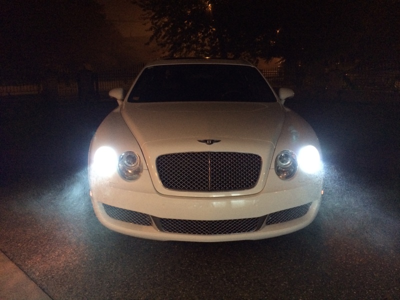

Update:
Since the Passenger side bulb was already fused (no errors on dash), I decided to just have the drivers side removed. When the car was in for an oil change I had the tech see if he could reach it (I tried but couldn't get my big hands to fit) He gripped the bulb in about 10 seconds, but couldn't remove it, he wiggled it around and it fused! Which worked for me
