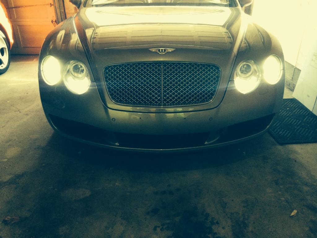

Today I accomplished this bulb change. It wasn't easy but after about an hour I got it done.
I first took off the rubber intake pipe on both sides. Then after fiddling around I figured out how to pop off the cover where the bulb lives. Simply push in a tab on on one side of the cover and it pops right off. The passenger side was much tougher to get off since its a smaller space and there is another smaller plastic hose that get in the way.
Changing the bulb to LED was straight forward but did take some fiddling around. Again, very tight space esp on the passenger side.
Putting the cover back is extremely tricky. I was about to not even but them back on. I got them back on but not a perfectly, but its better than nothing I guess.
here is a picture of the finished product, its hard to tell in this pic but the new LED is much "bluer"
[IMG][/IMG]

[QUOTE=eyceburg11;4097004]Today I accomplished this bulb change. It wasn't easy but after about an hour I got it done.
Boy you are a better man than I am.
I fought this thing for 3 hours today with no luck on my 2009 GT. I took off the intake hose but could not get a socket on the hose clamp at the bottom of the hose. I took off the front engine lower cover to get access from the bottom. Still couldn't get it off because the antilock brake value was in the way. I am only 160 lbs and have small hands but there was no way to get at it!
Help
Kim
