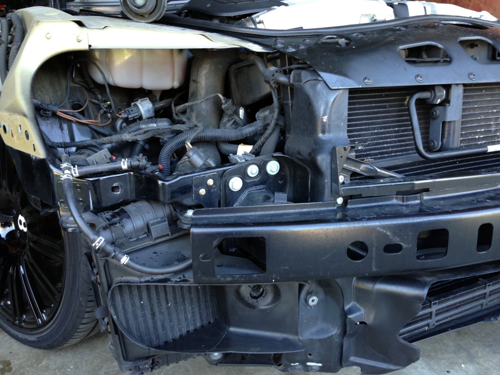

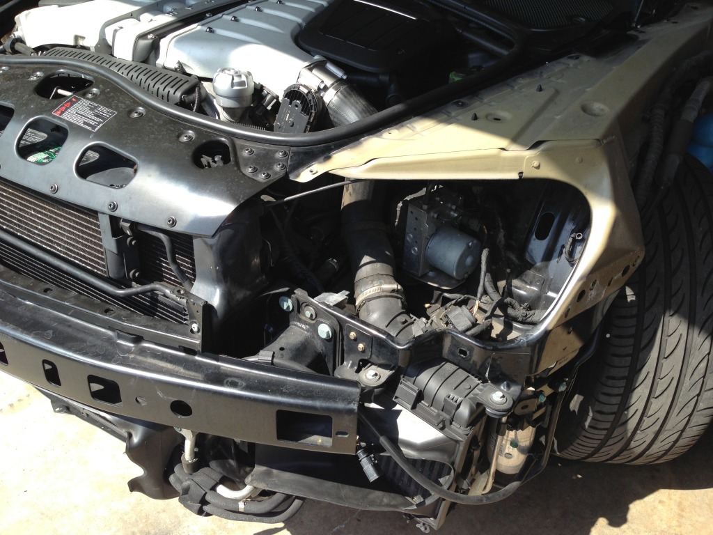

Here is a shot for reference of the space behind the headlights. Very tight.
[IMG][/IMG]

BlackGTC, thanks for posting pics. Interesting to see what is behind the bumper.
Very Welcome ETM! Im also working on a headlight project which has mushroomed into intake hose replacements (upper and lower) and minor detail work. Could not believe how brittle and worn the intake hoses were. Some areas of the hoses seemed soft enough to push a finger through. Def inspect your rubber intercooler hoses.
