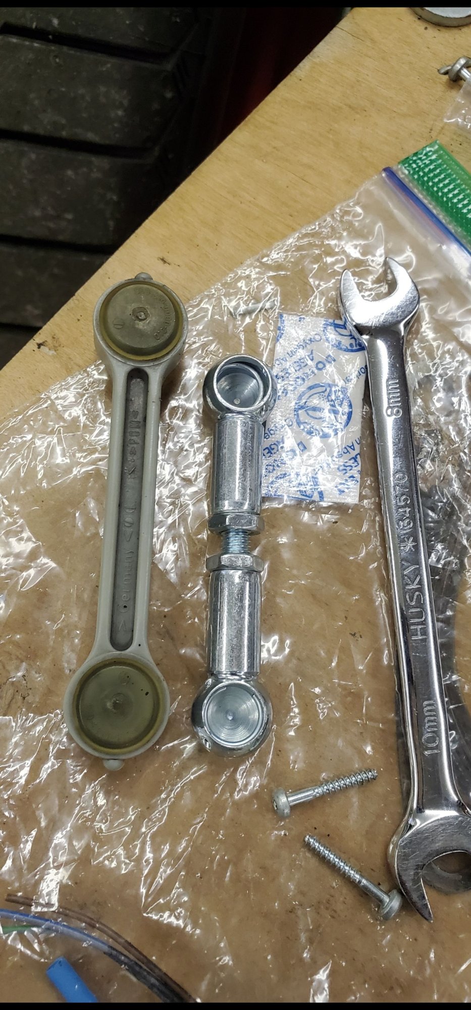

​​​​​​Hello @sazam ,
Yes, the suspension can be lowered by using the Ross-Tech VCDS, it can also be lowered by way of installing lowering links alone, or as I did, I lowered it with RT VCDS, and gave it the final touches to bring it a bit lower by installing the lowering links as pictured below, as the RT or any software can only lower the vehicle so much, as the values would be out of the allowed ranges.
You can see with my stock 19" wheels with the 275/40/R19 tires at the stock height, and then the red 20" wheels with 275/35/ZR20 tires lowered with RT, it still was a bit high for me, then the pictures with the red wheels and the lowering links installed.
STOCK 19" WHEELS, STOCK HEIGHT.
20" RED WHEELS LOWERED WITH ROSS-TECH.
20" RED WHEELS LOWERED WITH ROSS-TECH AND LOWERING LINKS
LOWERING LINKS
TIRE SIZE COMPARISON, MY TWENTIES ARE ACTUALLY A TINY BIT SMALLER THAN THE NINETEENS.
Johnny

Johnny - thank you. The bended links are for front and the stright are rear?
btw - can you give me any example web link to store with this links?
Old Jan 24, 2023 | 12:15 PM
Johnny Hotspur GT's Avatar
Administrator
Joined: Jul 2014
Posts: 3,956
From: Montgomery NJ
Rep Power: 1002
Johnny Hotspur GT Is a GOD !Johnny Hotspur GT Is a GOD !Johnny Hotspur GT Is a GOD !Johnny Hotspur GT Is a GOD !Johnny Hotspur GT Is a GOD !Johnny Hotspur GT Is a GOD !Johnny Hotspur GT Is a GOD !Johnny Hotspur GT Is a GOD !Johnny Hotspur GT Is a GOD !Johnny Hotspur GT Is a GOD !Johnny Hotspur GT Is a GOD !
@sazam ,
My responses in red.
Yes, as shown in my pictures.
