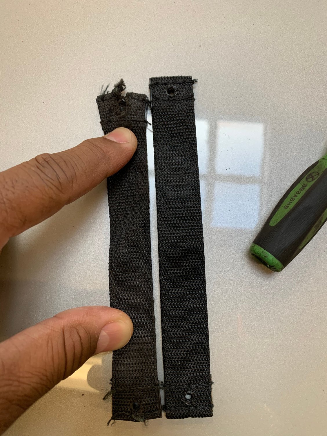

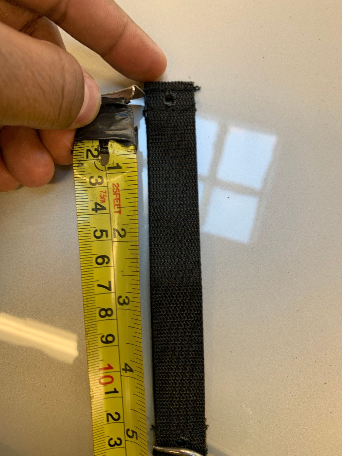

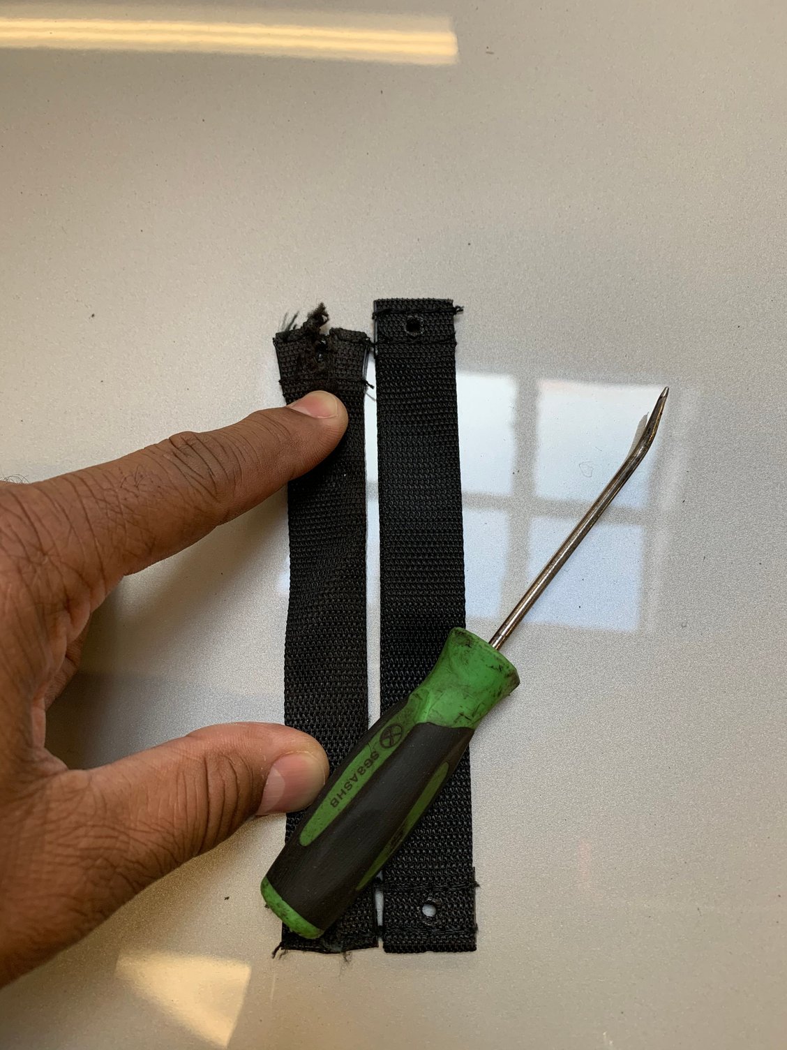

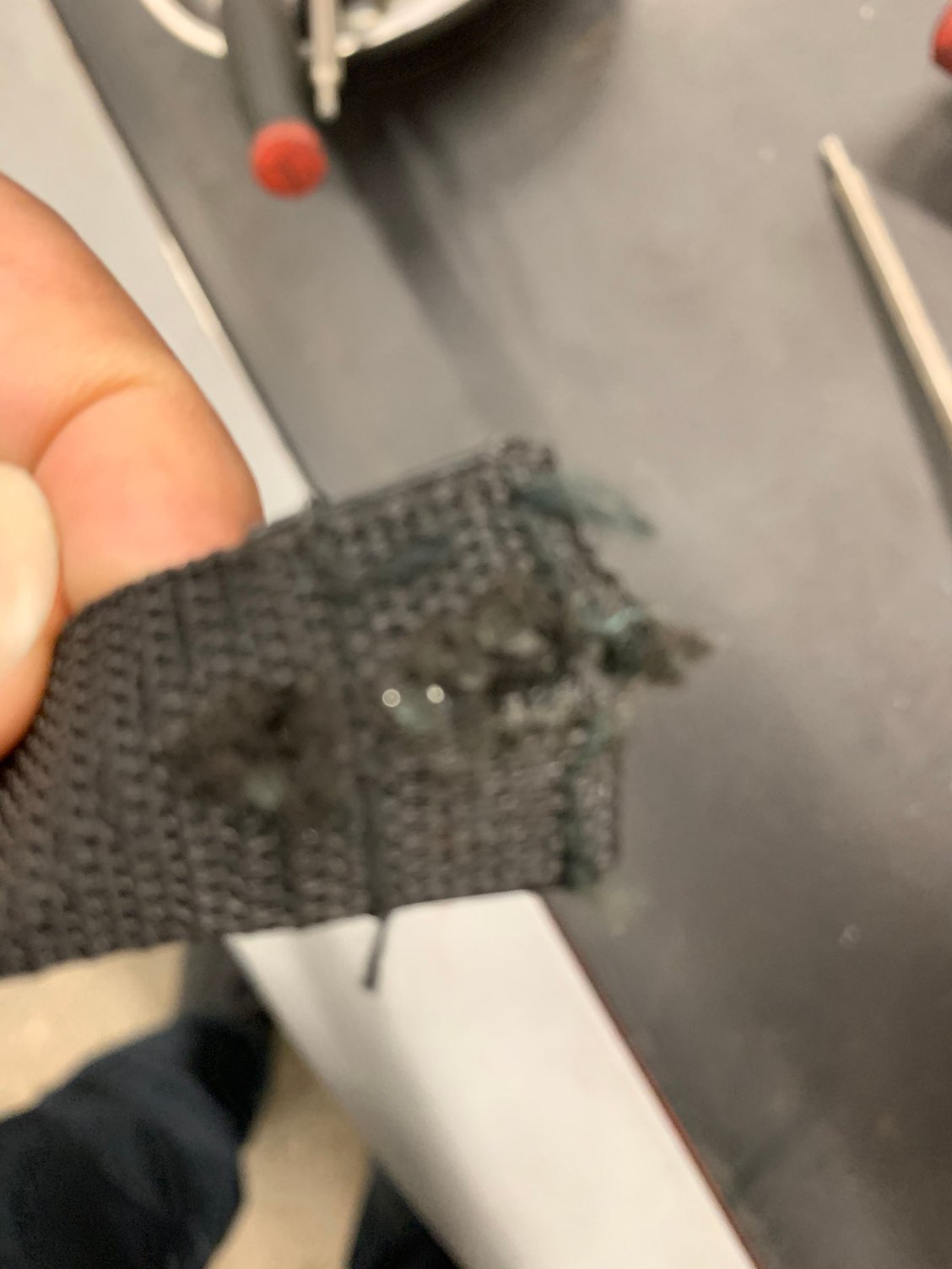

Update!!! ok it wasn’t my frame position sensor it was the 2 straps on both sides that broke. The stapes pull up the rear tonneau cover compartment. Bentley has a repair kit part number 3W7898025 and they know this is a common problem on all gtc cars. The original straps that came with the car are smaller than the ones in repair kit. I think they made them to small in the original design, because those straps are under a lot of pressure so it’s a accident waiting to happen. Bentley should have recalled all gtc cars to fix this issue. Now that i fixed the problem, I still have 2 small wholes in my roof, when the straps broke it popped 2 wholes in my top. I just put a patch on it for now.I’ll buy a new top if I keep the car. Check out pictures below.

Yes, its the same thing every time,. The rivet corrodes and fails causing the strap to tear and thus the hood gets trapped. Sorry to see the ugly patch on your roof. If you want to cut a corner on the expense of an entire replacement skin, you can have an upholsterer glue a much larger triangular patch to both sides. This gives the impression its meant to be like that and can save you a small fortune.

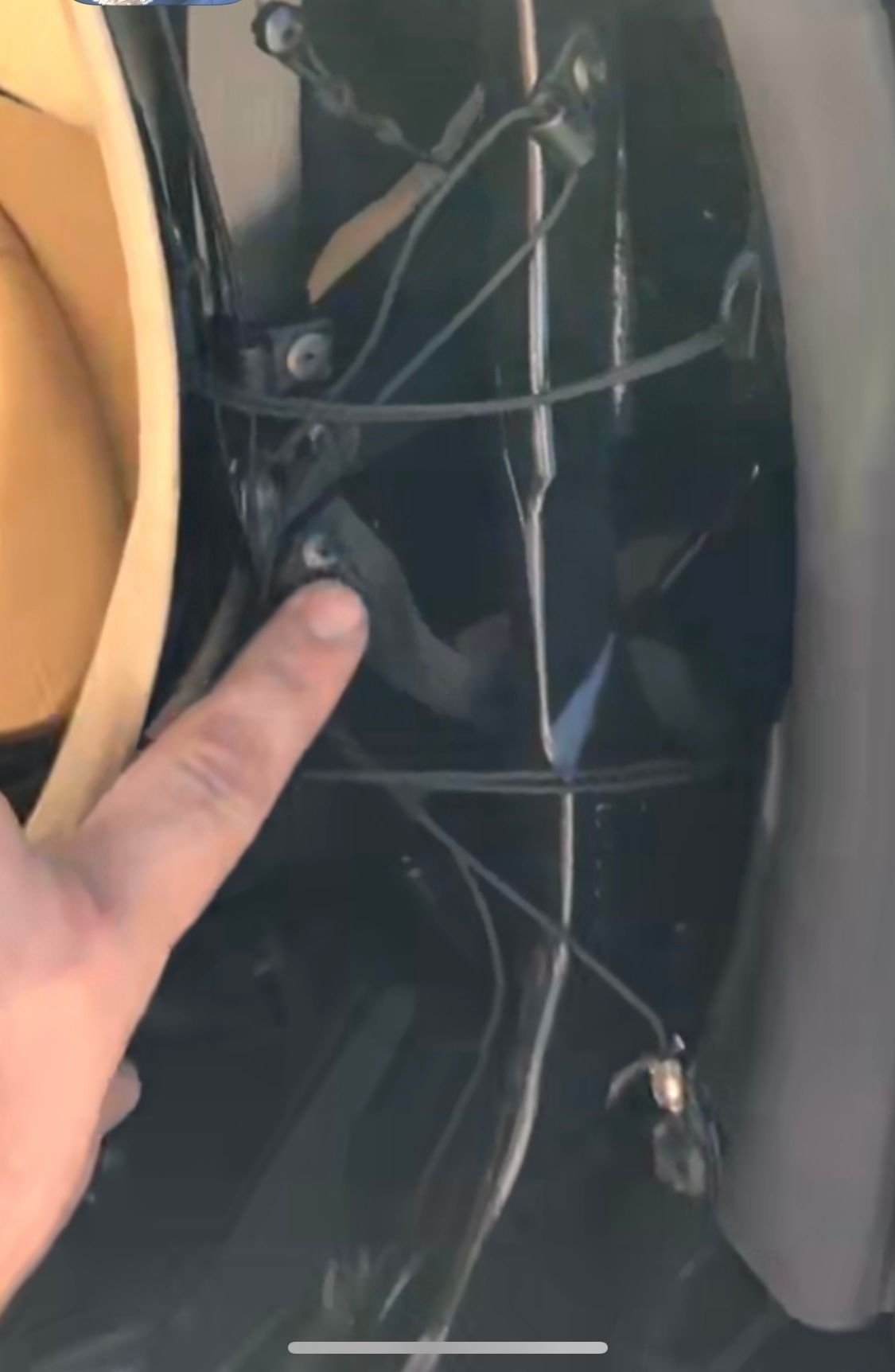

Had the same problem with the fault code G356. Opened the roof to the "stuck" position and located the sensor (behind driver side seatbelt mechanism). The arm of the sensor had come off and thus the computer couldn't read its position. There was some black tape around the sensor holding it in position that had come undone. Reset the arm in the appropriate hole and re-taped the sensor to its mount. Opened and closed the roof. No Problem. Fault code automatically cleared.
