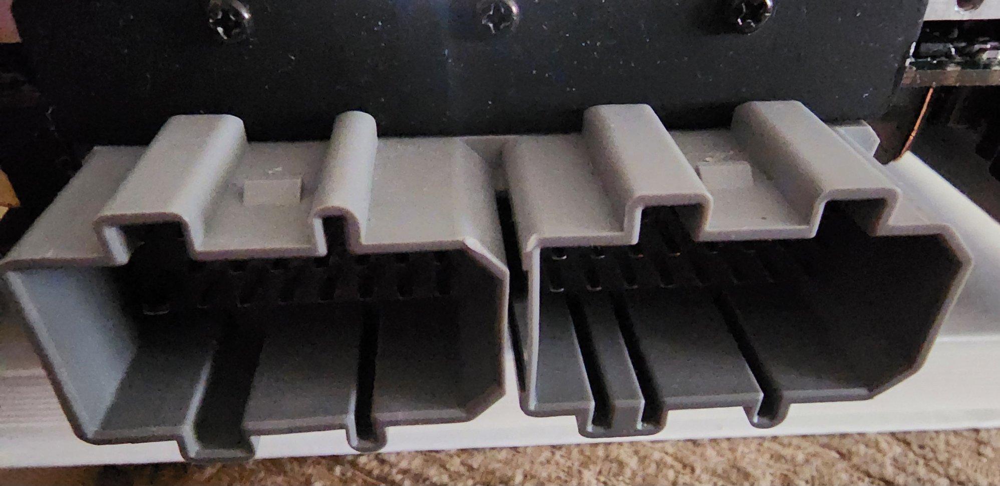

Hello @kma ,
As I said in post number 37, unplug the 6 pin power plug at the amp itself, then install 3 new 20 amp fuses at the fuse box, if they don't blow, then the wiring is good, and the fault is inside the amplifier, be sure to set aside the 6 pin plug as to not come in contact with any part of the vehicle's body (ground).
DO NOT ADD STRAIGHT POWER TO THE AMP'S +/- PINS WITHOUT FUSE PROTECTION !!
You will cause further damage, ask me how I know, the amp I previously posted pictures of above, was not working, so I opened it up to inspect, and I thought let me add the power while opened and test the circuit board at the power solder points for current, well, as soon as I added the power, the power transformer on the amp started smoking, and then I saw the blown mosfets, so best just to verify the power from your fuse box to the 6 pin power plug is good, then you know it is inside the amp causing the 3 fuses to blow.
I may attempt to repair my spare amp myself, now that my micro soldering has gotten better from working on ecu's and such. 😁
Johnny
Last edited by Johnny Hotspur GT; Nov 5, 2022 at 06:33 PM. Reason: Spelling, and add pictures
