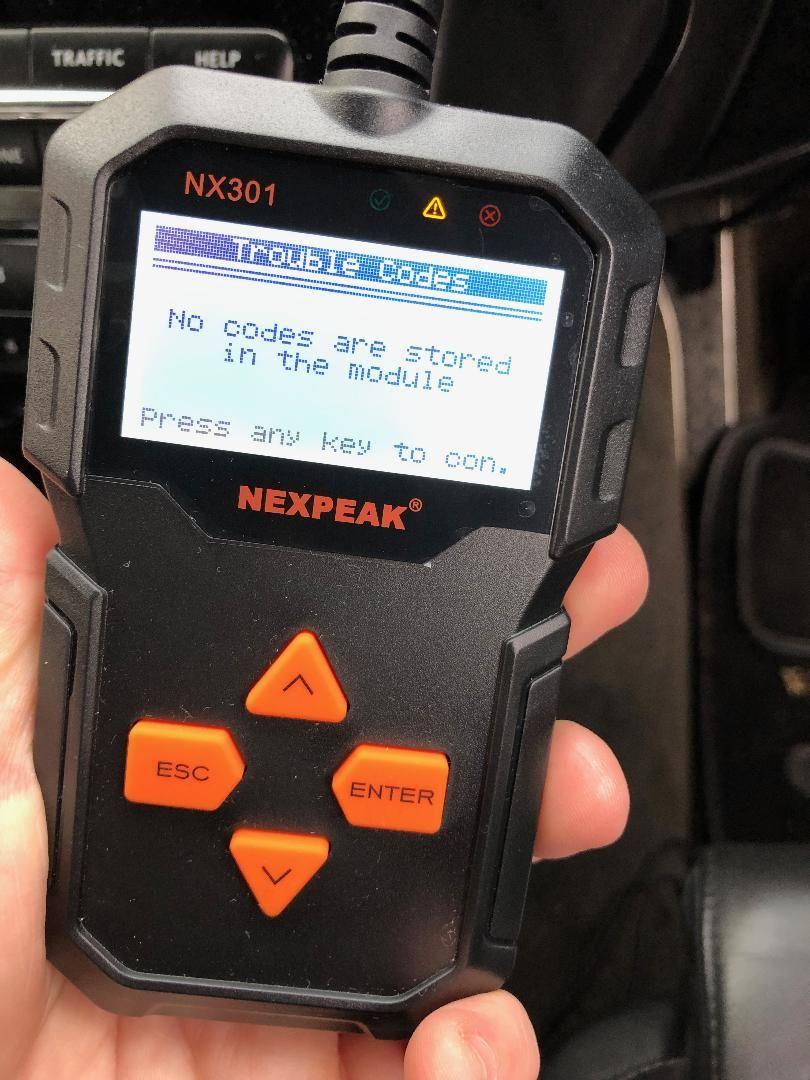

So... Amazon order of OBD2 reader arrived yesterday ( thanks for the advice ). Plugged it in today and this was the result :
Did the reset anyway. Light went out.
Went for a drive..... all well.
Parked up and ran some errands. An hour later returned and headed home. Light back on!
Car is driving perfectly and pulls like a train. Idle very solid.
Guess I keep resetting for the moment?

I am not sure on that $20-$40 scanner properly reading your Bentley, the norm for our vehicles is either the Ross-Tech VCDS, or a VAS 5054 with ODIS.
Did that scanner show you both engine modules #1 and #2 to choose from for scanning ?
Being you had the light on, the proper scanner would show you the fault, yet you picture shows no fault, does that scanner do a full scan, or just one module at a time that you have to pick which module you are scanning ?

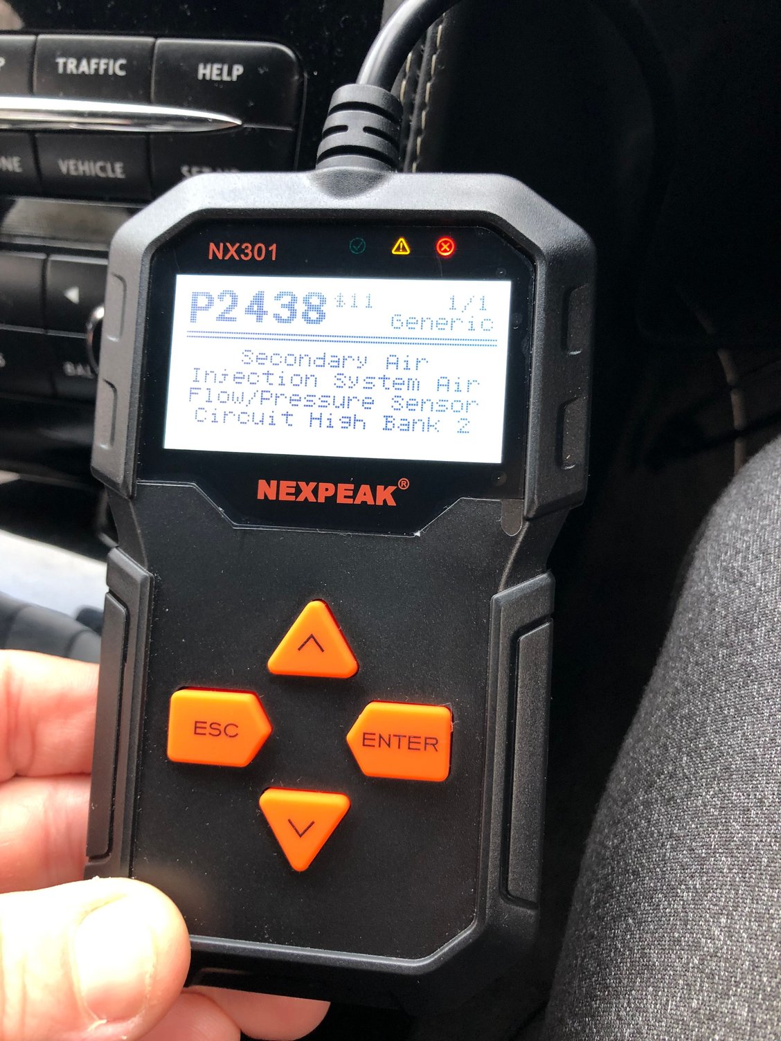

Hi Johnny- thanks for the links. I’ll have to get a better diagnostics. I’m a bit new to this but have managed to further interrogate the simple scanner I purchased and it has come back with the message I was expecting- which is still the same as the code I got before the EGTS was replaced....
I reset it and all fine after an initial drive. Fired it up a little later and the light was back on...
GT is running great so guess I will just earmark the vacuum leak repair at next service time in 3 months.....

Thanks both! Have now seen the link and ordered the part.
