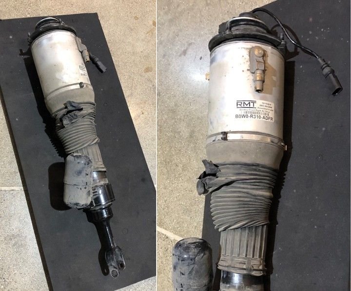

Wow! and here I thought I was the only one. Image attached below. Point of failure seems to be around the same location on both of our struts. Now, couple that with RMT's horrible customer service! From my personal experience with them, I think they're running a very shady operation and it's only a matter of time until the law catches up with them. I'm not sure if they already know this but their shoddy product is going to get someone killed sooner or later! I was fortunate enough to be pulling into my driveway at minimal speed when the suspension gave up. Imagine that happening at 70-80mph?!?!

[QUOTE=pupdogg;4857722]Wow! and here I thought I was the only one. Image attached below. Point of failure seems to be around the same location on both of our struts. Now, couple that with RMT's horrible customer service! From my personal experience with them, I think they're running a very shady operation and it's only a matter of time until the law catches up with them. I'm not sure if they already know this but their shoddy product is going to get someone killed sooner or later! I was fortunate enough to be pulling into my driveway at minimal speed when the suspension gave up. Imagine that happening at 70-80mph?!?!
Yes totally agree very dangerous..I was actually driving around 50mph when it popped..was unreal..had to pull over immediatly..then when I call them they are like ohh no prob we will send out a new one! I’m like aren’t you the least bit worried why and what happened?? Of course I did not take up their offer of a new one..I asked for a refund. They are a complete joke of a company..outright dangerous
Its a few threads on here about them including mines. They tried to play the long game with me on my refund so I disputed it with my ccc and they reversed it quick. Sold me a pard that would fit BUT wasn’t rated for the car (cv axle). With the help of this board I was told that the thickness wasn’t the same because we have twin turbo and the Audi does not.
