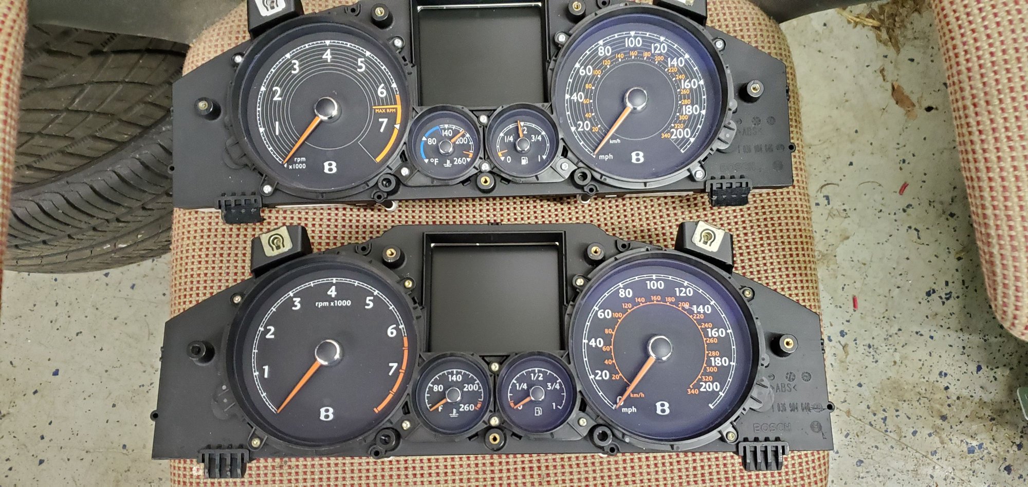

This is the thread I was looking for, I meant to tell you back in June that I went through this back in December 2020 when I had installed the Supersports engine, transmission, ecu's, and the Instrument cluster.
From my understanding, the Instrument cluster itself is the gateway, regardless of 2004 or 2010, I ran into the same issue of no repeater for the turn signals, iirc they would blink once,, or only make the sound once, each time they were turned on, there was something else, I think that the "CRUISE" would not illuminate either with the newer cluster.
So I removed all the needles and swapped the faces and installed the 2006 cluster back in the vehicle, now everything works on the cluster, and I have the Supersports gauges.
Johnny

@Johnny Hotspur GT ,
Oh i see, same trouble.
I discovered that there were no difference in pinout, So i have no idea why it is not working.
Trouble is that mine in 2004 without icon of wheel heater ) and when it is installed i can't call rear camera module using VSDS. When i install 2006 cluster i have errors with red "overheating" error and beeping. So, i'll try to resolve this with 3D0937049M Onboard supply control unit. But still, i don't know. Interesting thing that clusters accourding to part numbers are changeble, so i think question is in adapting it. So it is the way for cluster to "know" in what exactly version it is installed. But it is just fantasies about ) ill check this out sooner or later) I want to make my dream car ))
