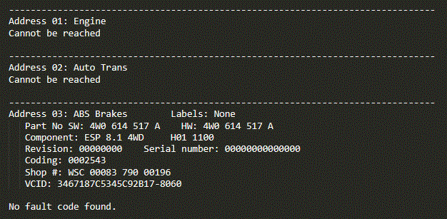

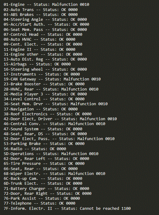

Getting Check Engine Light (CEL) whenever the weather outside is 55F or higher. Car seems to be running just fine. I clear the DTCs via VCDS and the light doesn’t come on as long as it’s nice and cold outside. In warmer weather, the Light does not come on the first time I start the car after clearing DTCs in standby mode. However, when I turn it off and back on again, it comes on right away.
I understand it can be multiple things but just trying to see if anyone knows which component could be effected by the outside ambient temp the most?
As for an exact code from VCDS, whenever there’s a light, I get Engine cannot be Reached in both standby and running mode of the car with the key in ignition. I also ensured that the Force Engine option was not checked as per RossTech.

What happens if you try to scan engine #2 ?

Engine #2 shows STATUS: OK but is also listed as Cannot be Reached. See attached.
You state you are scanning the "car with the key in ignition". Based on your exact wording it sounds like you haven't turned the key. Just having it in the ignition is not enough. Turn the key but don't start the car, then scan.
To clarify, I've tried with key in ignition in both standby (key in ignition with single turn until all electronics turn on)and running mode (key in ignition with full turn to run the car).
