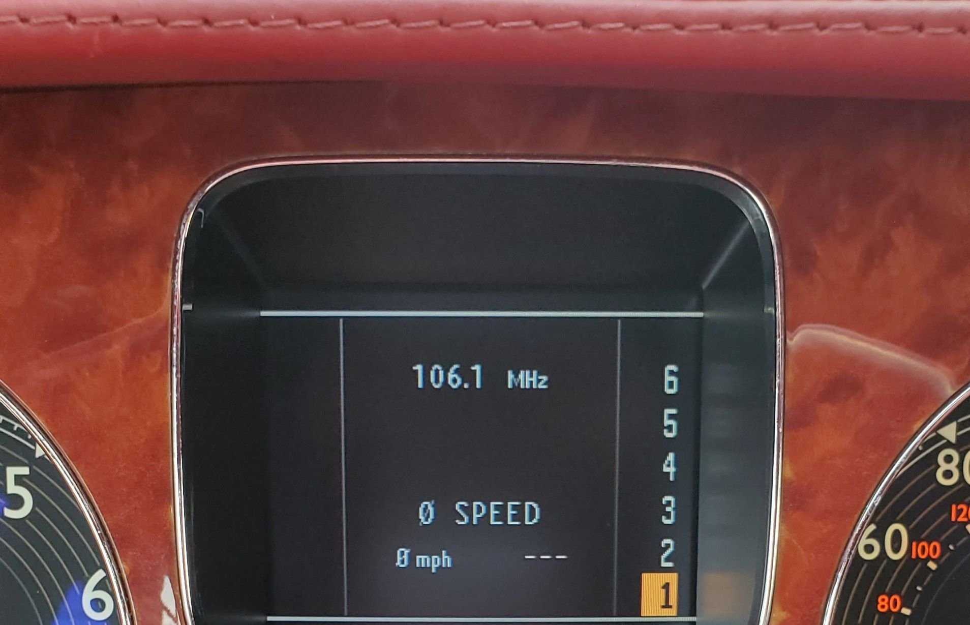

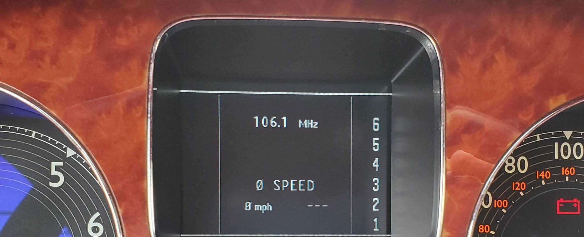

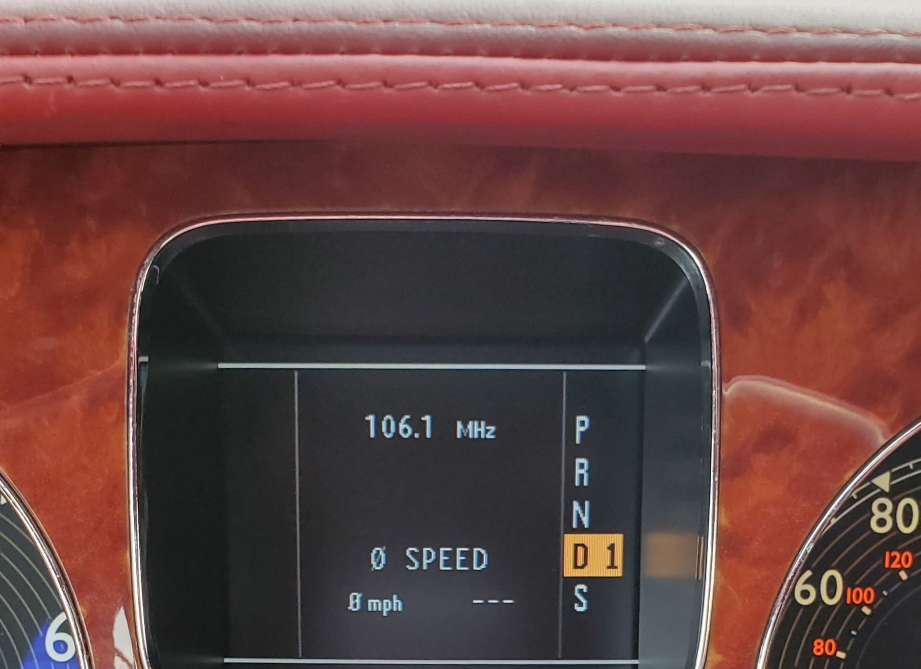

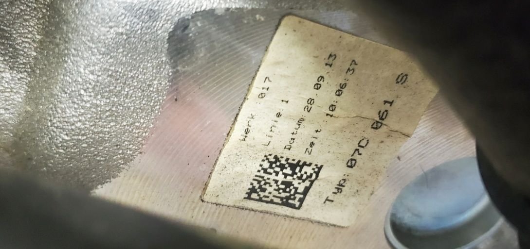

I have not read the article you referenced, but in my research during my GT rebuild I had quite a few phone calls with Bentley headquarters, and the folks at Flying Spur's, as I was searching to verify which year the "CVA" W12 engine actually came from, as it was to be a 2014, as was the matching ZF 8HP-90 eight speed transmission in the package I purchased, I was told by Mark via Craig at Flying Spur's through Clive at Bentley as shown below in the attached picture, the engine could be from a late 2013 GT, as it was available from 2013.5 for the GT, I took this information and called Bentley HQ to double check and to get some clarification as to tying it down to the exact year so I could be correct when selling it, if that came to be, the Bentley representative stated that the 2013 GT had the 6 speed transmission for the first half, with the BWR (IIRC) engine, then the 8 speed up to current date (as we were speaking back in July/August of 2016) was with the CVA engine, so she concluded that I had a 2014 setup by the manufacturer codes of 26/09/13 .
If you want the 8 speed, just be sure to move the shifter over to manual mode to display the numbered gears in the Instrument cluster, like my 6 speed Supersports ZF 6HP-28 transmission does.

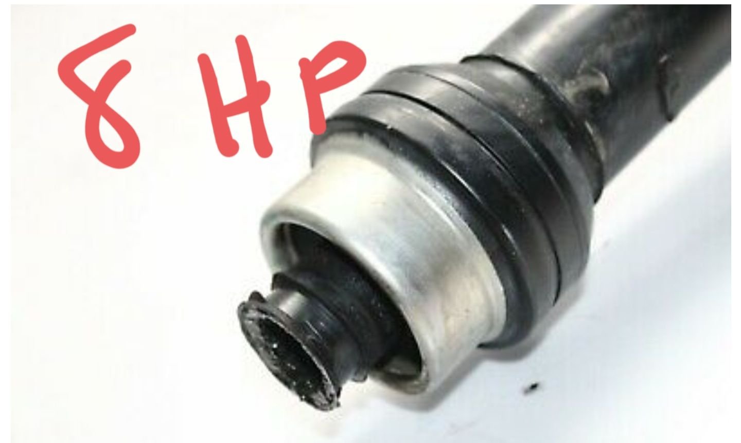

The ZF 8HP-90 is longer than the ZF 6HP-26 by over an inch or so iirc, the 8HP-90 also has a different tail shaft/output shaft connection for the mounting of the driveshaft/prop shaft compared to the 6HP, therefore my 1st Gen driveshaft word not work, I found a Bentley GT driveshaft/prop shaft to fit the 8HP-90 and the seller took the measurements to confirm the length, it was the inch plus shorter, I just don't recall the exact measurement at this moment, but did confirm that it would fit the 1st Gen GT back then.
