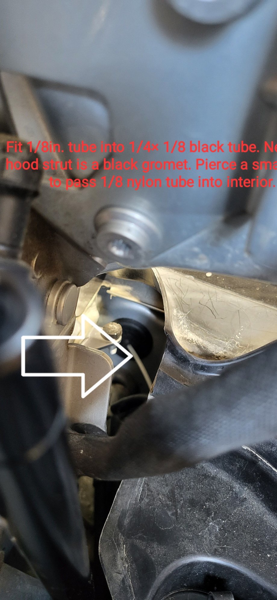

Old Oct 23, 2022 | 05:12 PM
1eapplebaum's Avatar
5 Year Member
Joined: Feb 2018
Posts: 862
Rep Power: 53
1eapplebaum has much to be proud of1eapplebaum has much to be proud of1eapplebaum has much to be proud of1eapplebaum has much to be proud of1eapplebaum has much to be proud of1eapplebaum has much to be proud of1eapplebaum has much to be proud of1eapplebaum has much to be proud of
Originally Posted by Frank ( Sunnyside )
Have you ever found a twin needle boost gauge. Would be great with both banks showing on one gauge.
where did you fit yours any pictures. Im thinking at the bottom of the a pillar dash hight.
Here is a quick pictorial. Not sure [yet] how to isolate each turbo for gauge monitors. Ideas welcomed.
No haven't been able to find a Bi turbo gauge.
