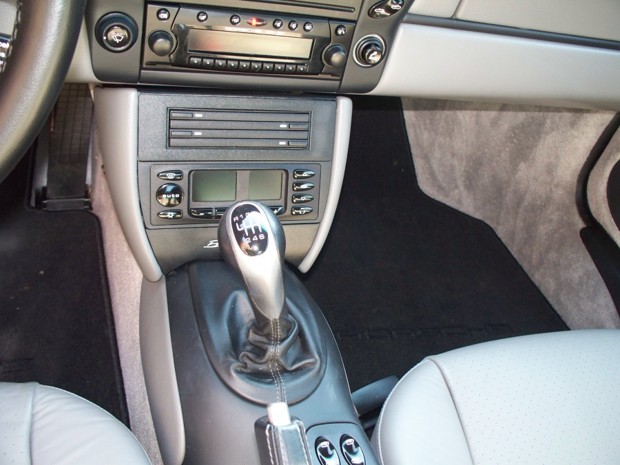

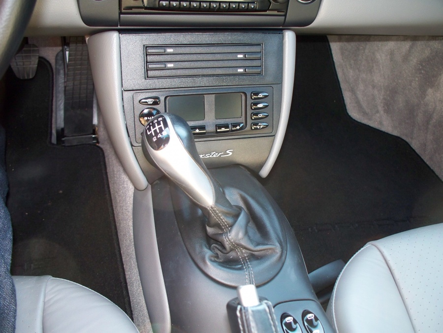

Well....here are the pics I promised: I will start from left to right with, neutral, first, second, third, fourth, then 'R'. You will be able to see how drastically the lever changes in the reverse shot. I decided not to take 5 and 6 only because you get the point.
Enjoy guys! EDIT- Oh yeah...this is a 2001 Boxster 'S'.

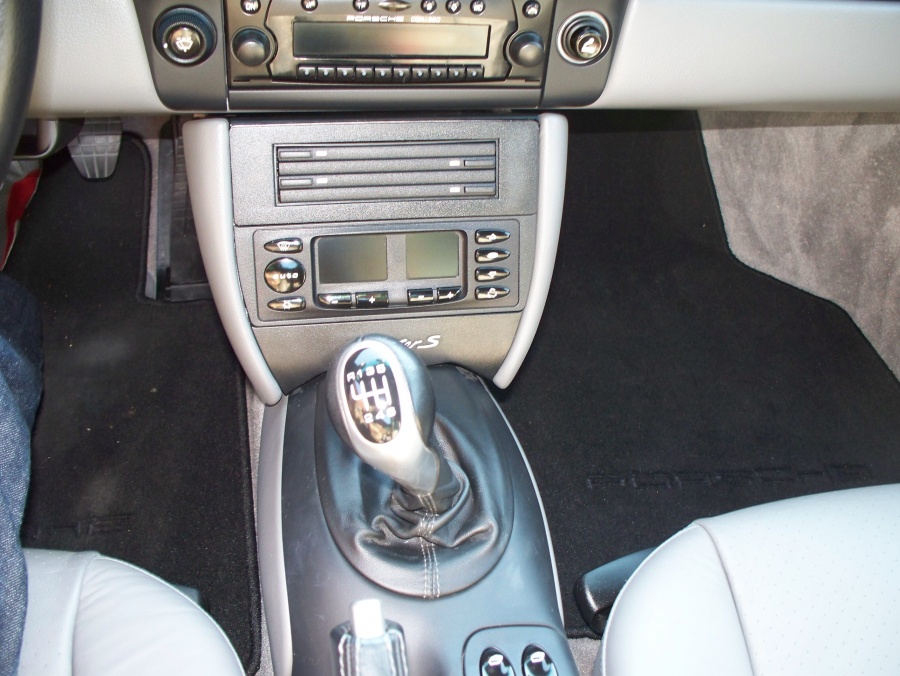

Ooops...ran out of space on the first post...
Here's reverse:

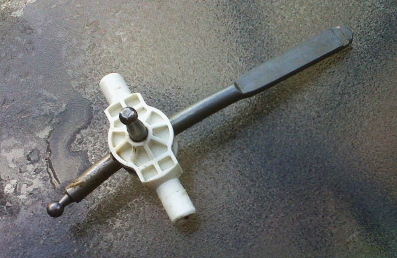

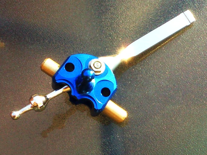

NO MORE PLAY, or SLOP! This is a wonderful upgrade that not only tightens up the slop (stick in a bucket of oatmeal feel), but moves the lever, as you can see in my photos, near and dear to your right leg, and back further to your right hand. Now, my car only has 14k on the ticker...but, the stock lever was definitely sloppy. The stock lever is made outta plastic and shytty steel with plastic 'wobbly' bushings. This new lever is CNC'd aluminum and stainless steel with CNC'd aluminum bushings. ALSO- the bushings have built in adjustment screws for month to month / year to year re-tightening...if needed?
Here is the new lever and a shot of the old turd! I went and dug out of the dump can to snap a shot for you. Sad really...this excuse for a shift lever comes stock in these 'high performance' cars!?
