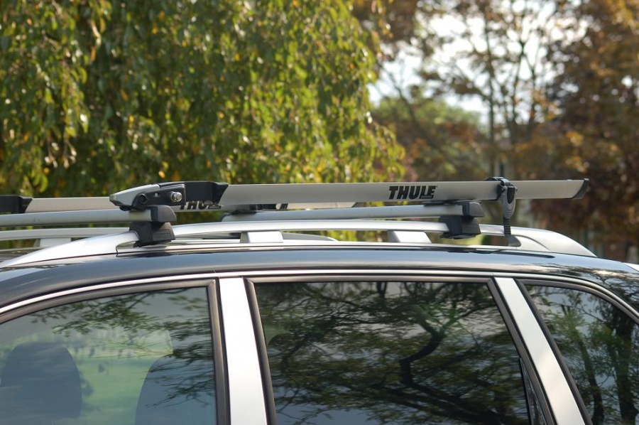

Okay, I've been contemplating on getting the Porsche Tequipment crossbars that attach to my roof rails. Is there any real use to these crossbars?
Will I be able to attach the Yakima bike rack or Thule on top of the bars? Or do I just need to go with Yakima/Thule's crossbars and not the one from Porshce.
I'm not willing to lose the roof rails, so the actual Porsche Transport System is out of the question.
Anyone else have the crossbars?

I am using the factory crossbars on my 05 CTT. I am also using the Thule bike mounts and it is a perfect fit. There is an adapter (XAdapt 9) that converts a thule bike tray system for use in racks with a channel. Your local ski / bike shop should be able to order what you need.
Installation is a 15 minute deal - very very easy.
I am looking forward to installing a thule roof box for the winter - that will be an even easier install.
Cheers!

Thanks so much for your input. This answered all my questions. Even the dealer couldn't answer them for me. I appreciate the pics you posted too. Helps out so much. I'll be ordering the crossbars from my local dealer or through Suncoast.
Your Cayenne looks great with the roof rails, crossbars, and Thule bike rack.
Any wind noise with this setup?

There is a bit of wind noise but just a bit. Any rail system will whistle at mach schnell .
I contemplated a fairing but didn't want the truck to look like a subaru so I opted out of it. Also, there is a bit of distance from the leading edge of the sunroof to the front rail on the rack to I am not sure that a fairing could make the span with out blocking the sunroof.
Cheers!
