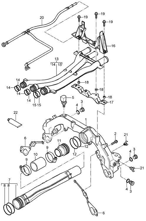

I've seen the replacement pipes and they're pretty long and its a wide apparatus. Seems like it wouldn't all fit under the manifold... its gotta be outside someplace.
Hopefully this diagram will show you how it works:
Looks as if it all sits under the manifold to me. Updated lines shown.
